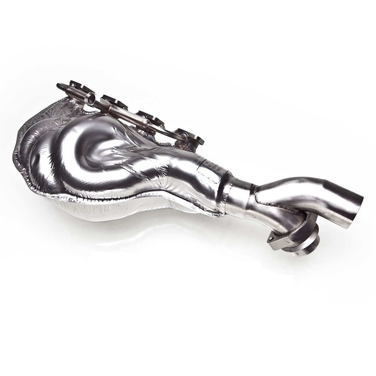

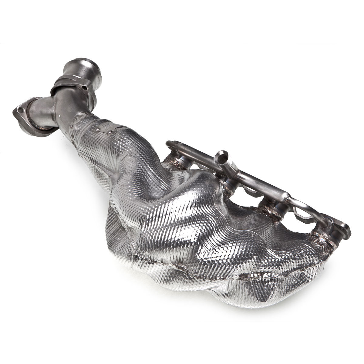

Our Tubi headers for the 430 are covered with OEM quality heat shielding, which is absolutely necessary in that car. If you install headers that are not covered, you're taking some BIG risks for expensive repairs down the road.
I don't have a picture handy, but the heat shielding we use is identical to what we use on our 355 headers, pictured below.
