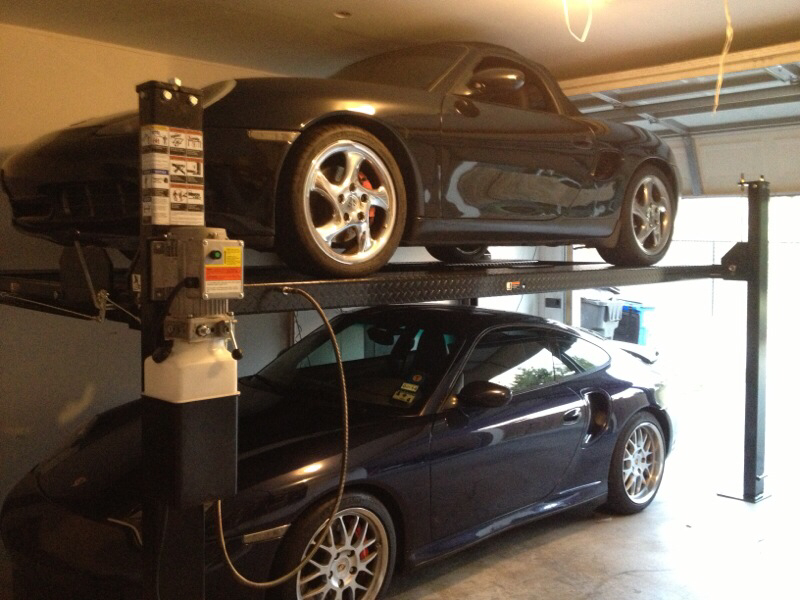

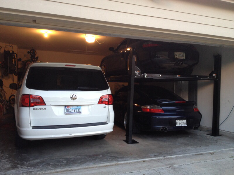

I don't really find myself wishing I had more height much.
This what it looks like

nice. what would be unnerving for me if we switched places is the thought of the driver of the minivan having to miss my lift post each time he/she visited the garage.

Hmm. Never thought about that. My wife does pretty well.
Normally she is way closer to the wall than that pic.
Also I did make sure that the locking positions fell in between the two cars so if there was a malfunction it would catch the top car.
