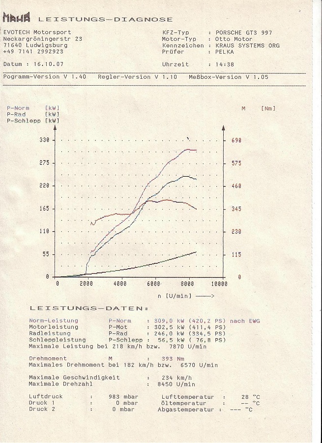

i would like to sse a dyno graphs...because you running FVD and my tuner was working for them in past...

15%DT loss........wow,that is low...in all my dyno,now and in the past,in germany was about 20-22%loss
Old Jul 21, 2008 | 01:51 AM
  #45
greekm3's Avatar
Joined: Jul 2005
Posts: 292
greekm3 is infamous around these parts
that is the dyno from my car when was stock
