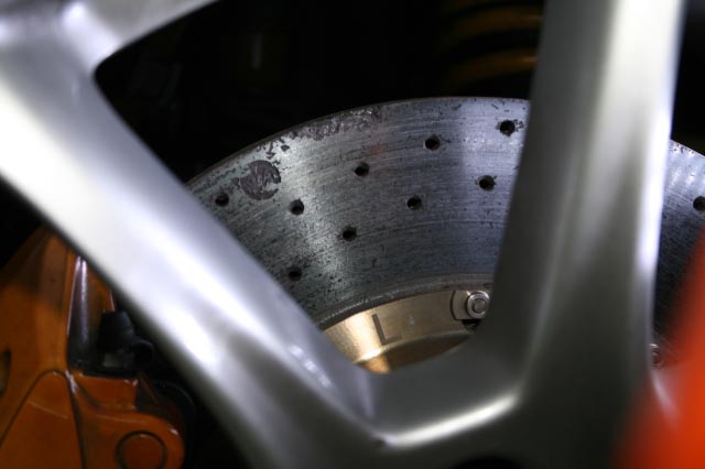

Well, if a picture worth a thousand words...
I obviously know that many owners destroy their PCCBs at the track. I've said this before:
Unlike steel, which fades as it gets to high temps, PCCB maintains its coefficient of friction. Unfortunately at very high temps it destroys itself in the process. The life vs temperature curve is very non-linear, and it's very steep at the top. Get the brakes a little bit hotter and they loose lots of life.
Porsche used pro drivers to extensively test the PCCBs at the track (obviously- this is a liability issue if nothing else) and they did very well. These drivers actually brake less than amateur drivers and go faster- net, they don't get the brakes as hot. They also don't go off sideways into gravel traps and ping the rotors with rocks. Result- what was "good enough" in porsche's testing was overheated and destroyed quickly in amateur hands.
Solution: increase cooling to keep the rotors cooler. Increased venting is the primary difference between gen1 and gen2 rotors. Keeping the rotors even slightly cooler will dramatically increase life (if you don't hit them with rocks).
The life/ performance trade-off will be different for each car and driver, as obviously street/ track usage is different, not all drivers are equally mechanically sympathetic, some race on hotter days, etc. If you don't like them or feel they are too expensive to replace by all means don't get them. If I was running a 3400 lb with driver 997 gt3 and I wasn't made of money I probably wouldn't run them either (though I'd consider extra ducting or weight reduction as alternatives). The same brakes on a car that weigh a full 1000 lbs less, however, are obviously not going to get as hot, won't get to the critical high temps, and as a result will last not a little bit, but many times longer.
That's the theory, anyway, based on some info from some of the factory race guys. I actually don't know how long they will last in practice on my car. For a light car, however, the extra weight from steel brakes is simply not an option- the spung vs unsprung mass ratio gets too poor for the wheels to track the road with larger steel brakes, and cornering traction suffers. So it's either PCCB or the smaller steel brakes I had before, and I can tell you there is no comparison in performance. As I said I'm very happy so far, but that's not to say you should be too... Just keep in mind that you can always sell them to me ;-)
