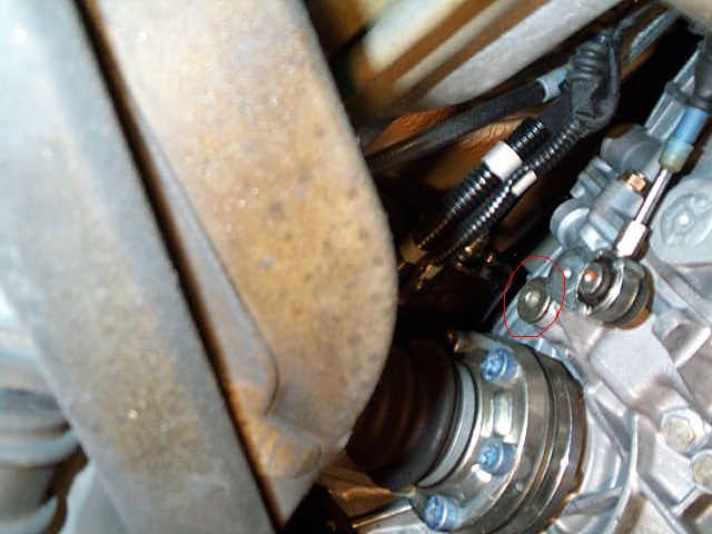

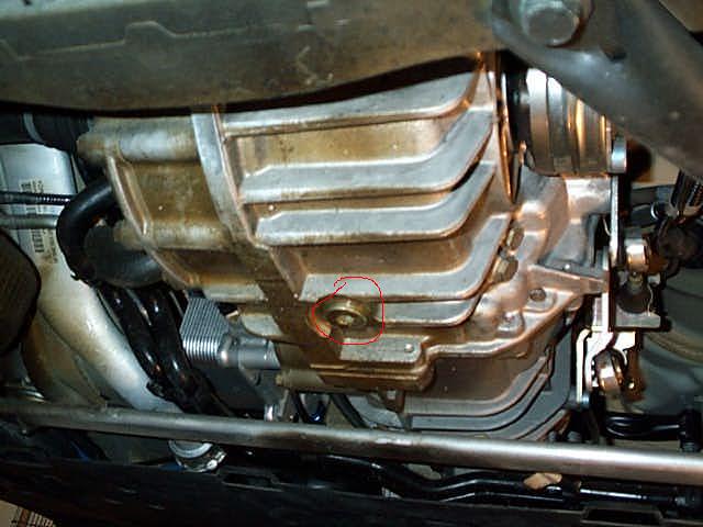

I am trying to change theLSD fluid in my 997-3. the bottom drain bolt is a 10mm hex(first pic). My problem is getting the filler plug off. The fill plug, is on the passenger side of the car, (pic 2) and a 9mm fits almost but will not seat in. 8mm is to small. I am afraid to jump on it and strip it out.
Questions
1) did you find the fill plug on passenger side
2) what did you use to on it
3) was it different than the drain plug

I have changed mine, but mine is a 996-3. My filler plug was between the transmission cooler and trans. I believe you're trying to get off the wrong plug. Maybe someone that has a workshop manual laying around can chime in?
Was yours on the drivers side or passenger side. Did it look like the drain plug, size a little bigger than a quarter? Did it have a recessed Hex?

Ok i screwed up. I was on the wrong side of the case. the fill plug is on the Driver side forward of the drain plug right next to a heat exchanger hardly no room to work. I will take pics and do a DIY shortly.

Yup. Driver side. I used an allen key with a pipe for added leverage. It's a real pain in the ***.
