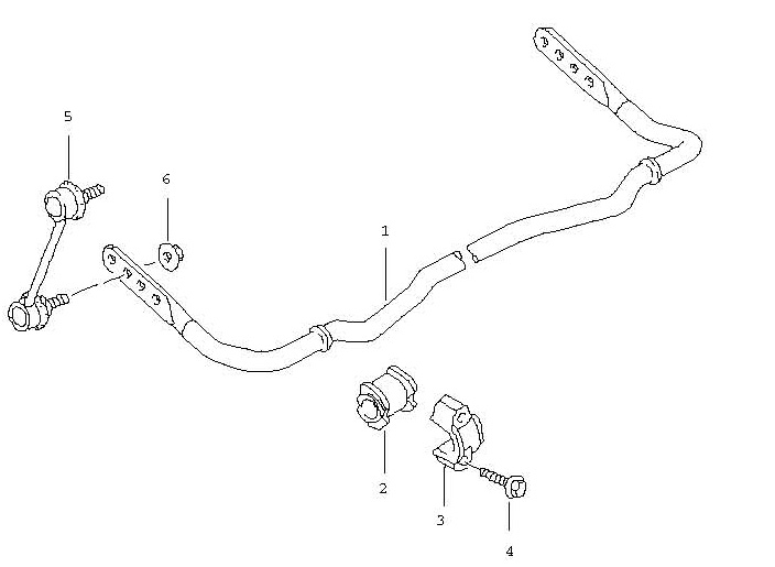

Thumbs up Rear GT2 Sway Bar Settings
I found this for the 997 GT2 Rear Sway Bar, I'm guessing the 996 version would be similar. I will see if I can find more details.

I can't speak to the GT2 but the 997-GT3 was rear full stiff (setting furthest away from the end of the bar). Front one back from full soft. (one hole in from the end of the bar) Full stiff is hole #3 in the diagram above.
Frank,
That is full soft. You're getting it backwards. The longer the bar is locked, the weaker the rigidity is, i.e, it flexes more.
Old Mar 13, 2009 | 09:55 PM
Moving Chicane's Avatar
Posts: 74
From: SoCal.
Moving Chicane is infamous around these partsMoving Chicane is infamous around these parts
Originally Posted by datax
Frank,
I think he's correct; sounds like he was referring to the literal end of the "bar" (metal piece), not the end of the "bar" meaning the relatively straight horizontal piece between the holes. I think...
Frank,
Hole # 3 above in the diagram is full stiff, that is what I was trying to describe. A picture is worth a 1000 words.
