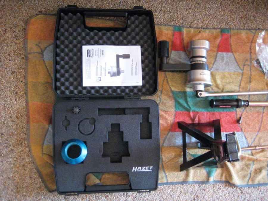

I just did it myself without a lift. It took me a full day. The strainer was clean. It only took 8 quarts even though I let it drain a few hours with the oil filter removed. You need the torque multiplier to take off the wheel and be careful of all torques so you don't break the carbon fiber.
There's about 50 screws with different sizes, so you need to mark where they go.
