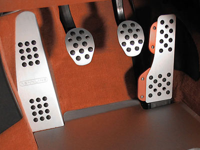

I have an older 911 and the pedal placement is less than ideal for heel to toe.
I ended up adding a 0.75" piece of wood to the accelerator pedal to get it more in line with the brake pedal at threshold braking. This enables me to use my toes / ball of my foot on the brake and my heel to blip the throttle.

Thanks for all of the above posts. Here is a pic of the Rennline pedals, with the throttle extenders attached. I also have the adlustable lifter plate on mine. Still practicing.
