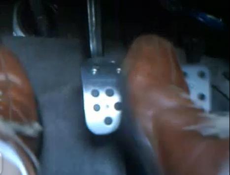

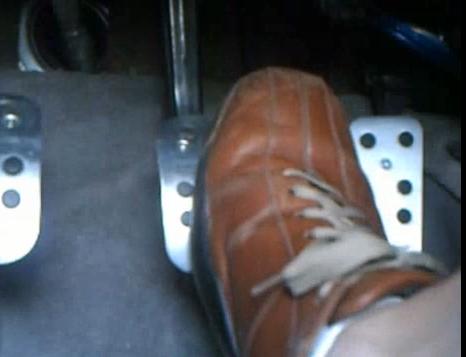

For hee-toe, you should not brake with your whole foot on the brake pedal. Instead, you should be pushing on the pedal with most of your foot, but primarily with the ball of your foot (under your big toe) - and the pinky toe portion of your foot hangs off the brake. Under hard braking, you roll your foot towards the gas pedal, which will blip it.
The key to learning heel-toe is to be able to have an identical brake application every time. You need something repeatable that you can use as a baseline. When I instruct students new to heel-toe, I give them 3 steps to learning it:
1) In your parked (off) car, push your brake pedal down with your foot positioned as described above [pushing on pedal with ball of foot, pinky toe portion not actually on the pedal]. When the brake pedal is (almost) all the way down, your foot should be able to roll onto the gas pedal. It only has to push on the outer edge of the gas pedal. Adjust your foot placement on the brake to give you the most feel for the brake pedal, while still able to reach the gas pedal. REMEMBER the feeling, as this will be your baseline.
2) Everytime you get in the car, (parked/stoplight/etc), practice pushing on the brake with your foot properly placed - and gently roll onto the gas (not a blip, just roll the gas) - WITHOUT REDUCING BRAKE PEDAL PRESSURE! Don't even worry about blipping until you can have 100% correct foot placement on the brake. It won't take long, maybe a day or 2.
3) When driving on the street, under braking, practice blipping the gas and downshifting every time you push on the brake.
In less than a week, you'll have the fundamentals down. In 2 weeks, it will be second nature. [but you have to be diligent in your practicing!] The next step is to learn when to do it on the track - which is lesson #2
Note: For a typical 911 (993, 996, 997), the pedals are already placed in the ideal location. You should not have to add extensions or adjust the pedal location. However, some folks like the extentions as it allows them to put more foot on the brake pedal.
