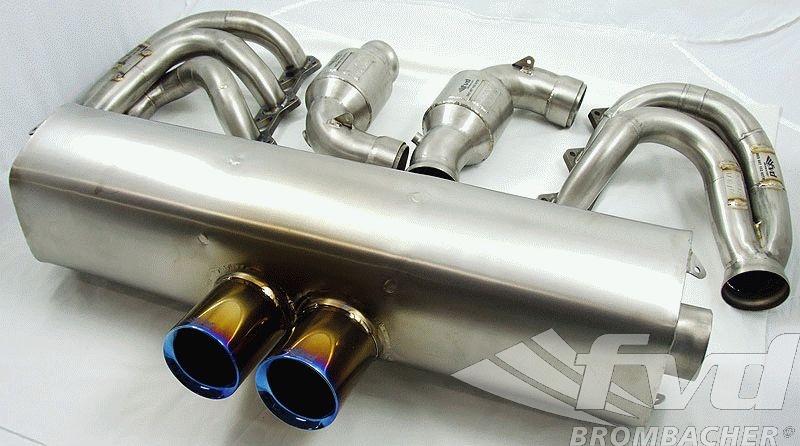

Originally Posted by OmahaGT
Which is the better system:
2. FVD GT3 Race System in titanium
-200 cell cats
-29lbs
-Claim more power
long headers=more power?
They're longer for a good reason. The FVD's are equal-length headers which is beneficial because you get even back-pressure from all cylinders going into the collectors and into the rest of the exhaust. The Akra is not an equal-length header, therefore will give you different back pressures from cylinder to cylinder which does not equate to efficiency and gives lower power gains as opposed to equal-length headers. Given that Akra designed the stock GT2 exhaust, it looks like they just used the same headers that's OEM then added 100 cell cats and a Ti muffler. What the FVD gives up (200 cell vs. 100 cell) to the Akra in cats, it more than makes up for with the equal-length headers is where I suspect the power gains are coming from as well as a better muffler design.
The FVD system has more clamps, which is kind of scary..
I only see 4 clamps...
2 (1 on each side) that go from headers to the cats
2 (1 on each side) that go from the cat to the muffler
The other things that you see are fittings ensuring no leaks between the connections. Both exhausts should have that, just the pic of the FVD exhaust isn't assembled.
I'm guessing you quickly glanced and saw the fittings and thought they were more clamps

OmahaGT, Glad you went with our system, you won't be disappointed. By the way the yellow car that you liked our video on is non other than GT3Ranger.
Well said Ranger! Our systems lack the pretty marketing that many tuner's spend big bucks on. We would rather spend our cash on systems that are powerful, reliable and work on the track and street.
I am working on putting our new manufacturer's GT3 systems on an introductory 15% off offer. They have 10 systems for the 997 GT3 alone!
ScottKelly911 is absolutely right about the headers. In fact we don't tend to offer headers for the naturally aspirated cars unless they are equal length....here is a great example of a an equal length long tube header....
Wait, let me add a pretty picture of our full titanium system so that the we can gain some acceptance...
Pretty doesn't win races, power does

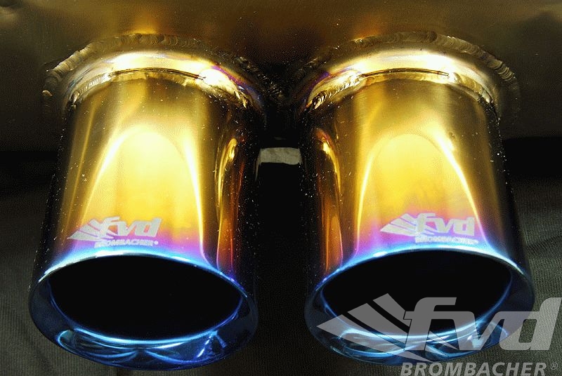

My titanium GT3 race system shipped out today. Looks like FVD got some good shots of it..

wow thats looks far better than the old pics !
love the blued tips !
could you take hi res ones with details of the welds... when it comes to your house?

Congrats Omaha! When you get it mounted up, please be sure to give us your impressions and if possible some sound clips! I love the new blue tips also!
