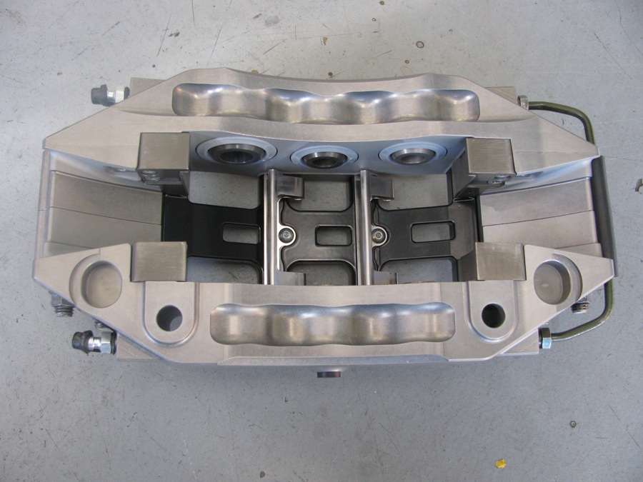

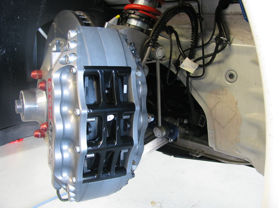

Since the news is broken on the new brake set up for the 2010, wanted to provide some pics comparing the new Stoptech system vs the original PCCB set the car had.
The new Stoptech STR system is based on the race system, and you can see this from the artfully and carefully scolloped calipers. The finish on these is the race finish, built to take the heat and abuse that track days and racing will produce. They have been lightened where possible, but no where in a way that takes away from the strength and rigidity needed for optimum performance. The result is a caliper that is superior in strength, yet lighter than the PCCB caliper....the same approach that the carbon approach desires....lighter weight, but without any drawbacks or trade-offs. The key in any design is the little design elements that separates the regulars or main stream solutions from the specials. The whole approach w Stoptech that makes one of the key differences is that the caliper is specifically designed for the particular application. This is not just another caliper off the shelf, this is a particular caliper designed and tested for the specific match of needs and requirements for the Porsche. Take a special look even at the caliper pistons....I'm sure this will elicit some interesting responses and comments alone.
We've attached some initial pics of the brakes...more specifications, weights and details to follow....

And, if you haven't tried the brakes (either, the new ones we're detailing here, or the factory setup), be ready for a far different feel than the 997.1 system or the 996. The pedal is FIRM...real firm, almost feels like a traditional non-assisted race system. When you want to haul this baby down....it will haul the baby down...it throws out the anchor and plants it....make sure you're not wearing any loosely attached items, even your teeth fillings may come flying out. This is the way brakes ought to be....flat out amazing. You better anchor yourself well in the seat, or you may find the steering wheel a lot closer than you wanted...
More pics of the two systems, and again, w the Stoptech system, we can pick and choose the right combination of pad compounds and match the braking bite to the need or requirement.

Now that is some serious stopping power. I never like the 997.1 PCCB and still don't like it's unpredictable stopping power with stock pads on track. I am sure the stoptech system cost some pretty pennies. I will be changing my PCCB to steel brakes next year - likely GT3 cup steel rotors front and 997.2 GT3 steel rotors in the back if it fits. Aggressive pads all the way around of course

Can you post detailed weight information on the STR kit compared to the 997.2 GT3 PCCB kit? weight from rotors and calipers.
PCCB have proven to be track worthy with the right pads (Pagid P50 green used no more than 50%), but I would like to consider the added weight of the Stoptech STR over the PCCB system.
Rotating and unsprung weight is the most critical weight in any car. I know for a fact that the new 997.2 GT3 cast iron brake system (standard brakes) is 50 lbs heavier than the 997.2 GT3 PCCB system.

I have this information if you would like it but it is back at the office and we are at SEMA right now. Let me know if you are interested in this and how we can help as we again spoke to Stoptech today about the STR and ST kits available and I am happy to relay the information that you are looking for.
Will let you guys know the numbers upon our return home.
