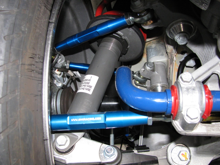

GT3 2010 suspension - next steps
As we have said....we're moving fast on this project, no small steps being taken, but big steps, and very deliberate steps...each piece, each element is being reviewed and selected to achieve optimum results.
So, as we knew from the testing we have done w our customers 996 GT3, 997 GT3, 996 TT and 997 TT, the suspension has too much play and movement when you bring the car to the track....in fact, it can be a near frightening experience when you really get on the brakes hard, like going into braking for Turn 2 at Laguna, and you can feel the car wiggle from side to side....and you're just holding your breadth hoping that the car will stay going in the right direction....but...
So, when we have installed replacement bushings, links, toe links....the car has settled right down, and become much more stable, but also much more refined in responding to inputs, not just under braking, but all thru the turns.
So, the 2010 GT3 needs this same level of refinement, so, off w the OEM, and on w the new, and only the best will do for sure....

Here are more pics of the front side....sways, thrust arm bushings, toe links...time to get rid of all the flex, and add some suspension tuning as well. We're not finished w the suspension yet w these pieces, but this will give us a good baseline to compare the current 997.2 GT3 against what've we known and had for the 997.1 GT3 in terms of setup...then we'll push the envelope a little farther.
You can also see the new Stoptech brakes as part of the package we have been working on.
There is a pic of the various toe links, so you can see the difference in the front vs the rear set, both in terms of design as well as strength and length.

We don't think any one could feel the difference in the flex between stock and aftermarket sway bar end links, but we want this to be stout.

We designed our sway bar kits to be direct bolt on replacement bars for Porsche cars and to work with the existing sway bar end links. In the past and as it (currently) with some other lesser quality sway bars you are forced to use a rod end style drop link.
While this works OK for a race car where noise is not much of a concern it is an issue for Porsche owners who drive there cars on the street and don't want to deal with the maintenance and noise made by these types of drop links.
For example the 996TT and 997TT was a problem for anyone who wanted to upgrade sway bars- You had to purchase curved aftermarket drop links because of the axle issue. Working with Eibach we were able design and build a sway bar that worked with the stock drop links eliminating this problem.
To make a long story short you have the option to leave existing sway bar end links if you want the benefit of our World Challenge sway bar or you can upgrade to a rod end style link if you want to get every ounce of performance from your suspension.
We feel that working with Eibach on the design and utilizing there state of the art manufacturing as well as highest quality steel available our the GMG World Challenge sway bars are the best around. These bars are built to our specification by Eibach and are not standard production bars that have been coated another color and relabeled like some other companies sell.
All sway bars are not the same.. There are only 2-3 companies world wide than can properly bend complex sway bar designs that come on Porsche cars.

To answer why we chose to not upgrade those links yet it is because we are wanting to build a project car that most other members on here or other owners of the 997.2 platform can take advantage of as well. We are not here to build a project that others cannot do, that serves no purpose to us or anyone else on here as it just turns into a "dream project". Everything you see on the car we provide and had a hand in the development process. We have gone to great lengths to ensure that the best have been chosen and partnered with during this project.
Look forward to more questions and happy to help those that are interested.

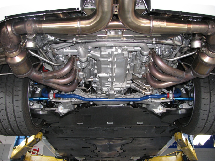

What...you didn't think we were done already did you?
We busy...busy....busy....
And, we're blessed w business booming for us, so hard to find the time in the shop to do the extra mods and tweaks that we want complete before the track time this weekend.
So...we have two more major steps planned before the weekend, and here is the next one. You heard one of the guests who stopped by the shop to see the progress on the car talk about the nice sound.....and as someone said today, this sound is a "Man" sound....there is nothing secret about its intentions. But, the fun is that you can sit and play w the valving and change the sound note from aggressive (loud, but not out of control), to MEAN (we wanted it to sound just like a Cup car at the track....we LOVE the sound of the Cup car...and we think we have it, but Saturday will be the true test).
Here are some pics of the 2010 997.2 GT3 headers, cats and exhaust.
So, pay attention to the OEM bends, from the output pipes of the exhaust manifold to the cat....a pretty sharp bend all at once. So, what's one to do?
Improve it....and replace the cats w high flow 200 cell sport cats, better tubing flow, using as much room as possible to improve the piping and angles....
