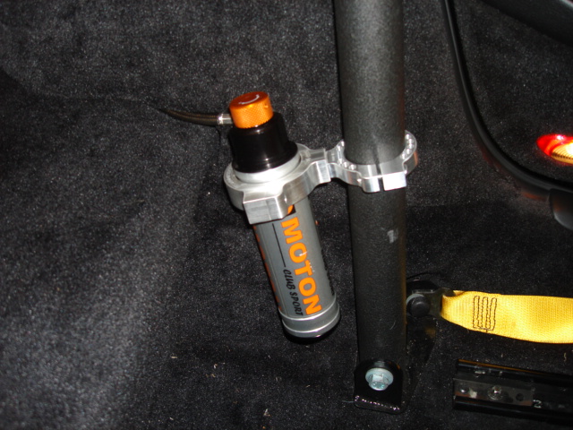

How did Moton/996 GT3 owners route their REAR remote reservoirs into their car? I want to attach them to my roll bar and I can’t seem to find a pre-existing hole to get them into the car.
FYI these have the quick discount so the hole ID does not have to be too large.
Thank you in advance

there are roll bar brackets made for the application (see photo)...you don't make holes for them in the bar

I was specifically referring to routing the lines from the shock to the inside of the car, not mounting the reservoirs. Do you have any pictures of inside your wheel well and how the lines are routed?

I think he is asking how to get the lines from shocks / struts from outside cabin to canister inside cabin.

I had Motons in my 6GT3 and loved them. I had them professionally installed, they drilled small holes into the body to insert line through for external cans. Make sure to use rubber grommets!
