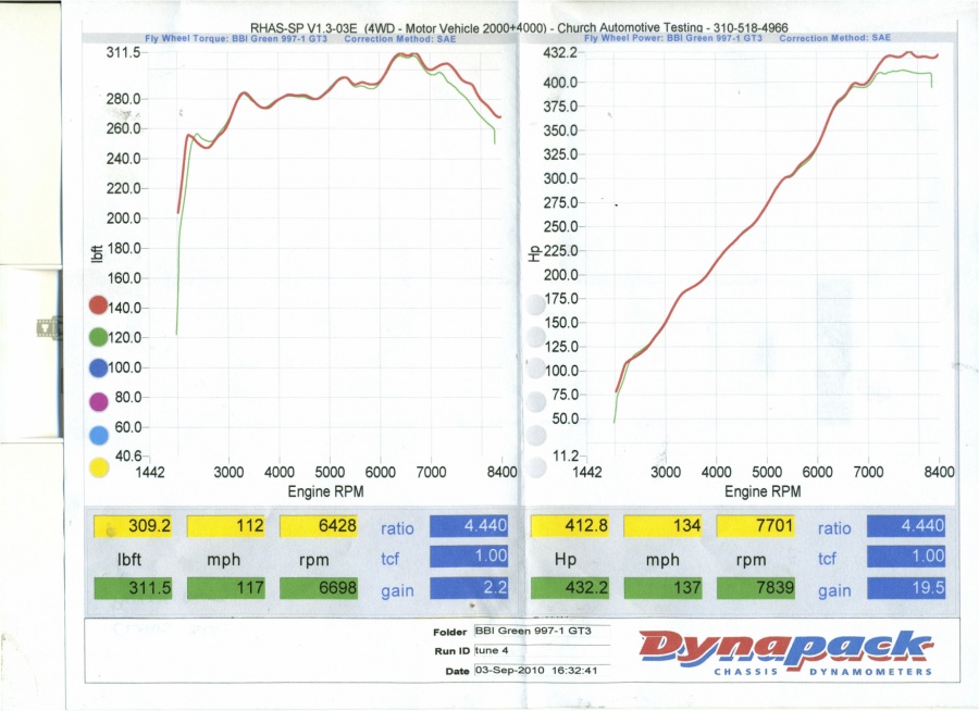

Final Dyno Run
This is all I have. It's a Dyno run of the the final Tune vs. the prior version of same tune before tweaks that day. Obviously, it does not compare to stock. Max HP is 432 (@ 8300 RPM) with max torque of 311 lb/ft (@ 6700 RPM). Dyno was a Dynapak.

Here's...
..an embedded jpeg for those that don't want to download the pdf from my prior post. Thanks.

Dynapack, is that the dyno system attached to the hubs with wheels off?

How does a dynapack read in comparison to a dynojet?

Ranger, as you stated, it bolts directly to the hubs, eliminating variable of wheels/friction/inertia vs. Dynojet/Mustang Dynos.
DD-GT3-RD, I don't think one can compare these #'s to another car's #'s on a different type of dyno. I asked Joey @ BBI and he said on a Dynojet or Mustang, it would be about about 411 or so max HP. Again, that is a guestimate. I can tell you, my car had a Cargraphic Stage-6 (a very well respected system) with a custom REVO tune and with the BBI system and tune, it's noticeably faster, particularly above 6K rpm. I am very happy with it. It's less than 30lbs, sounds insane and gives the car power in-line with a .2 RS. What else could I have asked for?

I agree...was trying to get some ideas thou. Like what #s does a stock one dyno on a dynapack? Then we could get an idea of what kind of gain you have made. Doesnt need to be exact...was looking for a ball park figure.
And you couldnt have asked for anything else! 30lbs exhaust, more power, and an amazing sound!
Thank you!
Here's a comp (scroll down to bottom):
http://sharkwerks.com/porsche/techni...at-laguna.html
Max HP was 362.9hp vs. mine at 432.2 hp. That's a 19% improvement vs. stock w/SWs center-bypass. Max Torque was 273.4 vs. mine with 311.5. That's a 14% improvement. I am not sure what sort of gain the SW bypass gives over stock. If it does add power, the differences from pure 100% stock would be slightly greater vs. the comparison above.

362.9hp vs. 432.2 hp. WOWZA! thats 70WHP!!!!!!! i dont know if they have different settings, or use correction factors, even with different weather...no question you must have gained!!

Now I'm kind of dumb and uneducated but the math suggest a 70 rwhp gain with the system.
That is staggerring and industry earth shaking.
I would say lets put the dyno #'s aside and would be nice to see straight runs against a stock 997.2 GT3 and a .2 RS. A good real world evaluation of pull and grunt. Except for knowing how to shift it wouldn't require much driving skills to kkep it basic.
If this is factual (and I hope it is) they wouldn't be able to make these systems fast enough.
Congrats again. btw I wished and would like to see dyno'ing done with the decklid closed. Maybe it's just me.

obviously no exhaust will give 70whp...2 diff dynos...but must of gained for sure
