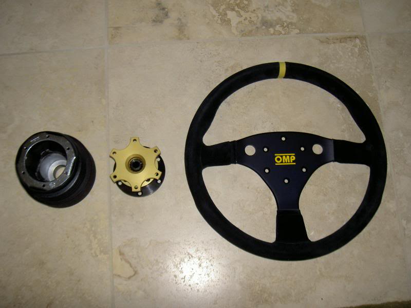

There is one thing that bother me about tracking my RS is all the explosives in the cabin. These nicely packaged TNT originally design for crash safety with love from Stuttgart serve no purpose when I am 6 points strapped in with HANS device. They have become potential finger and wrist breaker in a case of off on the track and has no more entertainment value then popping birthday party balloons. I decided to remove them all and replace factory steering wheel with OMP quick release for easy of getting in and out of the car with factory roll cage. Here is a detail DIY on installing OMP steering wheel and airbags removal for those of you deranged enough to carry out this mod
There are many options as far as hub, quick release and after market steering wheel goes. You will need to chose the type of setup depends on if you want to retain horn function, size of steering wheel, distance to driver etc. I decided to use the MOMO hub with lifeline quick release and OMP superturismo steering wheel which is the one used in 997 Cup car. The lifeline quick release is suppose to last longer than ball bearing type of quick release with less play. It comes in yellow (FIA approved) or black. Here are the sites I bought my parts from for price reference:
MOMO hub: $72 http://www.paragon-products.com/MOMO...hubadapter.htm
lifeline quick release: $249 http://splparts.com/store/product-info.php?pid99.html
OMP superturismo steering wheel: $289 http://www.vividracing.com/catalog/s...l-p-64625.html
Here is a picture of what the individual parts look like

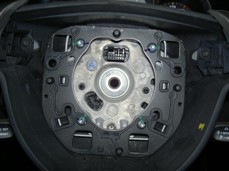

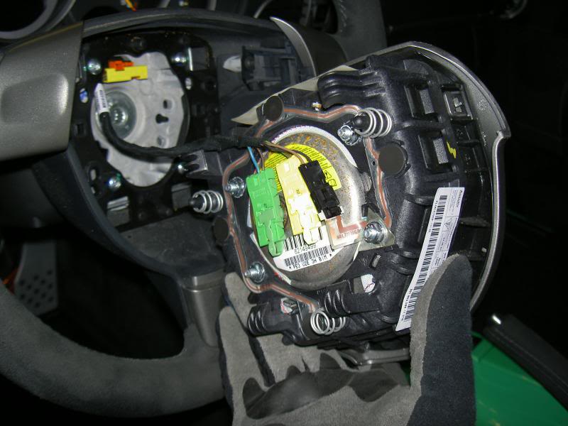

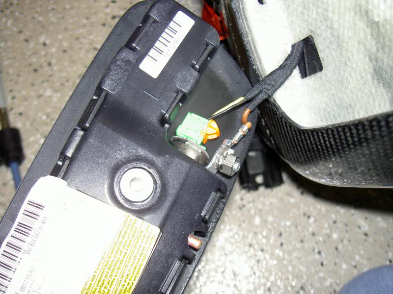

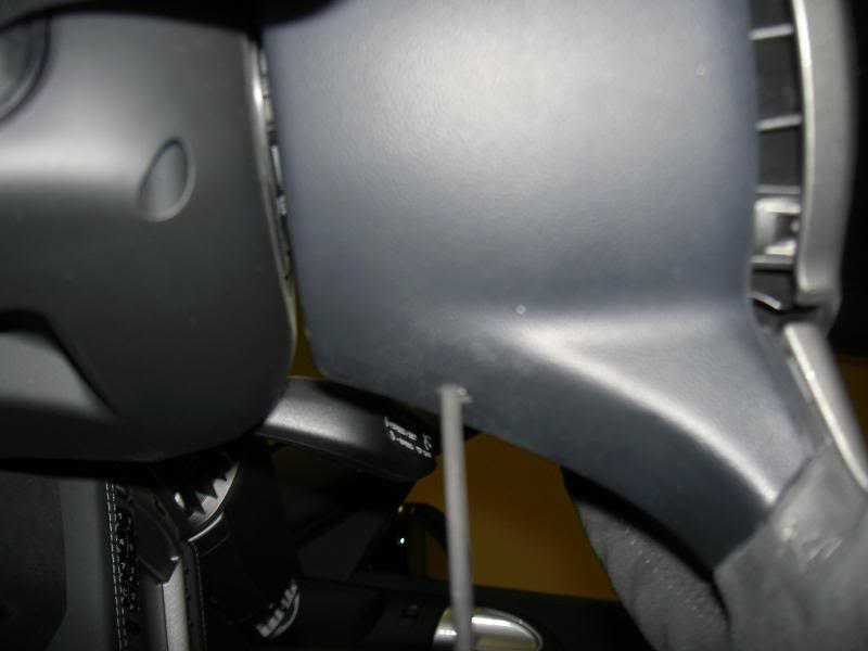

Pop the steering wheel airbag unit out by inserting a long thin Allen wrench at the lower opening behind the steering wheel and carefully push hard upward. This will release the springs that hold the airbag unit.
Pull on the top of the airbag unit toward you then gently pop the whole thing out. Disconnect the airbag yellow connector at the steering wheel side and remove the airbag unit

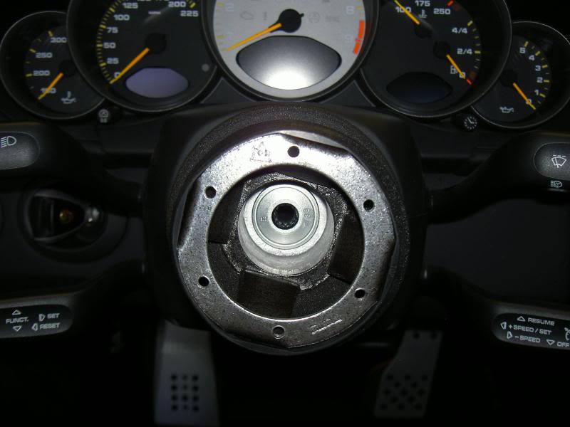

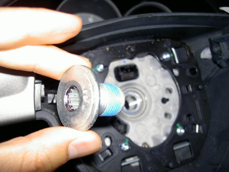

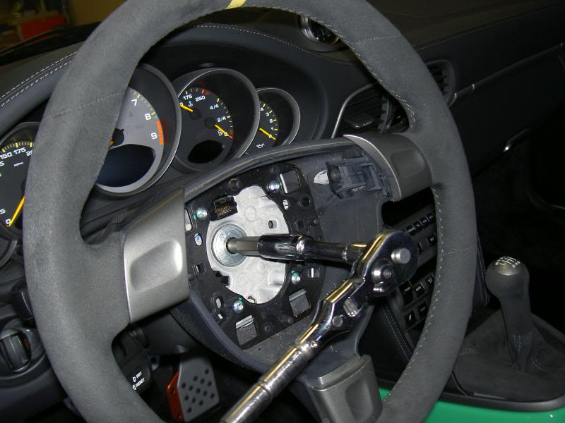

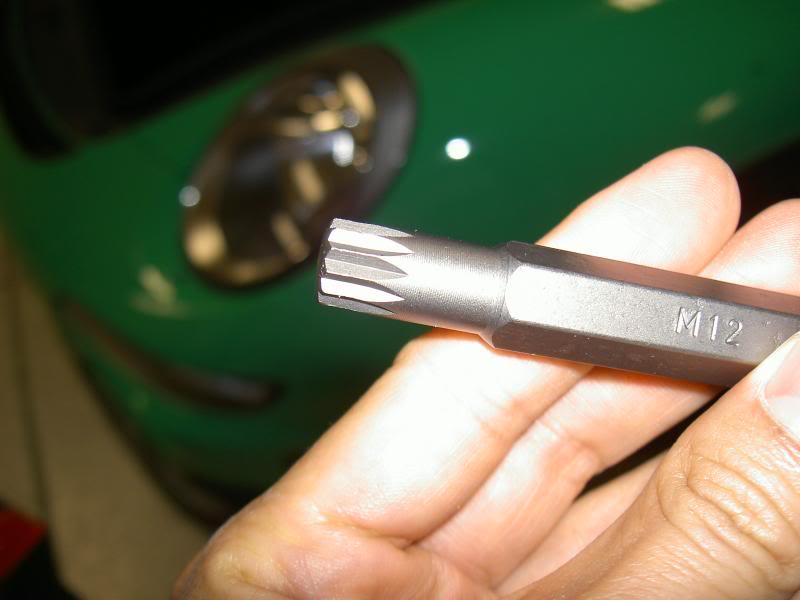

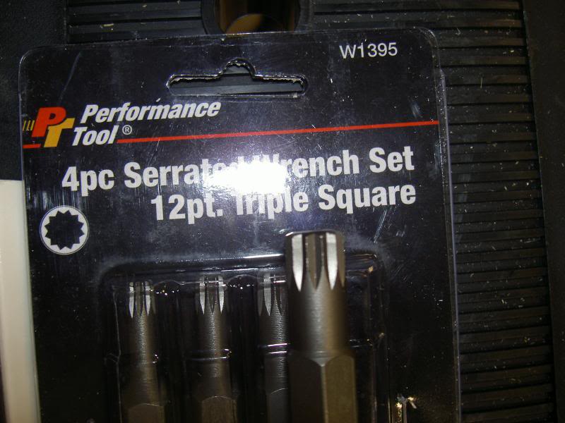

Now you will find a 12 points M12 bolt securing the steering wheel. You will wonder why on earth did Porsche use a M12, 12 point bolts!? I had to buy the special wrench from Napa auto store
Remove the M12, 12 points bolt and out comes the steering wheel.

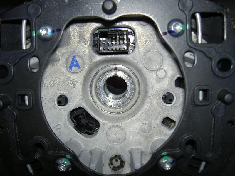

It's a good idea to mark the steering wheel and column just in case you need to put the factory steering wheel back

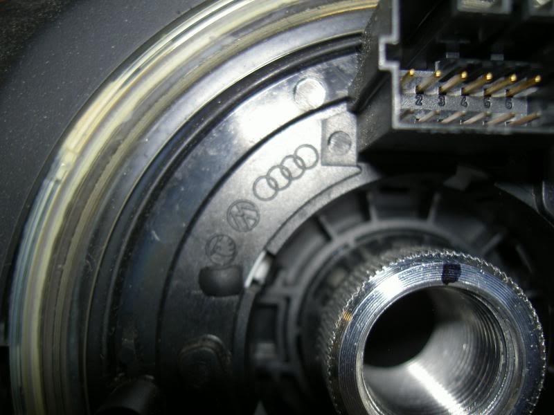

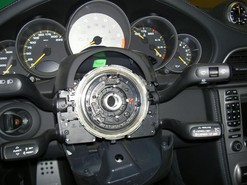

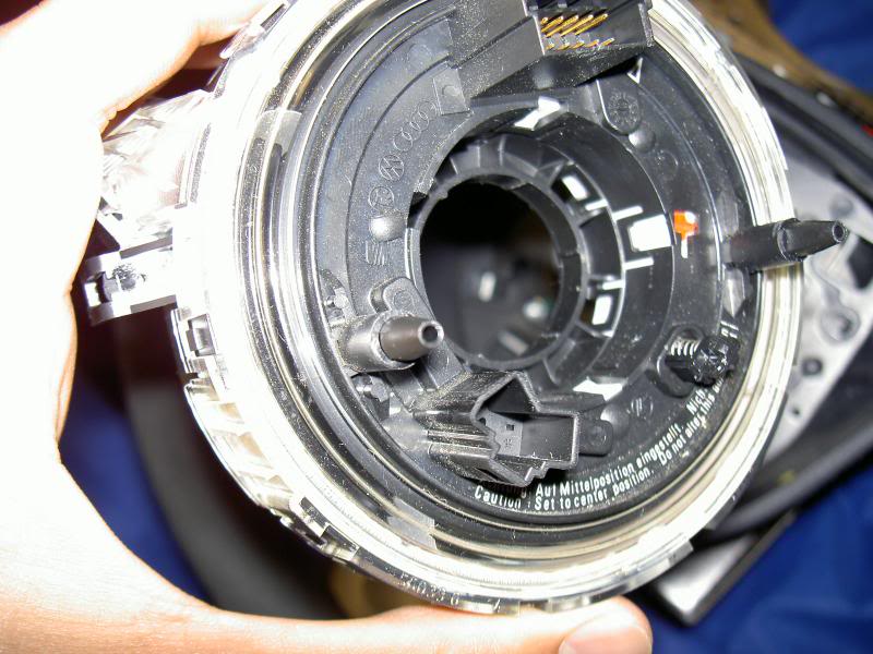

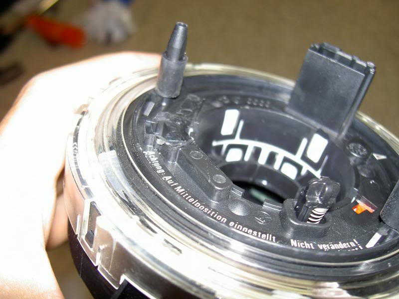

Now you will see the electrical connector unit which rotate with steering wheel and act as part of the traction control sensor. You need to remove this unit for some trimming to fit the MOMO hub. This may not be necessary if you use other hub
Audi parts ... hummm

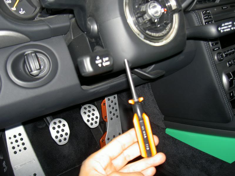

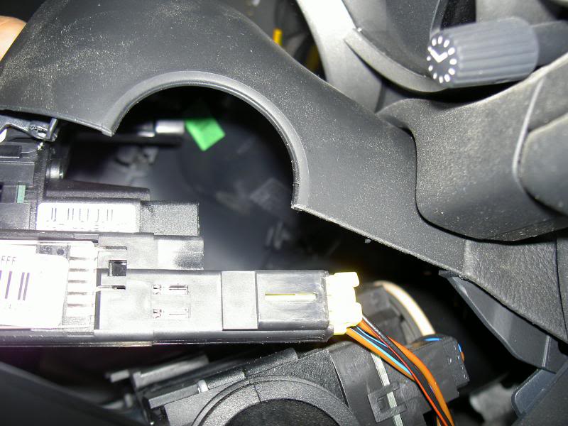

Remove the steering wheel column cover by removing the two T10 securing screws
Unclip the legs that secure the electrical sensor unit and unclip the wire plug on the right hand side

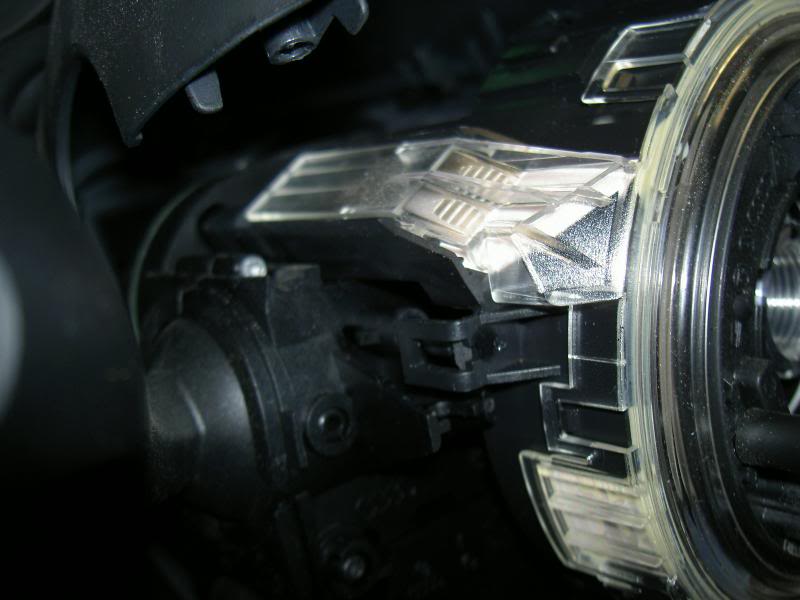

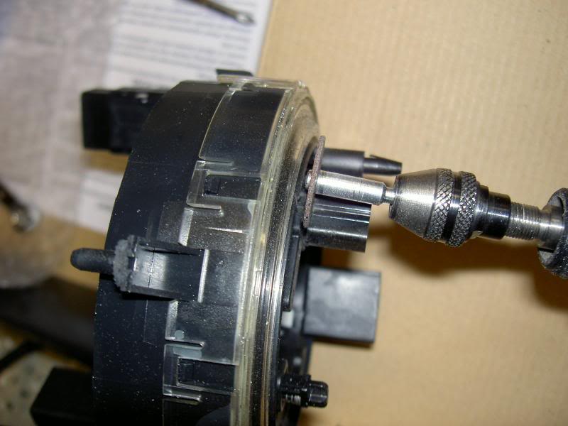

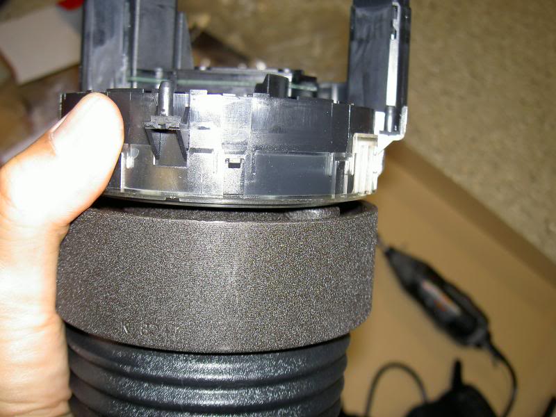

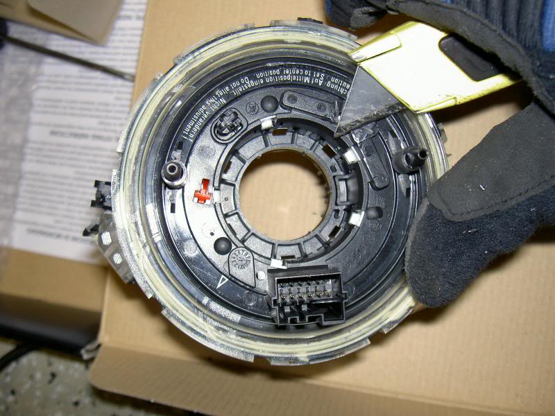

The electoral sensor unit has a dummy plastic plug receiver at 7 O;clock which blocks the MOMO hub.

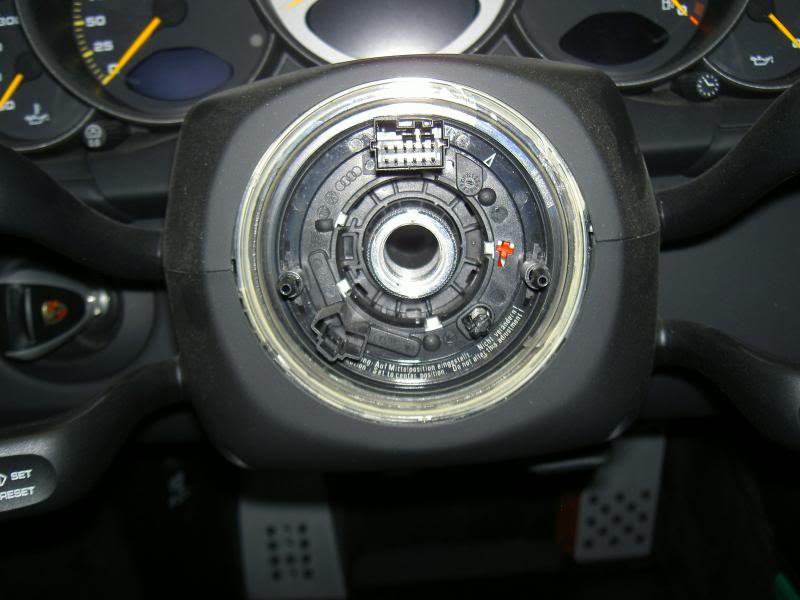

Carefully dremel off the dummy plug receiver and trim off any excess plastic that may get in the way. Take great care not to damage the sensor unit

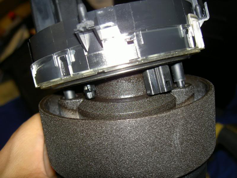

Now it's ready to mate with the MOMO hub

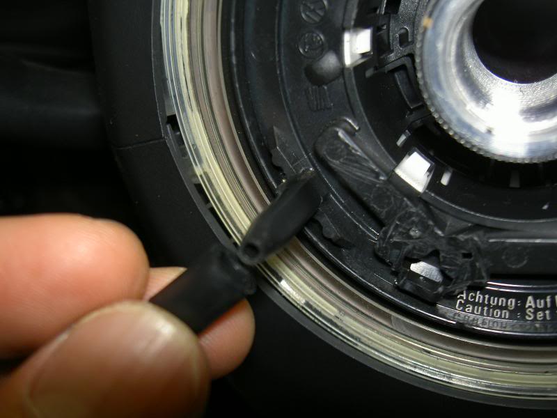

You need to remove the soft plastic cover on the two plastic taps on each end of the electrical sensor to fit inside of the MOMO hub.
It will sit flat on the MOMO hub

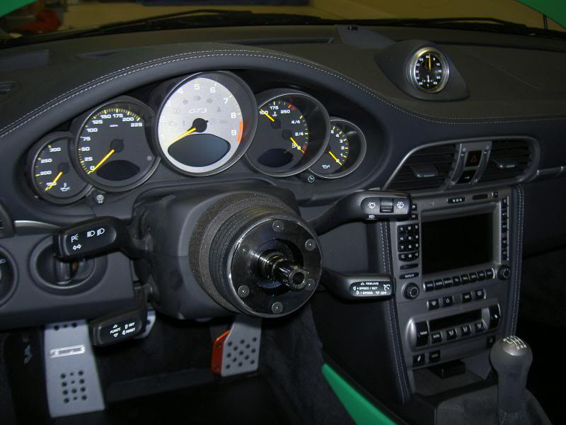

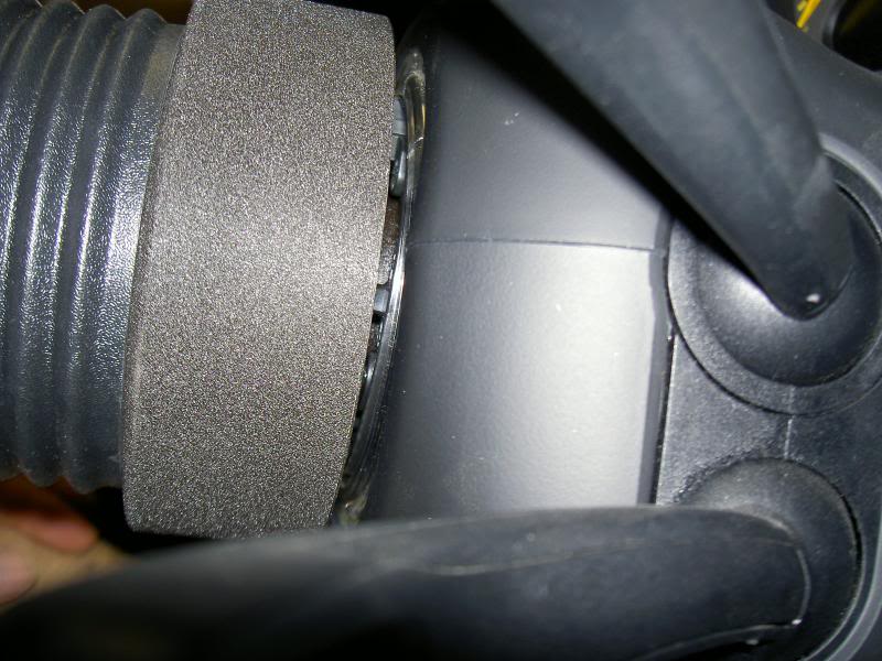

Put the electrical sensor back and this is what the MOMO hub look like from the side installed
Install the M12, 12 point bolt. Porsche calls for replacement of the bolt with each use and torque the bolt to 50 Nm or 37 ftlb. Before tightening the bolt, it's a good idea to test install everything to make sure the yellow strip is centered.

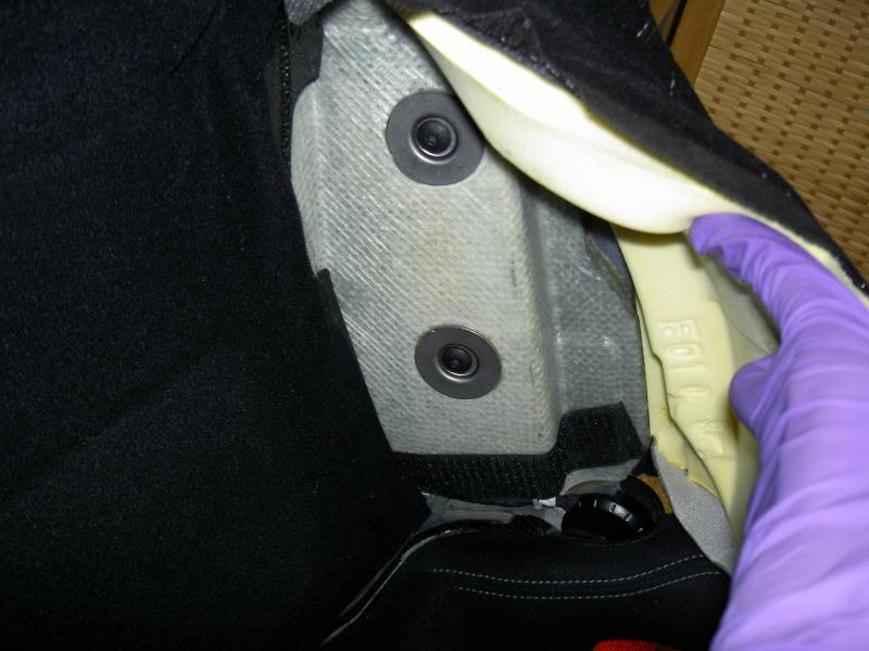

OK, there are two more air bags to remove. One is the side impact airbag on the side of my GT2 seat. To remove this, all you need to do is remove the back cushion and pull up on the left side cloth to expose the securing bolts
Remove the bolts and gently pull out the side impact airbag and disconnect the electrical plugs

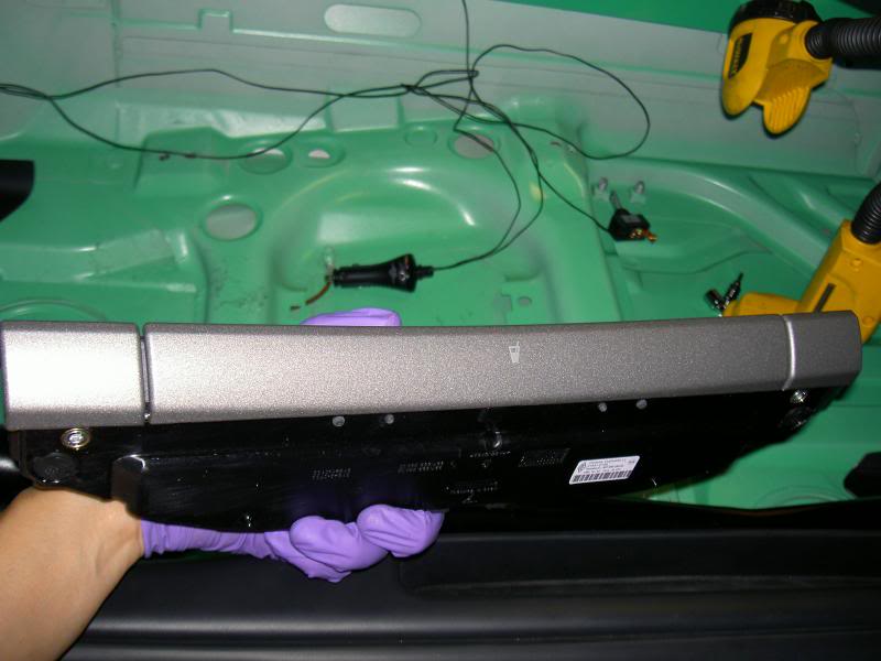

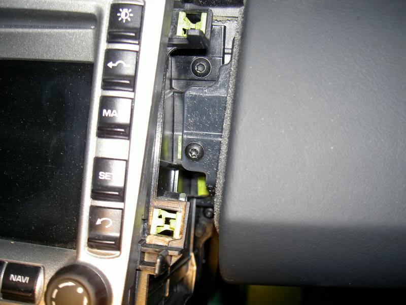

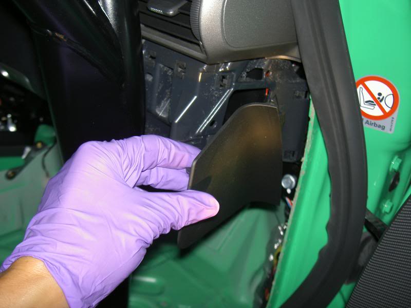

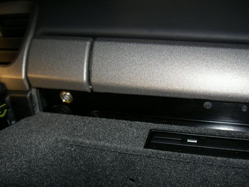

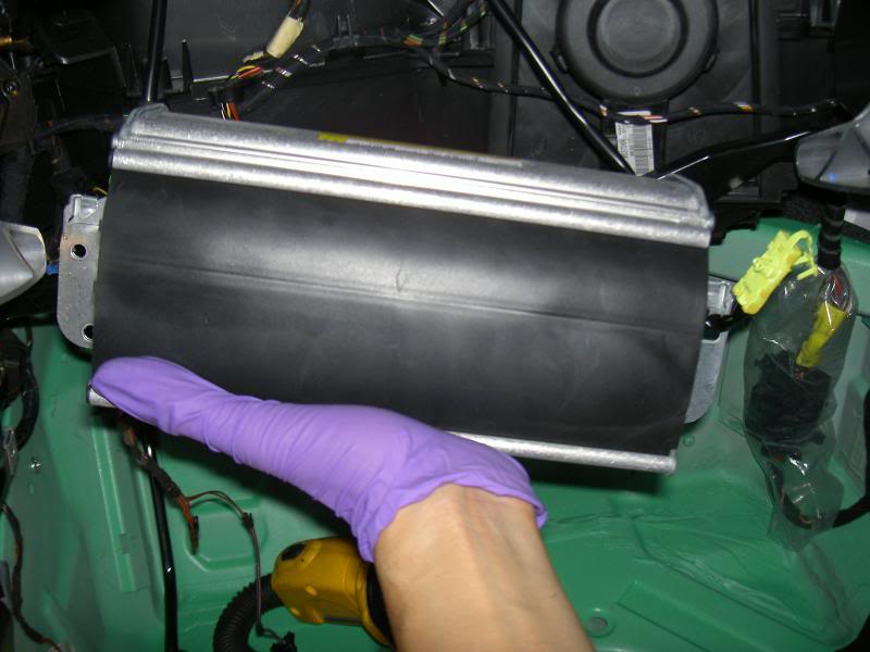

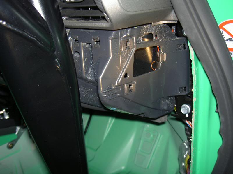

Now the passenger airbag is a bit tricky. You need to remove the whole glove compartment to get access. First, remove radio/Nav side trim and the glove compartment right side trim to expose the glove compartment securing screws
Remove the cup holder by removing the two securing bolts under the assembly
Remove all the screws that secure the glove compartment and gently drop it down and unclip the wire connector on the back

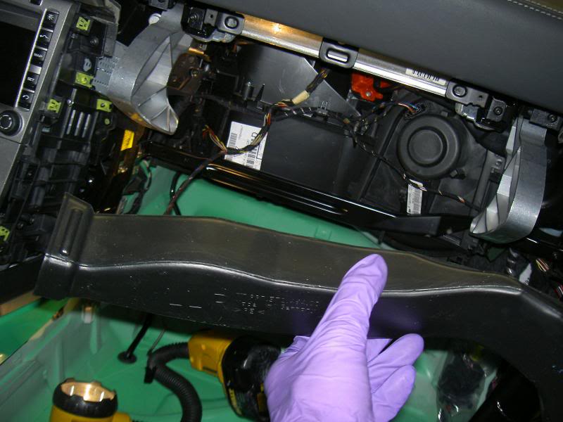

Remove the plastic air duct under the passenger airbag

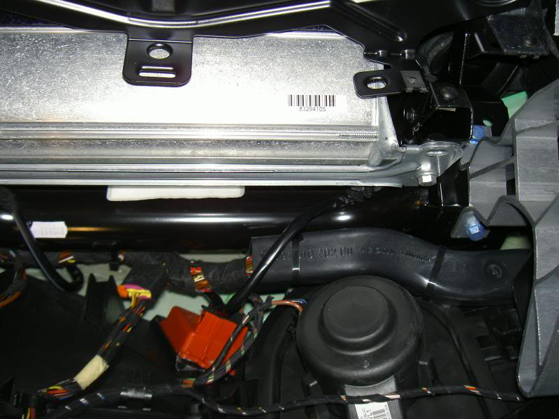

Here is what the passenger airbag look like tug above the glove compartment. Remove the 4 bolts that secure the airbag unit and remove the airbag assembly
Remove the electrical plugs on the airbag ... this thing is REALLY heavy -7 lbs!

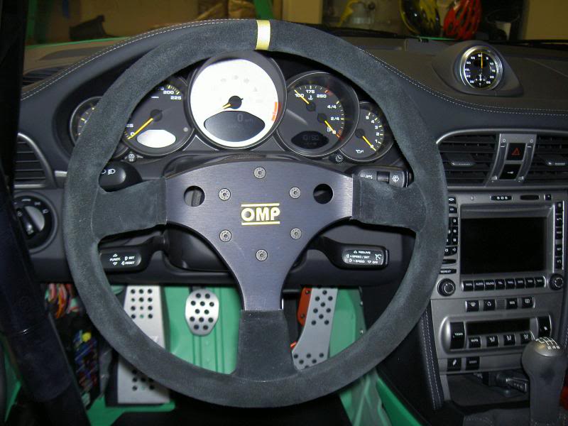

OK, now we are officially explosive free!! ... except for the flat 6 that sits behind and the high octane fuel in the tank
We have shave off total of 16 lbs of explosive weights (3 lbs each for steering wheel and side airbags and 7 lbs for passenger airbag)

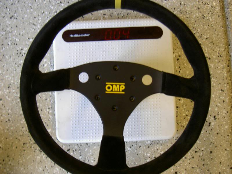

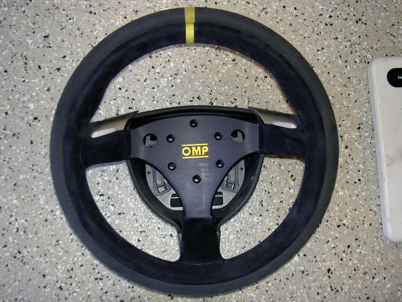

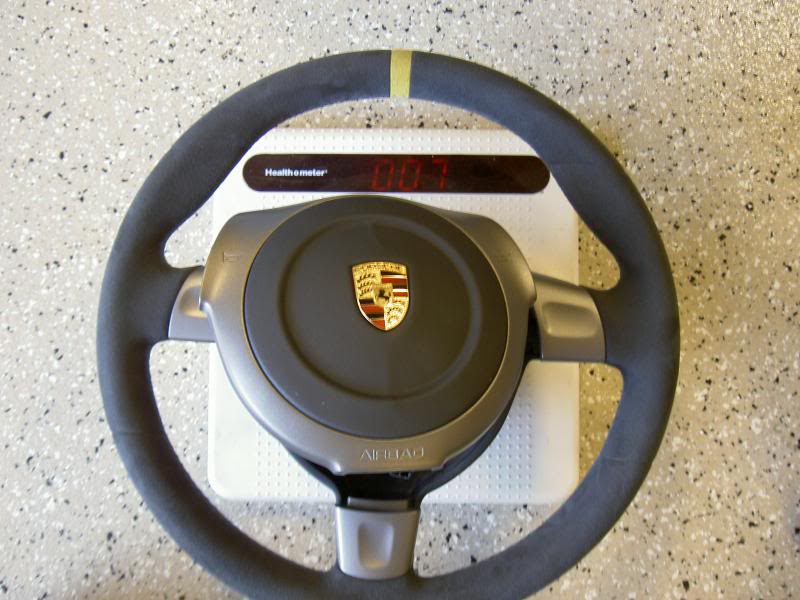

Let's take a look at the factory vs OMP/lifeline/MOMO setup and compare weight and physical location on the steering column.
Factory steering wheel setup - 7 lbs
OMP/lifeline/MOMO setup - 4 lbs. 3 lbs of weight saving

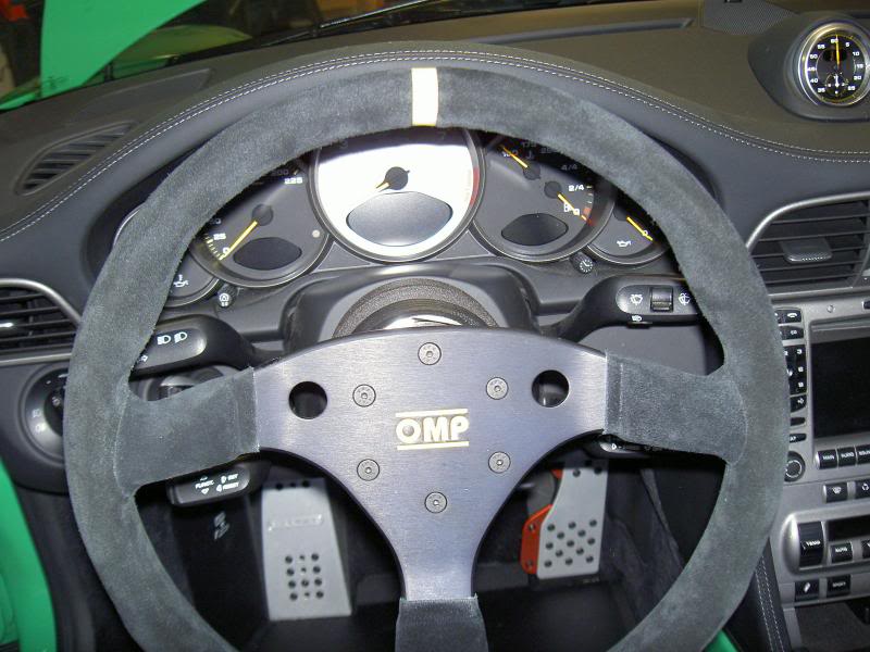

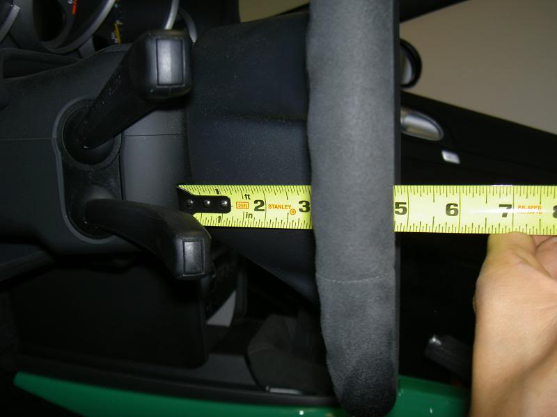

OMP wheel is smaller in diameter - unfortunately the top part of the steering wheel block my view of the RPM gauge. If you don't have a long torso or if your seat sits lower then you will have full view of the RPM gauge

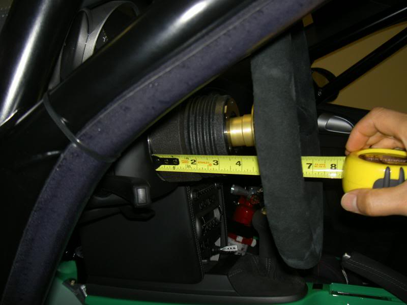

Factory steering wheel setup stick out about 4 3/4 inches compare with OMP/lifeline/MOMO setup which stick out about 6 1/2 inches - 1 3/4 inches longer than factory. I have to push the steering column all the way in and up for a comfortable position and reach further back to use the turn signal etc. 996 GT3 don't have the luxury to adjust their steering column.

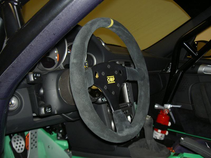

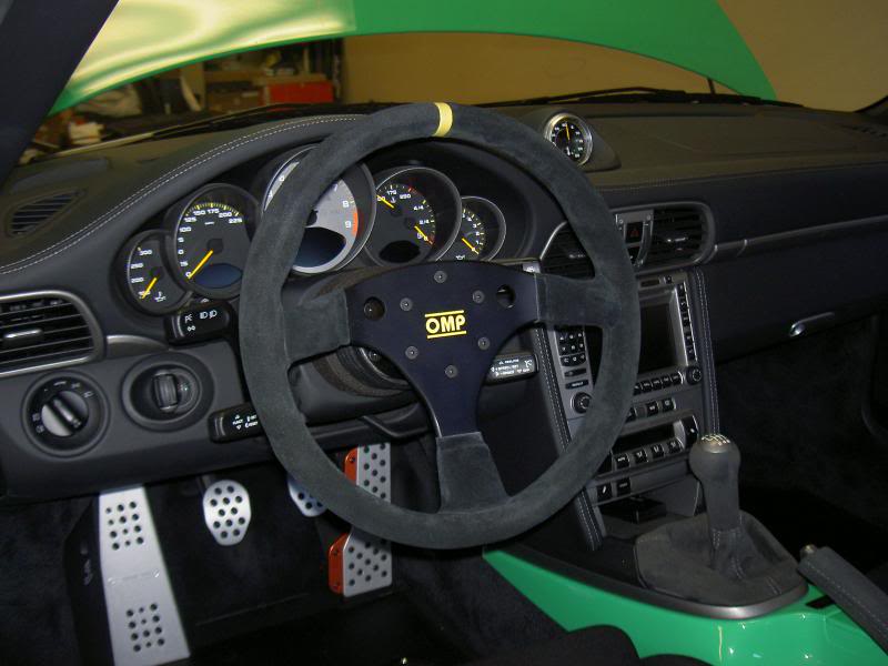

Overall, I am very happy with this setup. The only draw back is that the steering wheel partially block the RPM gauge. I remove GT2 seat cushion on the track for lower seating position which help ameliorate this situation. Explosive free, light weight and solid feel of the OMP superturismo alcantara steering provide an all business cabin for track enjoyment

nice right up as usual. I removed my steering wheel and put in a momo as well.
what are you going to do about the horn? I realized this as some a-hole almost drove into my lane on the way to the track.
that sucks that there is no direct bolt on hub for the steering wheel. you would think there is one - since the cup cars use a similar set up.
do you have any full pictures of your interior - now that the carpet is gone?
