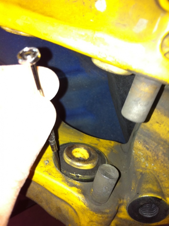

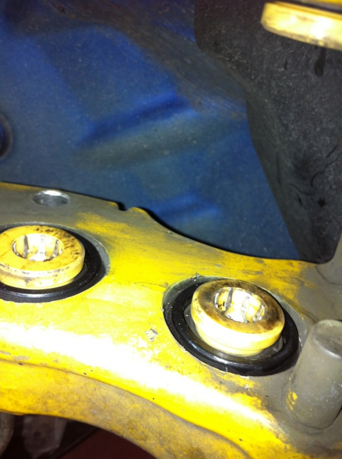

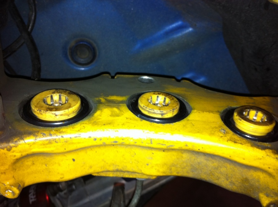

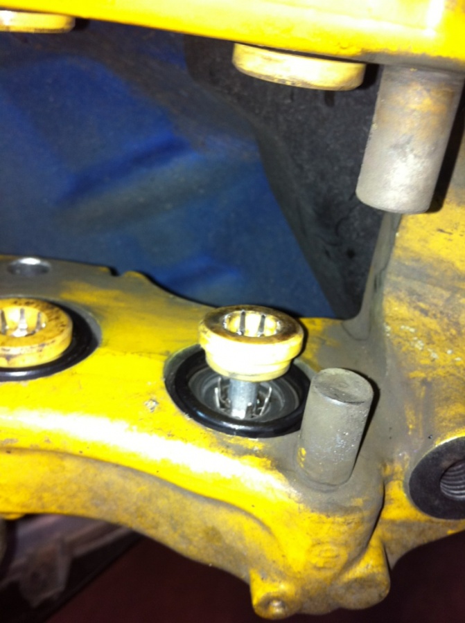

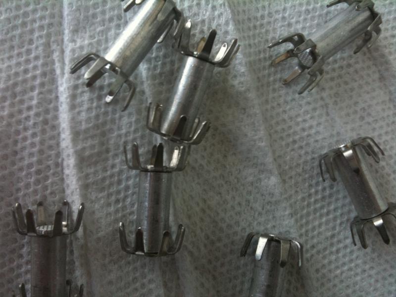

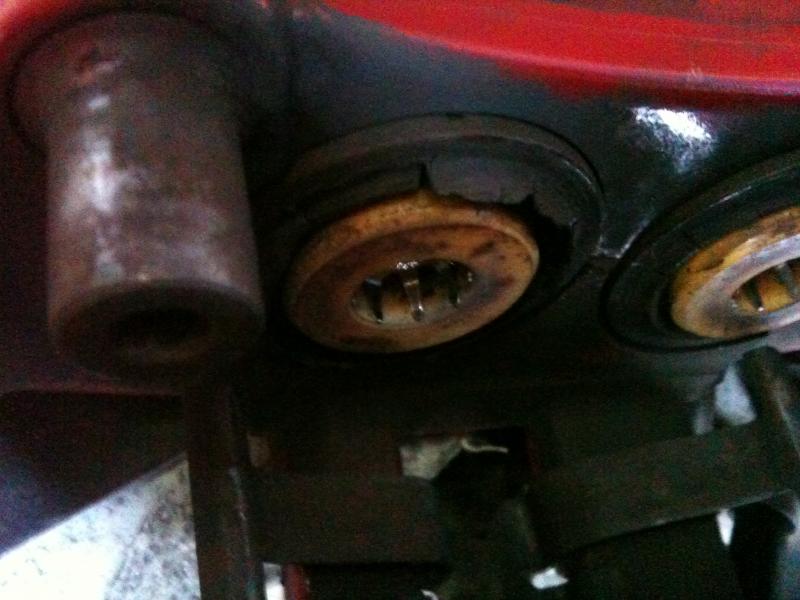

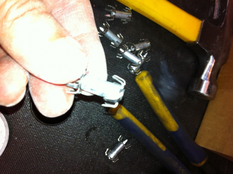

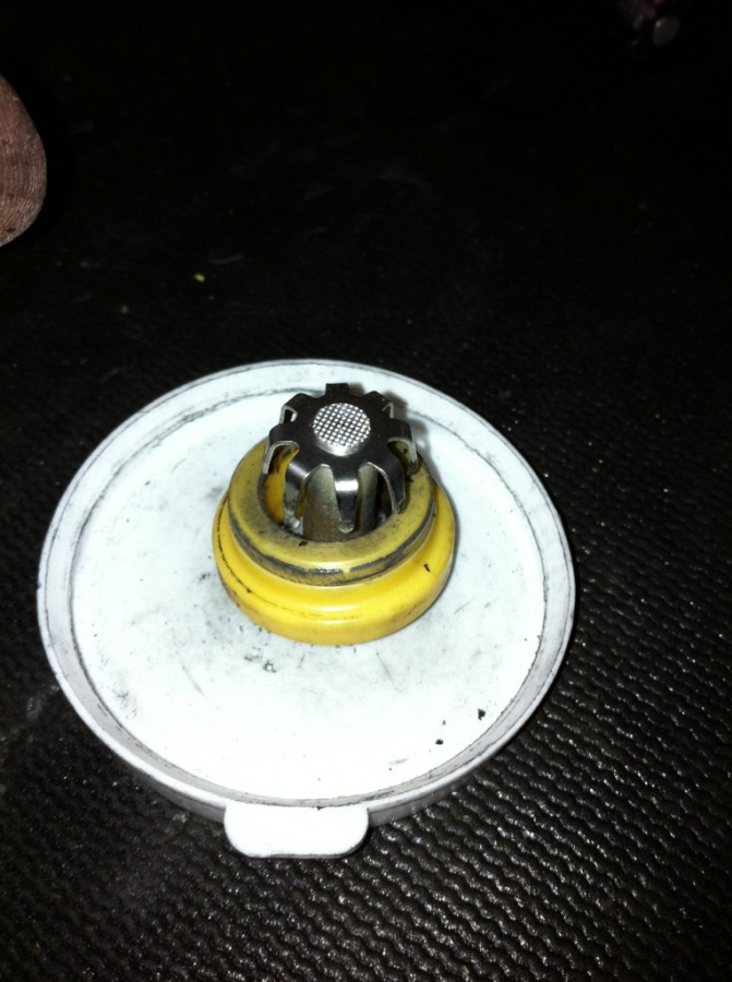

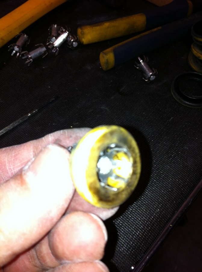

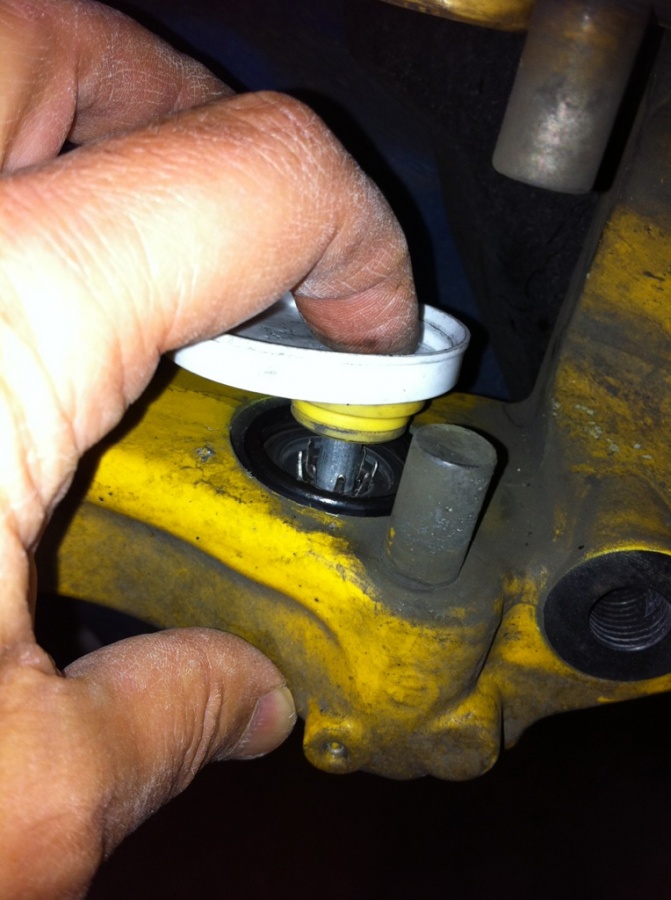

Here are pictures of the solution. The inserts are available through www.orbitracing.com, phone 5618402109. They are called brake puc holders, they don't list a part number on my invoice.
Name:  brake puck DIY 2.jpg
Name:  brake puck DIY 3.jpg
Name:  brake puck DIY 4.jpg
Name:  brake puck DIY 5.jpg
Name:  brake puck DIY 6.jpg

Name:  brake puck DIY 7.jpg
Name:  brake puck DIY 8.jpg
Name:  brake puck DIY 9.jpg
Name:  brake puck DIY.jpg

Here's a bigger picture of the holders.
