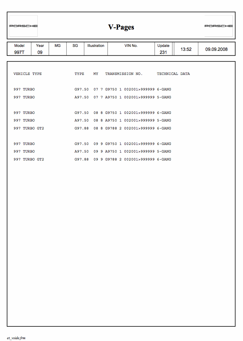

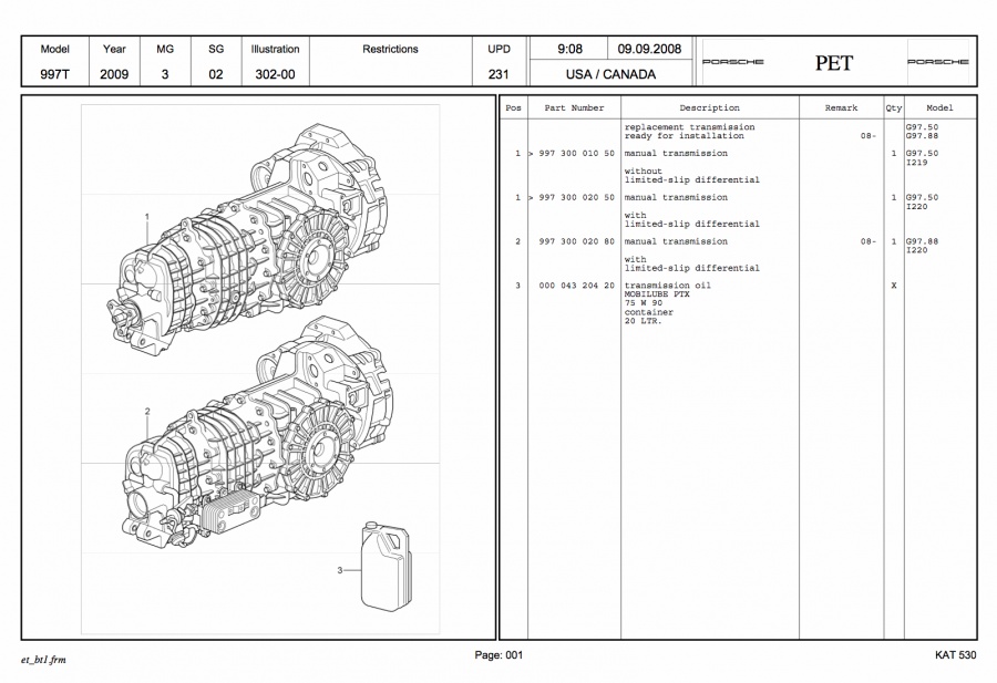

Old Dec 15, 2010 | 02:53 PM
bbywu's Avatar
Posts: 10,774
From: OR Room 5
Rep Power: 1007
Excluding the clutch/flywheel assembly, PET lists two different transmission designations for the 997TT and GT2.
Gear ratios are definitely different...3.15; 1.89; 1.40; 1.09; 0.89; 0.73; 3.44
