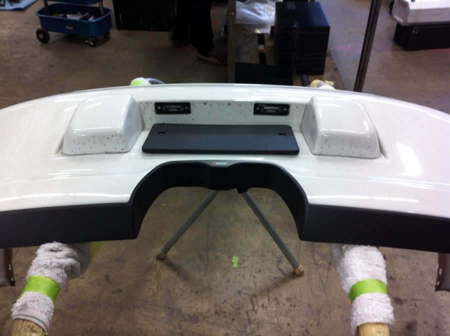

I don’t do a whole lot of mods to my cars so I’m almost done. Akrapovic and Evoms are on the way and I will probably self-install to save some $$$ (it’s be good to get out from behind a computer and break out my tools for a change!).
The mirrors will get painted and then I’ll post some pictures. Aside from looking funny at the moment, I left the ISO setting in my camera set too high so they’re all too grainy so I’m not going to even bother to post what I have (I had taken some pictures of the pumpkin last week w/o flash so needed the high ISO setting).

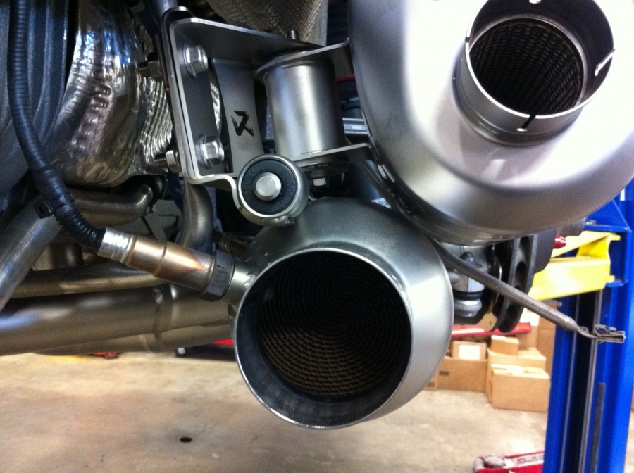

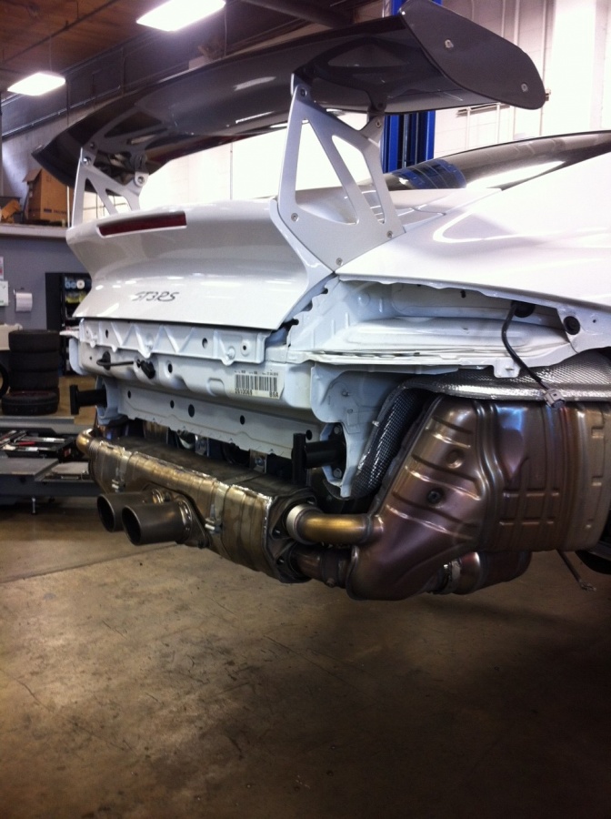

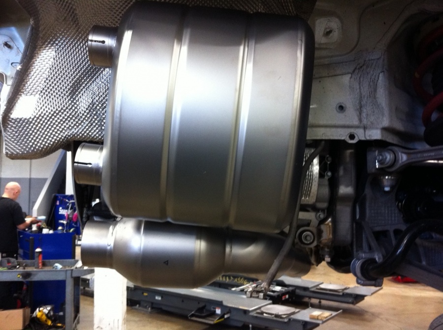

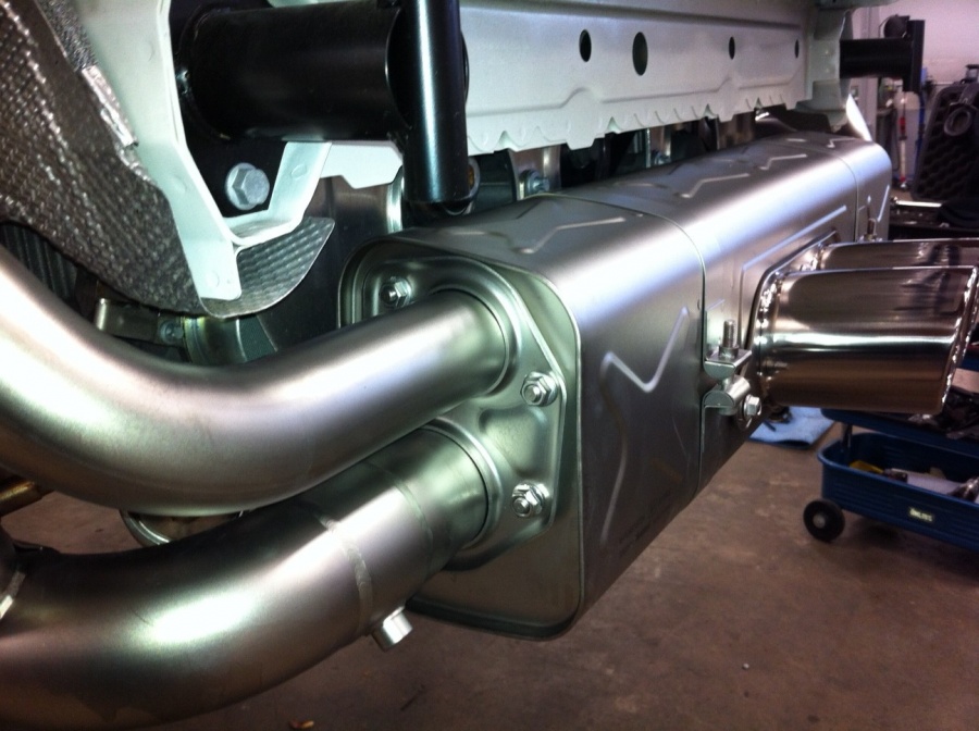

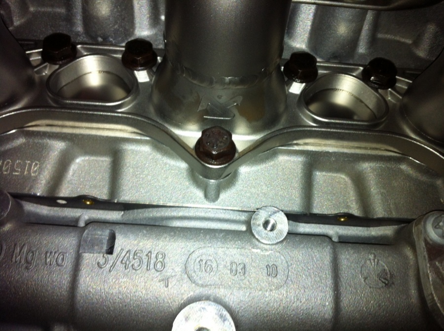

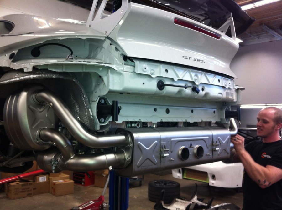

Exhaust update
I purchased my new exhaust through Colin at Cantrell Motorsports and he installed it for me as well. After much deliberation, research, communication with other Akrapovic owners, and some soul searching, I finally decided on the Akrapovic Evolution (non-Race version). For anybody who cares to know, I had several requirements that needed to be satisfied.
I baselined the car this morning down at Blood in Auburn and will pay them a visit again tomorrow (car put 405 to the wheels btw). I cannot perceive any difference in power with the system but then again I wasn’t expecting to (12hp/10lb-ft is hardly capable of being perceived on a 450hp motor!). However, the dyno will tell the story tomorrow. What I did notice immediately is the improvement in how quickly the engine revs. This pleases me greatly!
- Great sound. Loud and proud! The factory system is lacking IMO. I’m sure Porsche would agree but external factors such sound regulation no doubt influence design choices they must make. I wanted an exhaust to match the character of the car and as Porsche probably would have wanted it if no such external factors.
- Suitable for use as a daily driver. On my previous 997.1 GT3 I had a Cargraphic 6 which sounded great but sound level was loud and louder. I loved that car, but sometimes I simply wasn’t in the mood to listen to it or wished I could drive some corners w/o waking up my zip code. For my new system, I wanted something that retained the factory sound level in normal mode and then that comes alive in sport mode – something that puts me in control without compromise on either end.
- Real performance gains. The car is my daily. I’ll track it from time-to-time, but it’s not a competition car and has more than enough power for the street. However -- out of principle -- if you’re going to make your car louder it’s got to deliver the goods IMO. For me, a louder exhaust that makes no power is no different than adding a fake NACA duct for effect. Just not my style – everything needs to have a purpose.
- Weight loss (real performance gains, part2). Also out of principle, by adding weight to the car in the form of the 9lbs sound deadening I needed to repent by taking weight out elsewhere. By going with Akra, I take about 35-40lbs out of the car, so that more than makes up for it. It’s also weight out of the aftmost part of the car where it has the greatest effect.
- Driveability – I like a really fast revving motor – ideally, engine RPM on throttle blip would look something close to a step function. I’m not an engine designer, but suffice it to say that a lot of factors go into how quickly an engine revs and exhaust flow is one such factor. As mentioned at the top of this thread, the RS was a disappointment for me coming out of my 997.1 GT3 with the full Cargraphic 6 & GIAC. That car barked at you on downshifts. I knew that I wanted high-flo cats on my RS. I want the magic back.
- Top quality. I learned a long time ago that buying quality is always cheaper in the long run. Also, I couldn’t bear to put anything less than the best on my dream car.
- Flexibility. This wasn’t a requirement per se like 1-6, but I like that I have the option to convert to a full-race setup should I decide to do so by simply removing the side mufflers (will need to purchase bypass pipes though). At one point I thought about getting the race variant because less $$$, less weight, more hp/tq gains, but the cost to purchase the side mufflers separately after the fact is quite a bit more expensive than simply purchasing the full system.
"Noise limits are getting tighter across the nation. While we all love the sound produced, it is getting very difficult to find tracks that will accept cars over 101dbs to 103dbs. Monday and Tuesday events at ProFormance are for street legal fully muffled cars that produce very little sound. Monthly we will have one or two Wednesday/Thursday events that will allow slightly more tolerance. So,I would be careful in your selection. Hope that helps."
I only have about 8 miles on my new system thus far – I drove it straight home from Colin’s place. The system sounds great, every bit as great as my Cargraphic system and then some; great enough to erase the pain of the check written. Colin and his crew see a lot of Porsches so suffice it to say that they’re pretty jaded. Even with that, there was a lot of excitement over how great the car sounds and the build quality of the system. What impresses me most however, is how close to OE the system is when not in sport-mode in the lower RPM range. There is not even the slightest hint of drone, and you’d never know the car had an aftermarket exhaust just driving around normally. But press the sport button and put your foot into it … well, now we’re talking E ticket ride.I baselined the car this morning down at Blood in Auburn and will pay them a visit again tomorrow (car put 405 to the wheels btw). I cannot perceive any difference in power with the system but then again I wasn’t expecting to (12hp/10lb-ft is hardly capable of being perceived on a 450hp motor!). However, the dyno will tell the story tomorrow. What I did notice immediately is the improvement in how quickly the engine revs. This pleases me greatly!
