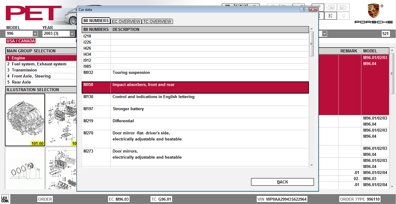

As you already know, this is for sure no GT3 - that is 100% certain. The VIN has already told you that, so there is really nothing more to discuss. You can also see that it is just a dressed up Carrera on the front bumper as well since there is quite a large clue here telling you this is not a GT3 bumper: No 3rd radiator.
All thats missing is a picture of the engine bay that will show nothing else than a Carrera engine. If there had been a GT3 engine back there you would have seen the extra radiator in the front.
As the others hav pointed out the brakes and ride height are all wrong as well. BTW a real GT3 does not have a rock hard suspension, it has a fantastic suspension.
The mk1 GT3 was produced in 1999-2001 and was never sold in the US (although a couple of cars was imported privately) and has a different areo kit than the mk2.
Edit:
This is what PET (i.e. Porsche) tells you about this VIN/Car:

I was gonna post the PET info myself but the poster above beat me to the punch.
Everything in PET points to this being a 2003 C2S. Matter of fact, the VIN-specific spec sheet points to a US build complete with all the US DOT trappings incl the "5mph" bumperettes. See picture.
Like the others have mentioned, there are so many layers of deceit with this car that I wouldn't touch it with a 10-feet pole. Put this cat on a lift, snap a picture of the underside and the engine, post pics here and you can end this scam here and now. Have fun at the exam!
