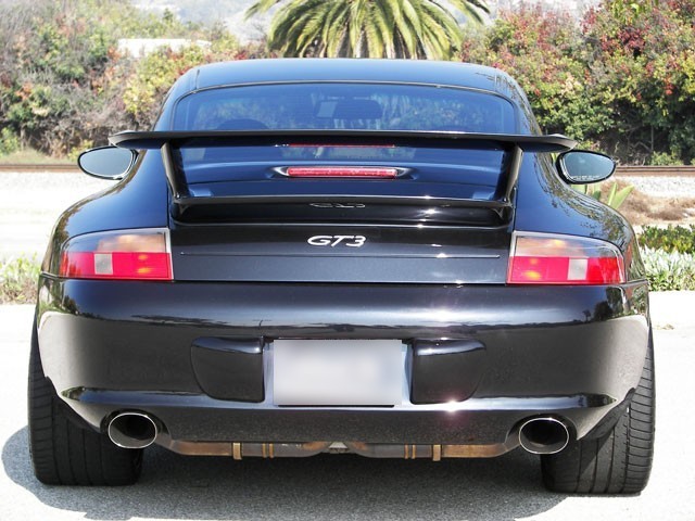

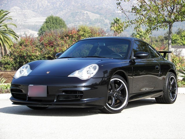

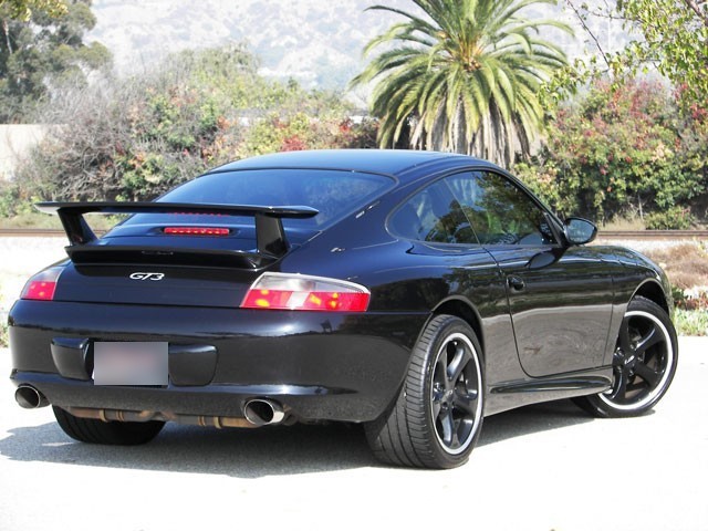

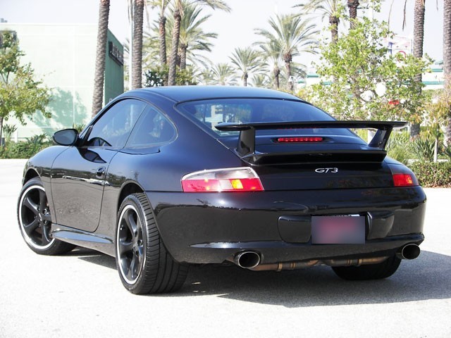

I don't really have any good pictures of the car. I'll post what I have, but these are the pics that came to me via email. I have seen it in person and it's absolutely beautiful.

Nope, Sits way too high and the GT3 badge appears to be way to high.
You are right, the badge is too high! Fake badge!

i agree the car sits to high and the badge is off. also, this is definately not a c4s body
this was my first reaction. it looks like an offroad vehicle!
i guess it could have been fitted with a smaller diameter wheel/tire combo to explain that...but it does look off to my eyes.

Suspension sits too high, rear badging is off, and the calipers are black. Too many yellow flags to warrant the real deal. RUN!

back seat...navigation...ride height...GT3 badge...no GT3 badge in the rear ****pit under the tray....those aren't yellow flags they are bright red!! you should expose this poser for what he is....even, and this is speculative at best, if he went to the trouble to install a GT3 motor and drivetrain plus suspensiion it will never be a GT3 and you will never get your money out of it...it doesn't look to me that he has changed any of the suspension with the way it sits...and I would doubt that anyone that went to the trouble to put in the engine/drivetrain would screw up a simple thing like the rear badge

sitting way to high.
