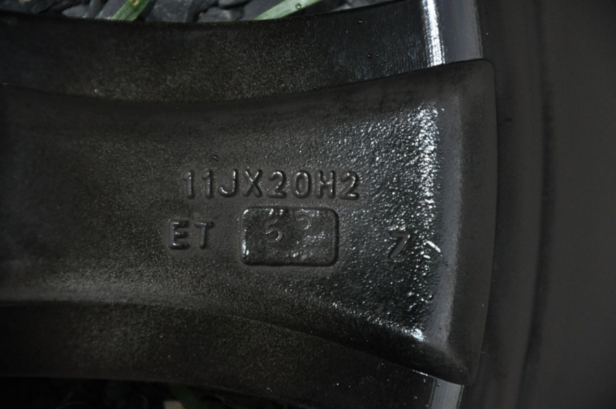

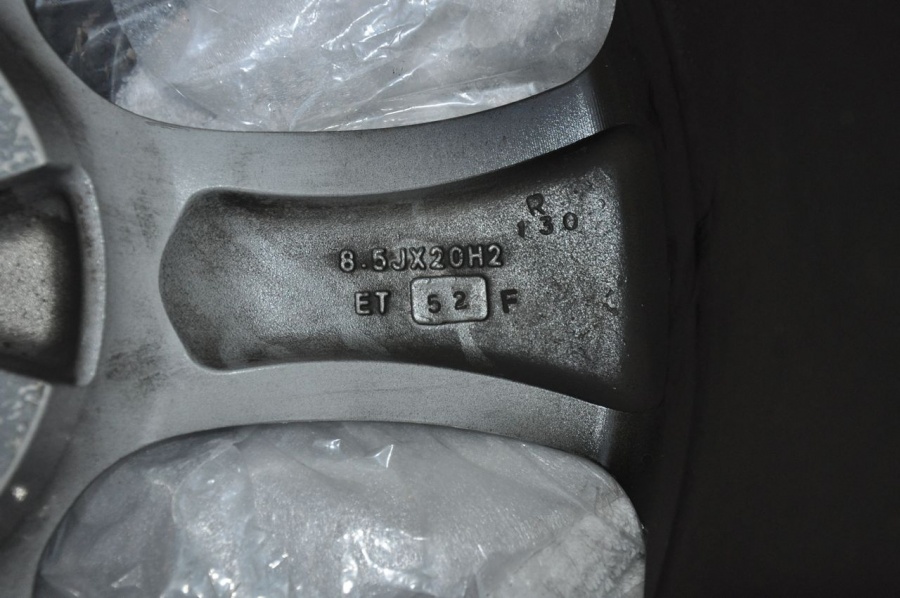

My GT3.1 came shod with TechArt Formulas, rear: 20 x 11, offset = 55 mm. Front: 20 x 8.5, offset = 52 mm.
Using Continental ContisportContact 3: rear: 305/25/20, front: 235/30/20.
The 20 x 11 rear fills out the wheel well adequately enough for my eye while still keeping the 305 tire width. I don't know enough about tire aspect ratios, etc but if you stray too far from OEM size, you will negatively affect suspension, could get tire rubbing on fenders and a slew of other problems. As others have mentioned, please defer to the dealer whom you will be ordering from, preferably one of our forum sponsors here.
