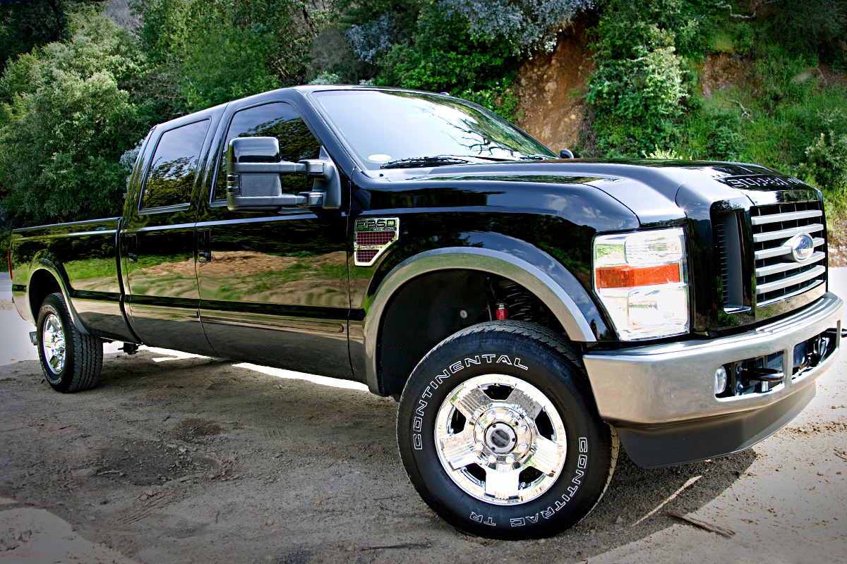

I think another issue with the ML is the wheelbase. it is shorter then the GL, for instance. You lose stability, especially in an emergency situation. I use to use a Land Rover LR3 with a 7700 tow max and air suspension. It was great for the open trailer but when I went enclosed, it wasn't enough.
If you like MB then maybe consider the newer GL350 Bluetec with tow package and air suspension.
Now I use this. Works like a charm:
