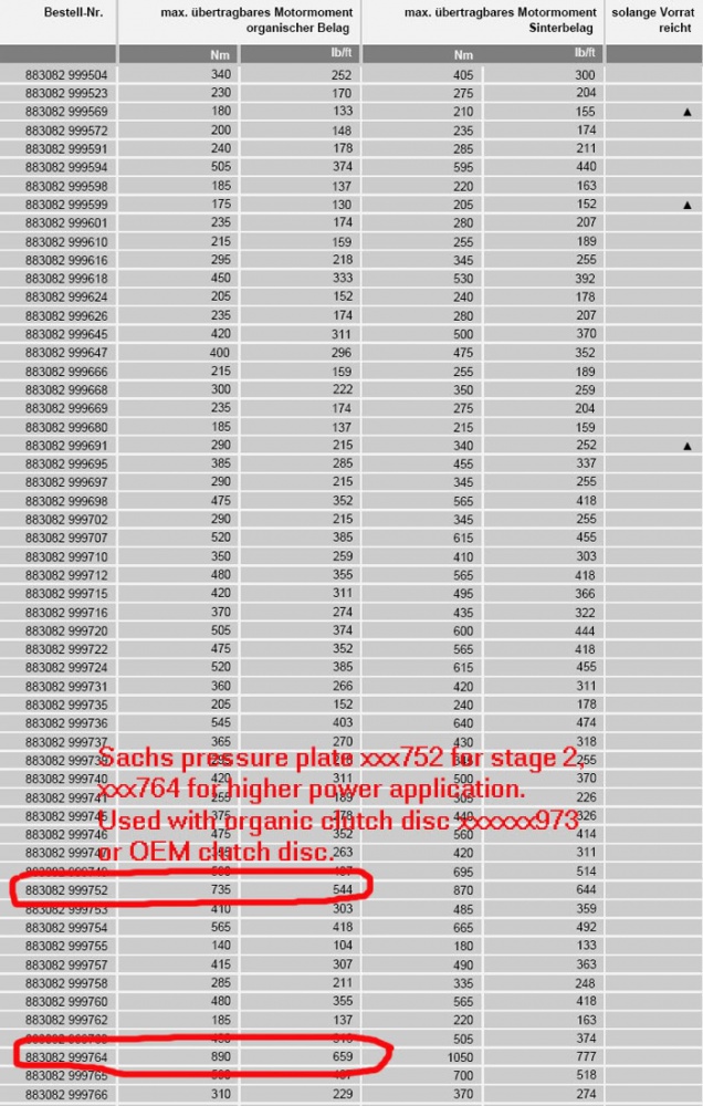

Hi,
Im looking to get a protomotive tune (if no one here recommends anything else?) and exhaust with 100cell cats. Can the stock clutch take it?
car is a stock 997 GT2 with 10000km on it and is like brand new.

For reference, the part number for the GT2's clutch is shared with the 996TT.
I don't think slippage is due to the clutch itself, but rather, the pressure plate. What are the numbers on Todd's tune?
