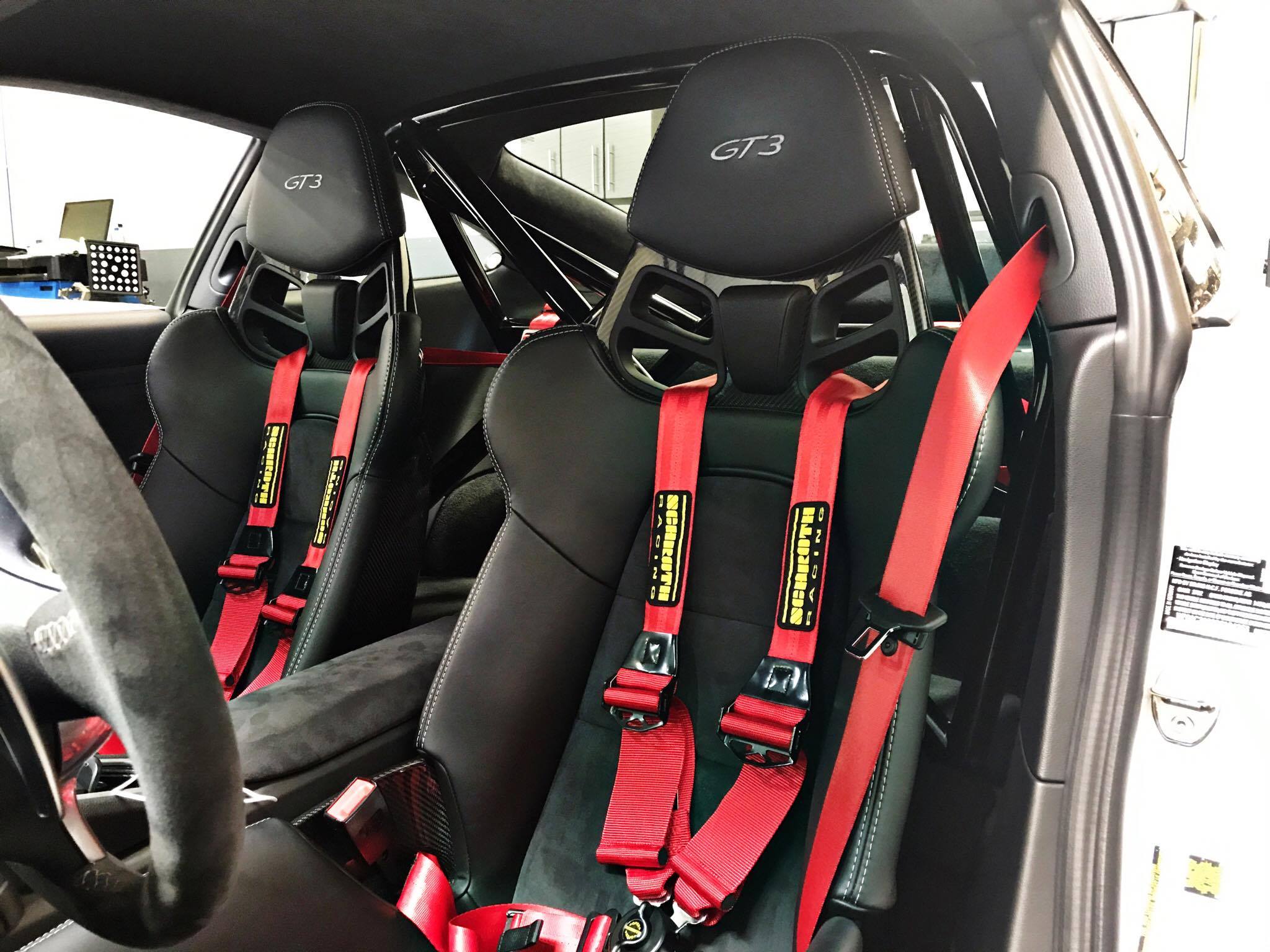

[SIZE="4"]Bound for Laguna Seca, Alekshop did full track setup (corner balancing, alignment) and installed our BBi StreetCup Roll Bar to provide additional protection and proper restraint. To keep the car below Mazda Raceway Laguna Seca's restrictive decibel limit of 92dB, Alekshop installed their purpose built exhaust tips to their exhaust systems that divert the sound away from the sound meters and used it in conjunction with their “GPS Controlled” Exhaust Valve Controller that keeps the valves closed near the sound meters. We are proud to have Alekshop as our newest authorized installation center in Northern California. Here are some detailed pictures of the build process that we would like to share below[/SIZE]

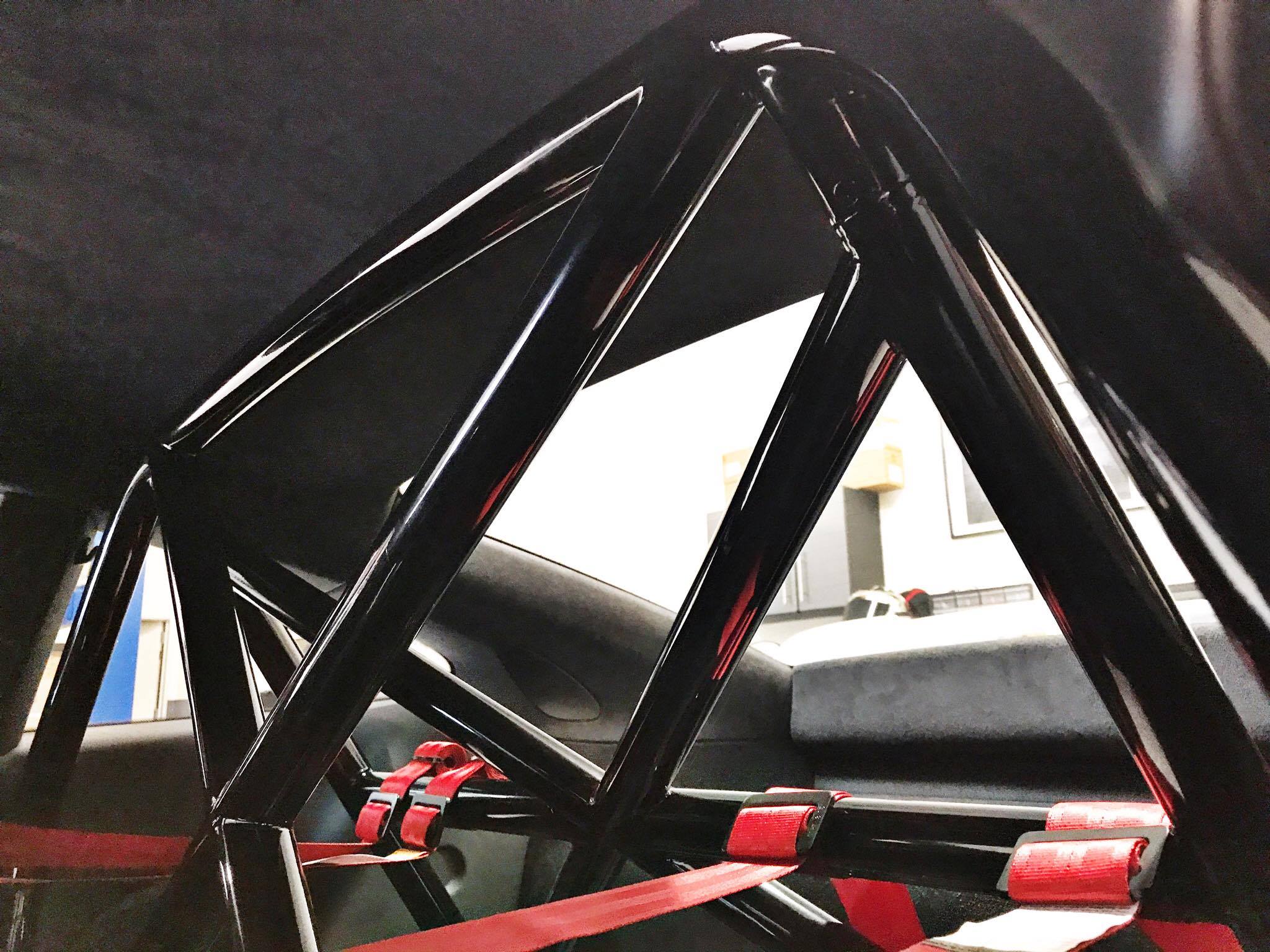

[SIZE="5"]BBi Autosport Porsche 991 GT3 StreetCup II Bolt-In Roll Bar[/SIZE]
[SIZE="4"]Features[/SIZE]
[SIZE="5"]Schroth Racing Profi-II HANS Harness, Porsche GT3 Specific in Red[/SIZE]
Porsche GT3 Cup Cars come with Schroth belts direct from the factory. They are specific because of the lap belt attachment. They have a sewn-in bracket that fits perfectly on the factory mount. Standard belts require additional fabrication and a spacer to make them work. These are a bolt-in replacement which is much easier. The sub-straps have no adjusters to fit correctly in the vehicle, and the shoulder belts are shorter to reach the works cages with minimal excess.
- 1.625" x 0.095" 4130 chrome moly steel tubing utilized for excellent strength to weight ratio
- TIG welded and utilizes "X" braces on both front and rear sections for superior strength and rigidity
- Mounts to frame structure (utilizing factory bolts) to provide strongest mounting points and maximum protection
- Utilizes laser cut mounting plates & inner diameter tube clamps that are CNC turned and milled for a precise fit
- Designed to work with stock seats or any aftermarket seats on the market
- Allows full seat travel to accommodate taller drivers
- Can be used with stock seat belts or 6 point harnesses for track use
- Designed to work with wrap-around style harnesses while optional eyelet bolt provisions are available for clip-in harnesses
- OEM fit & finish. The main hoop contours entire arch of the roof with an even 3/16 inch gap
- Finished in satin black powder coat. Other colors available Bolt-in installation requires no drilling and minimal carpet trimming
- Made in USA
