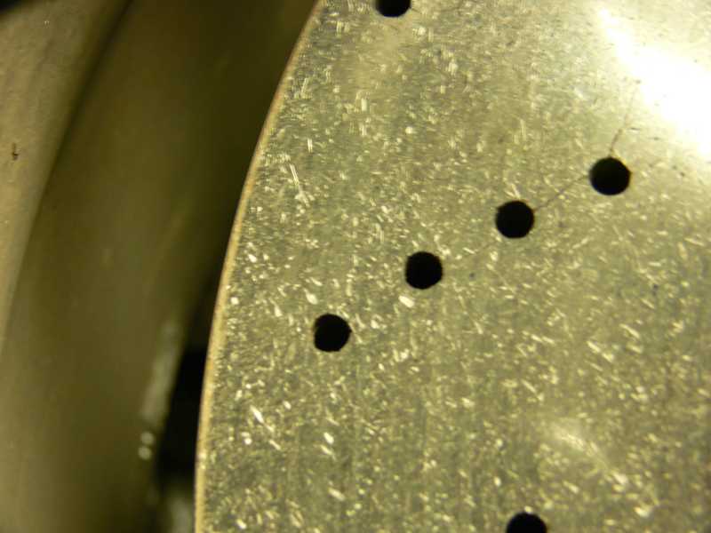

Here're a couple of close-up's. What do you guys think? What's strange is that only the right rear has cracks, the fronts and other rear rotor don't have any.

looks like surface crack but really hard to judge in the pics.

Odd that the cracks occur in the rears when the fronts usually take more stress?

that's a deffective rotor

have your dealer check it out

not good.....

they are connecting 3 holes, you need a new rotor.
