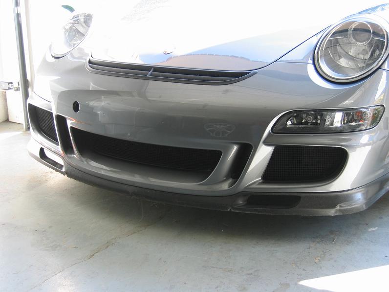

sorry for your loss. thats why i made my own grille screens. take a look at this thread
https://www.6speedonline.com/forums/...le-screen.html
mine are made of stainless steel and came powder coated black. best part, the screens cost about $40 from OSH. but.. its a bit of work

I actually used this same grill from OSh. Its was hard to work with because its a much thicker material which made it harder to form. But was well worth it. End result works great. It actually looks very close to the grille screen used on the airfilter scoops.. thumbs up to daytonaviolet for finding this...

Another option is make your own. I did that for a cost of about $20 and few hours for me to fab/install it. Since they are going to take a pounding anyhow, easy and cheap to replace. here's a pic:
Where did you get your materials, and how did you attach the screens?

im not sure what rmag used, but i used a 2 part epoxy. i was very generous with the epoxy so if a big rock hits the screens, hopefully it will just deform and take most of the impact rather then falling off. its also someone sandwich in place and its made of stainless steal.. hopefully it will take a good rock beating.

it came black powder coated. actually, there are 4 color choices. white, black, silver and bare metal.
