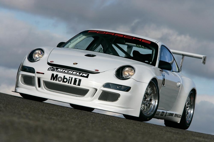

I think you would have to fabricate your own. These look like they may attach to from the front, not sure, they have frames around them. the site I posed below, you can by trim to frame the screen and clips to attach it if you want to go that route. FYI i have no affiliation just found the parts helpful.

those look perfect !- I can't find them yet- I have been trying to fabricate with mesh and edging I use for front spoiler. Not satisfactory yet.
