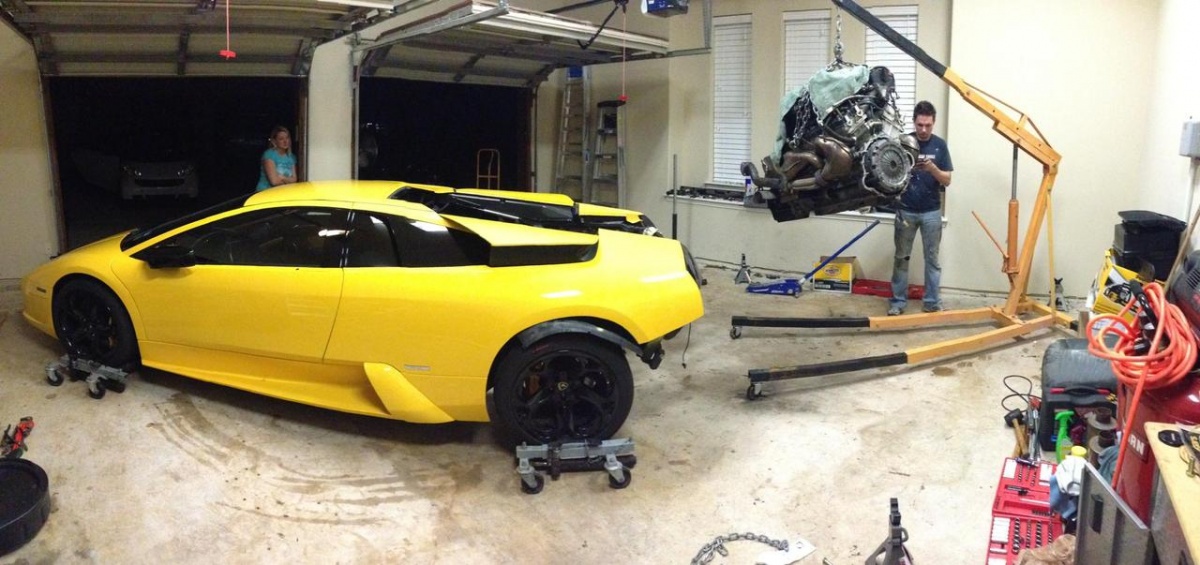

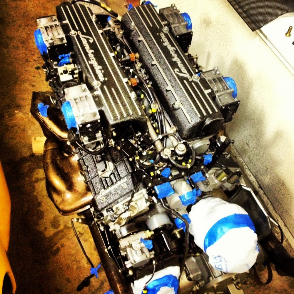

I decided to put a Kevlar clutch in the car. Here are some pictures of cleaning the engine and engine bay out.

A pic of the car..

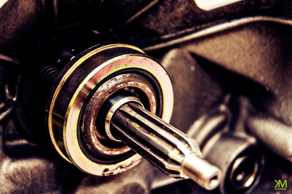

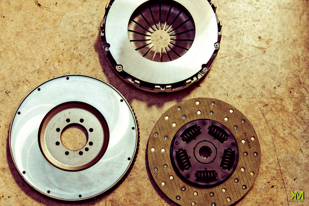

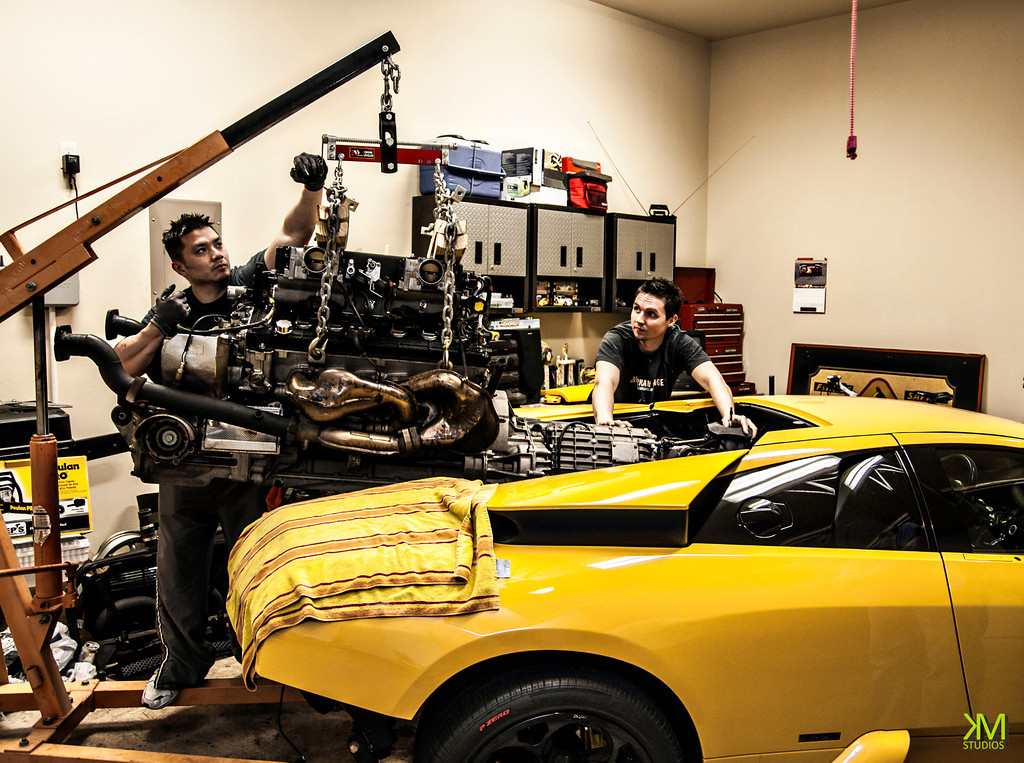

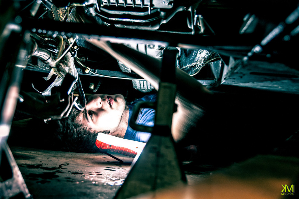

**Update**
Friday we installed the CORRECT flywheel and kevlar clutch. Saturday, transmission fluid was topped off and then in went the engine. We had a problem trying to get the engine mount bolts in after mount the transmission. After finalgling for a while, we decided to call it a night. Sunday morning, the transmission was unmounted and we bolted the engine up first. Easy peasy. In hindsight, it makes sense that it worked because it was reverse order of removing the engine and transmission. Power steering fluid was topped off and the rear engine... brace was installed. Protip: When installing the rear brace, make sure the car is not on its wheels. The weight of the engine cause just enough flex in rear to make it impossible to get the brace in. That was it for the last weekend. Next up, clutch/brake fluid (the tool didn't arrive until Monday), coolant, the final part of the exhaust and misc panels. We are getting close!!
Kevlar!!!!
New and shiny!
It's in!!!!
Until next time....
