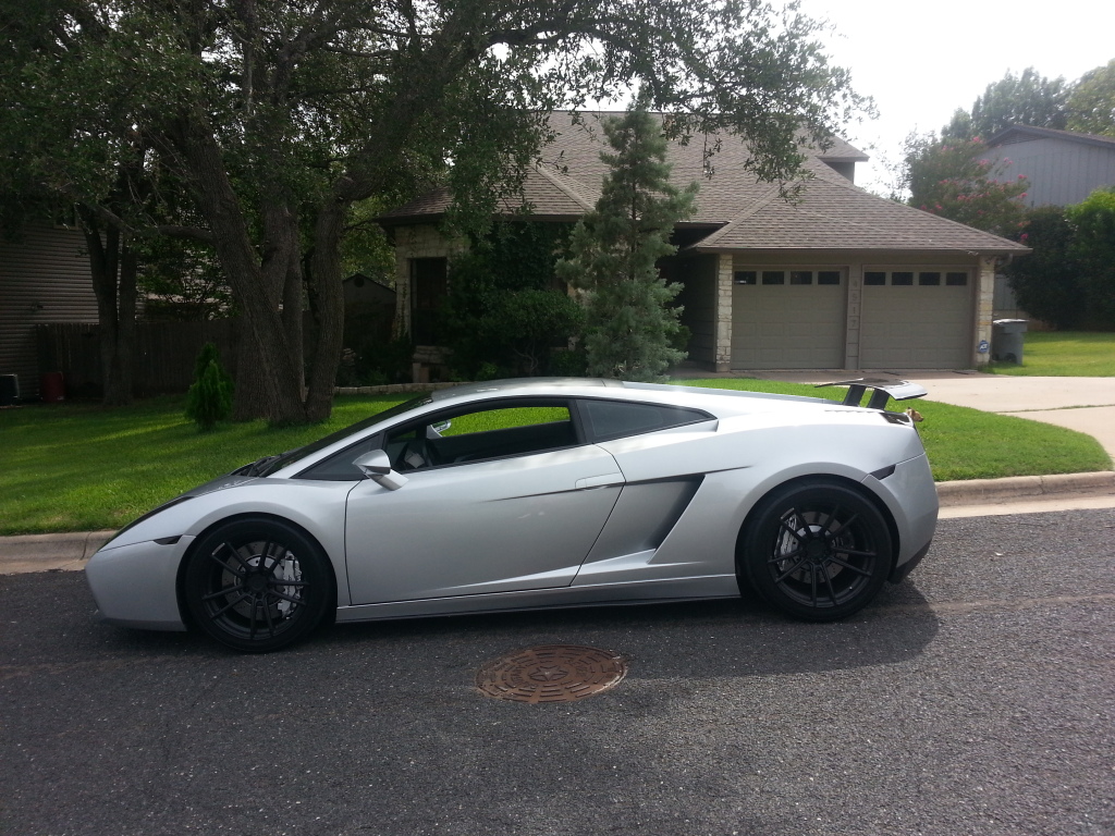

Well I bought an 04. 3600 miles! Light mods...no tune. Loving it!
WOW!!! Really nice!
Did you trade the 997TT?

Congrats, that's a gorgeous car! Is it a manual trans?

You will love the car! Congrats! I also have an 04 and it has been a fantastic car. If you get up to Dallas, give us a heads up.....

Nope sold the 997. Its a 6 speed...only way to go for me. Ill absolutely hit you up if Im in Dallas.
