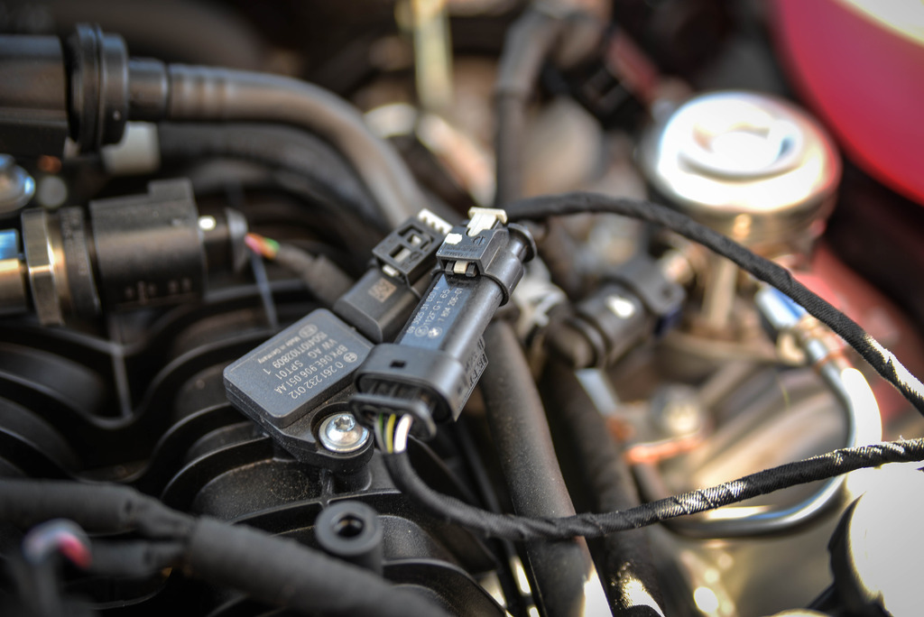

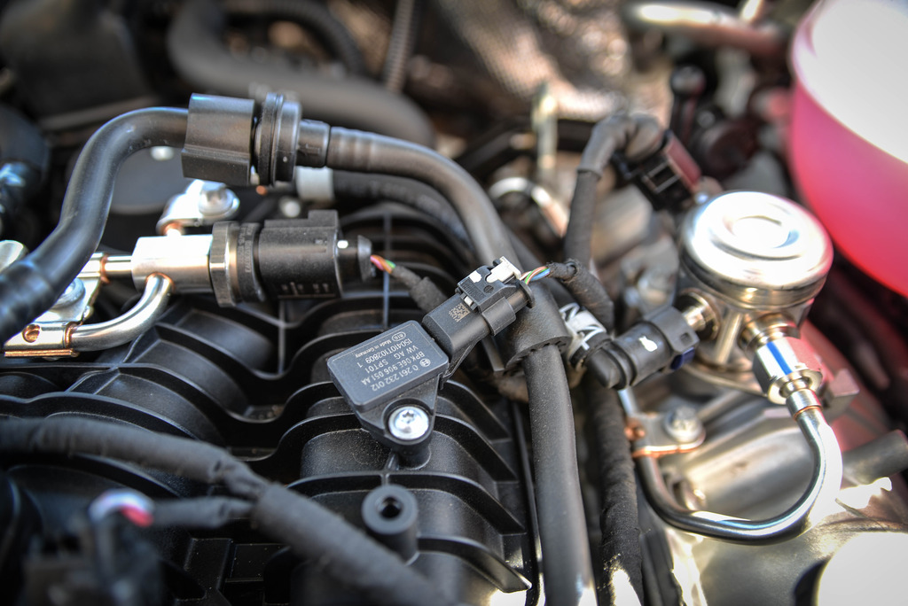

So the installation essentially is as simple as unplugging a sensor, plugging it into the harness, and plugging the harness into the OEM location (three times) and then hooking up a power and ground.
Sensor 1 (looking for little red wire):

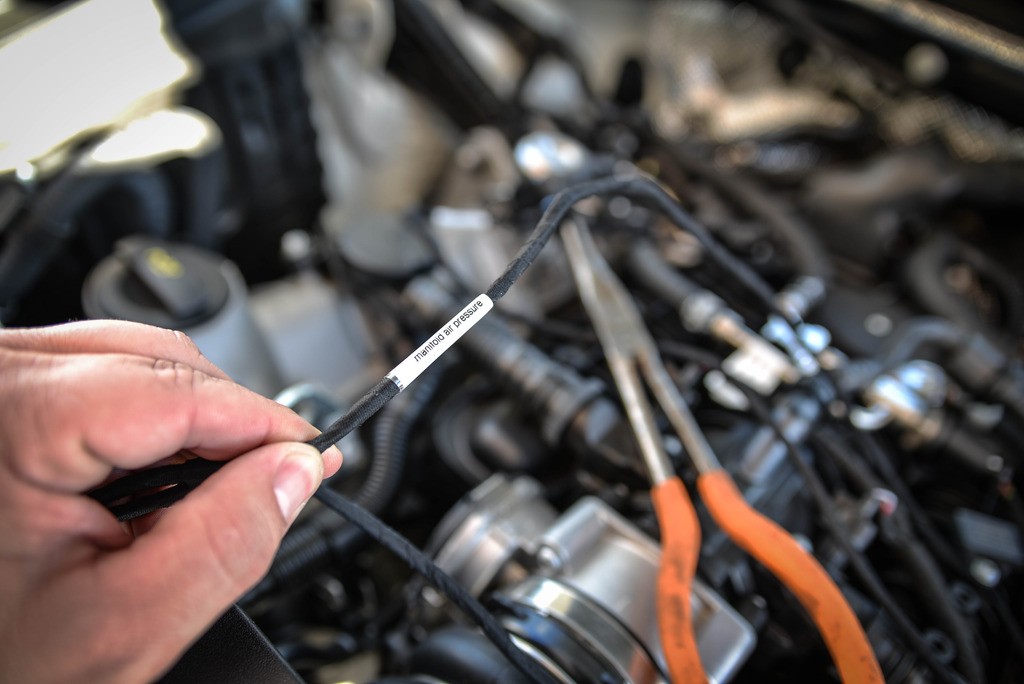

Sensor 2:
They do a great job marking the harness so you can't screw up which sensor goes where.

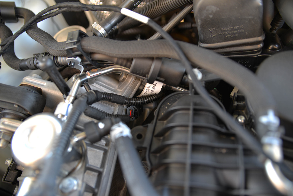

Sensor 3:

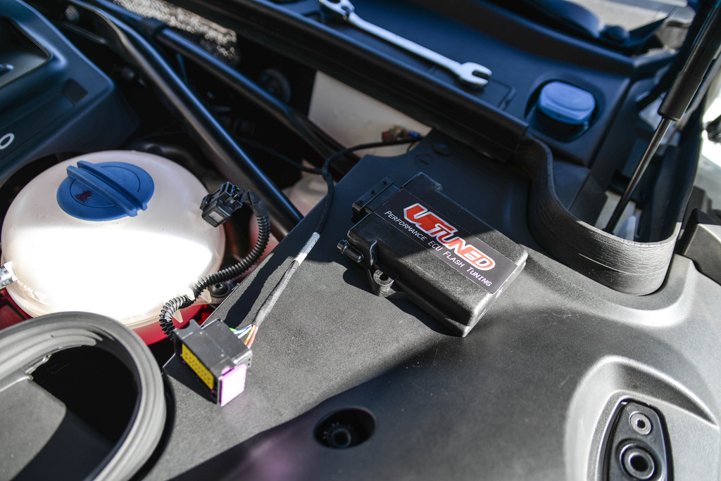

Now connect the module to harness:

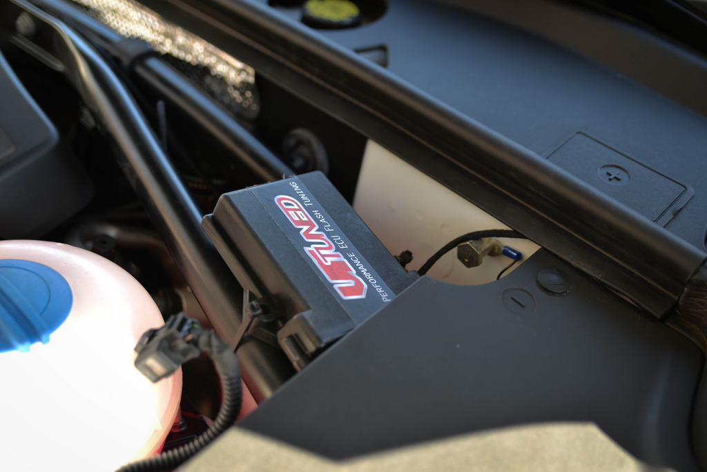

Put the module somewhere safe and out of the way. I chose to use the strut tower as a nice easy place to mount it.
