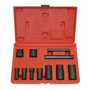

Check with the guys in the service bays at BMW, Most mechanics tend to have a good collection of keys miraculously accumulated over time.
If BMW cant help find a key, Then you could find a shop that has this kit. Typically, we would replace all the locks with a new kit if you lost the key.
This is the kit that most shops would use last time I was a tire tech.
http://www.amazon.com/Advanced-Design-ATD-3060-Locking-Remover/dp/B000OUUGJG
You need an air gun to do it well. You find the right size smooth wall socket in the kit and spin it fast on the locking lug to get it hot. Then you pop it a few time with the BFH so it is on there good and let it cool. Then take the airgun and carefully apply torque until they break loose.
