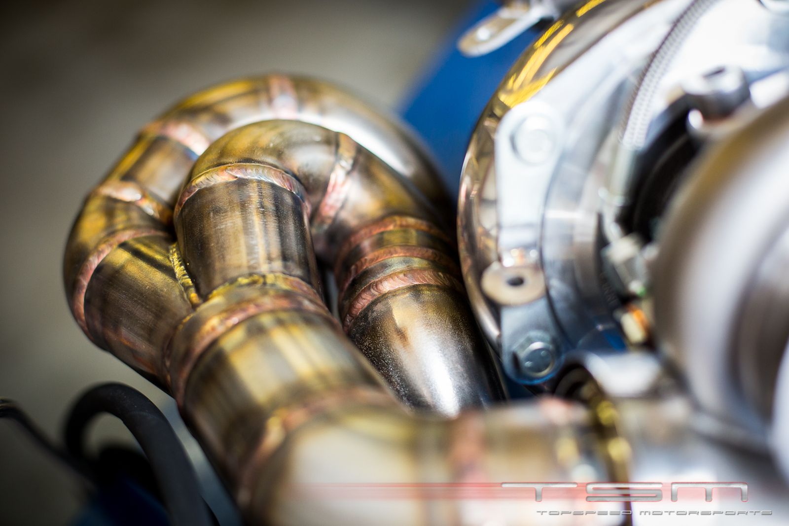

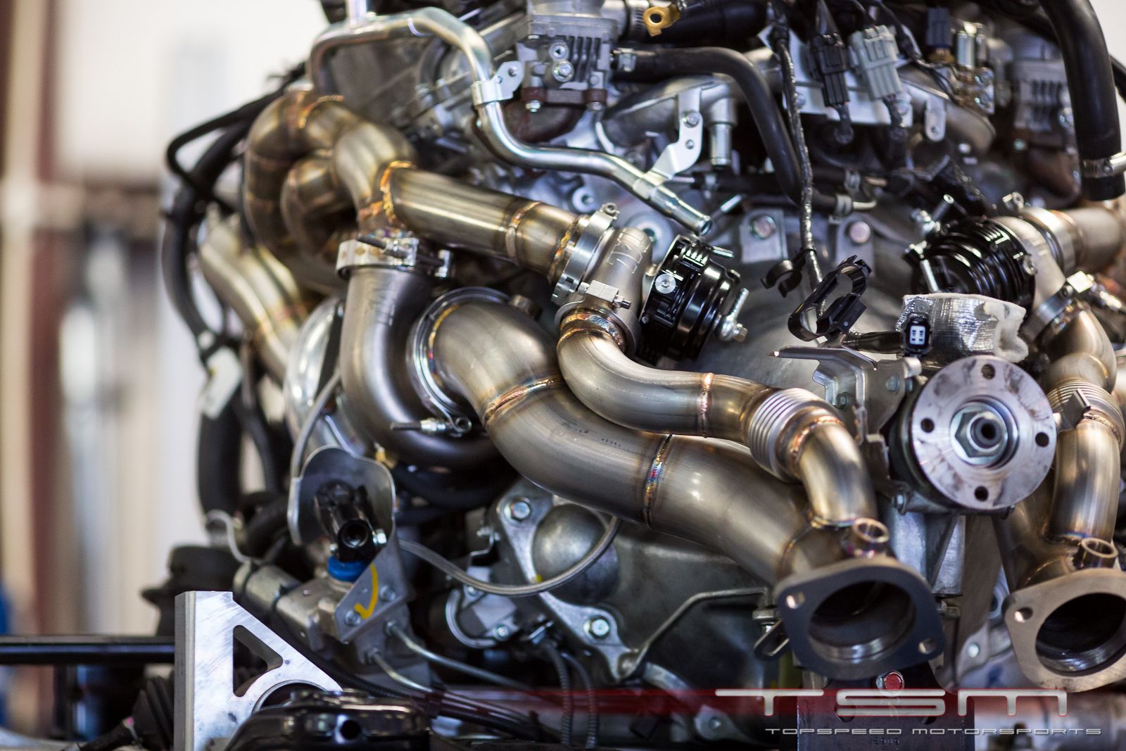

This car is going to be yet another animal! Equipped with our iron sleeved TE400 engine (4.0 liter) and ETS’ Turbo kit. The turbo kit houses twin GTX35R Garrett turbos and we also opted to test out their new “BIG” intercooler kit to flow all the air those big snails are gonna push out.

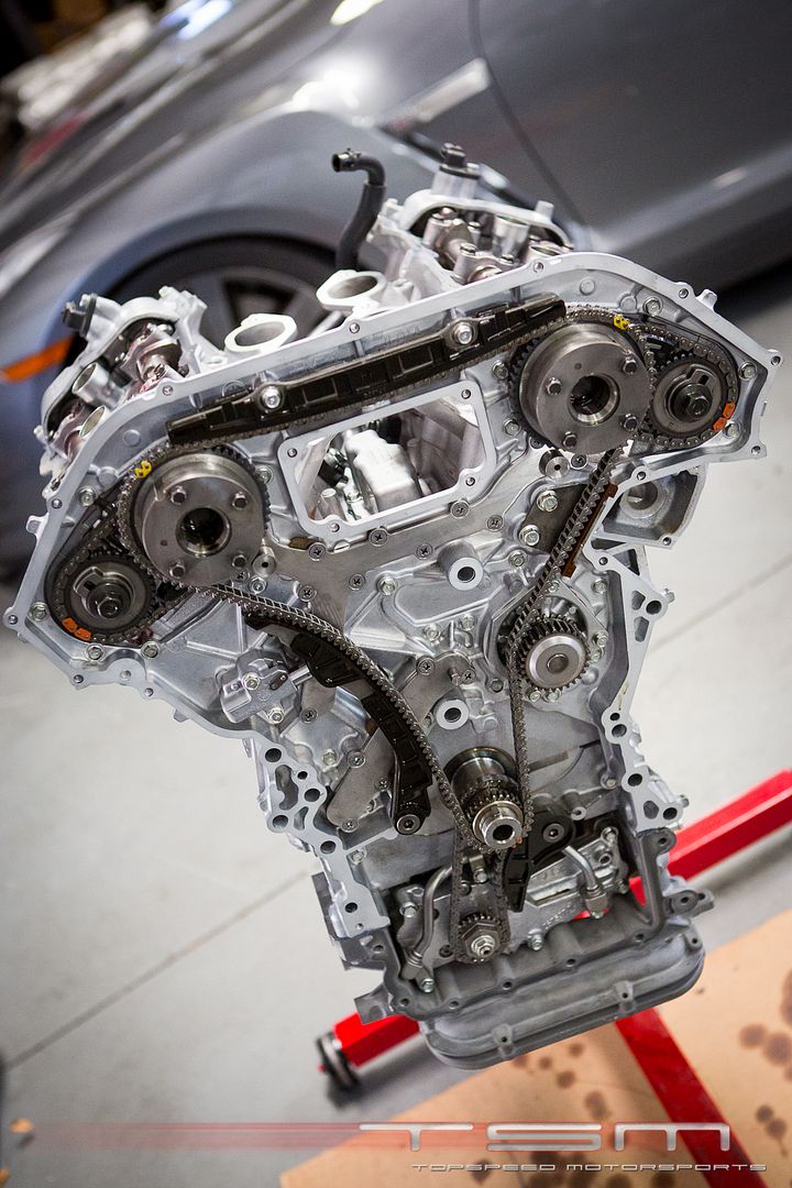

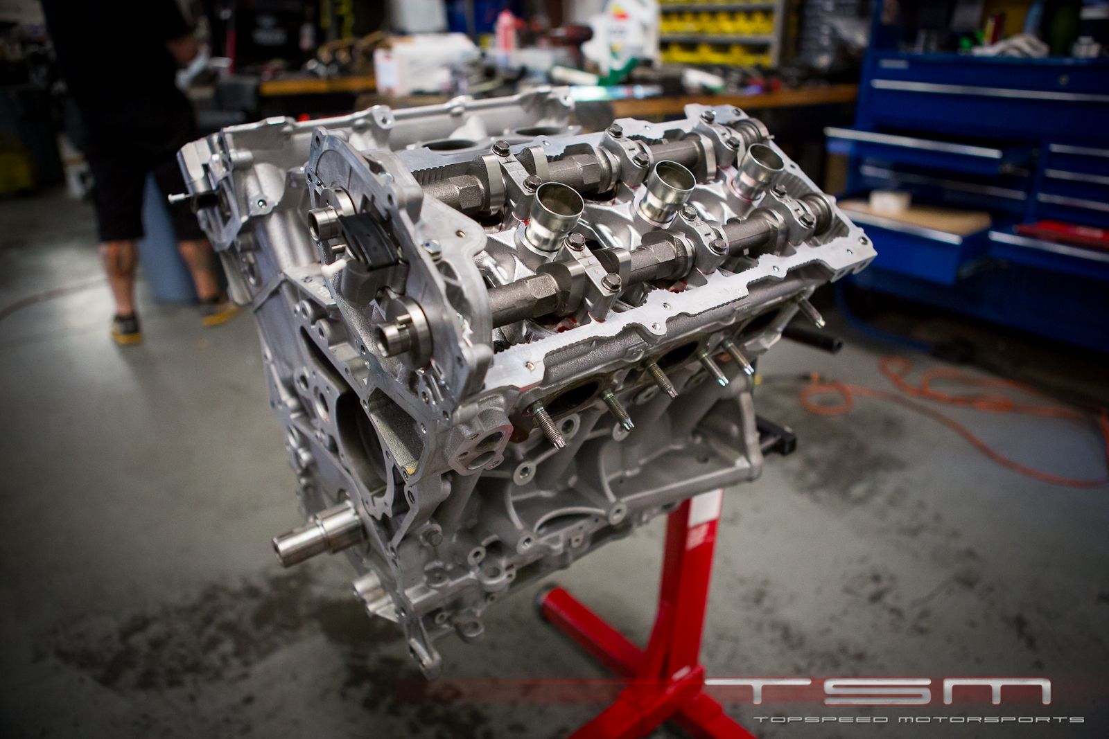

So the guts are as follows:

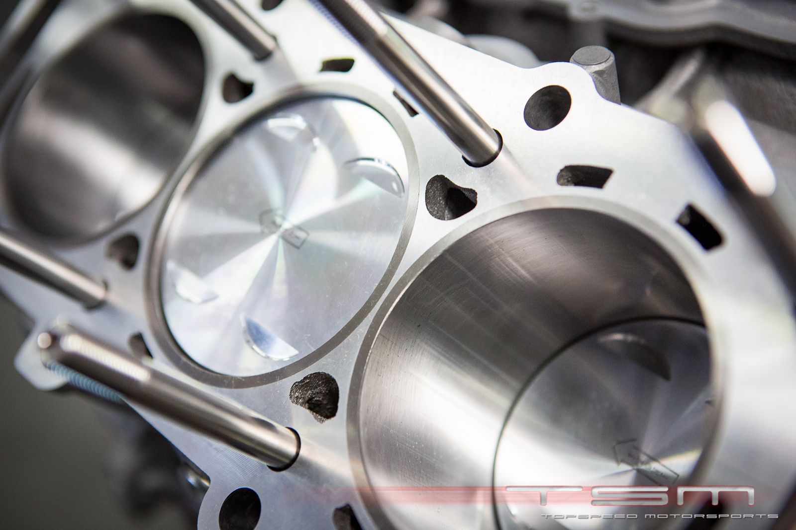

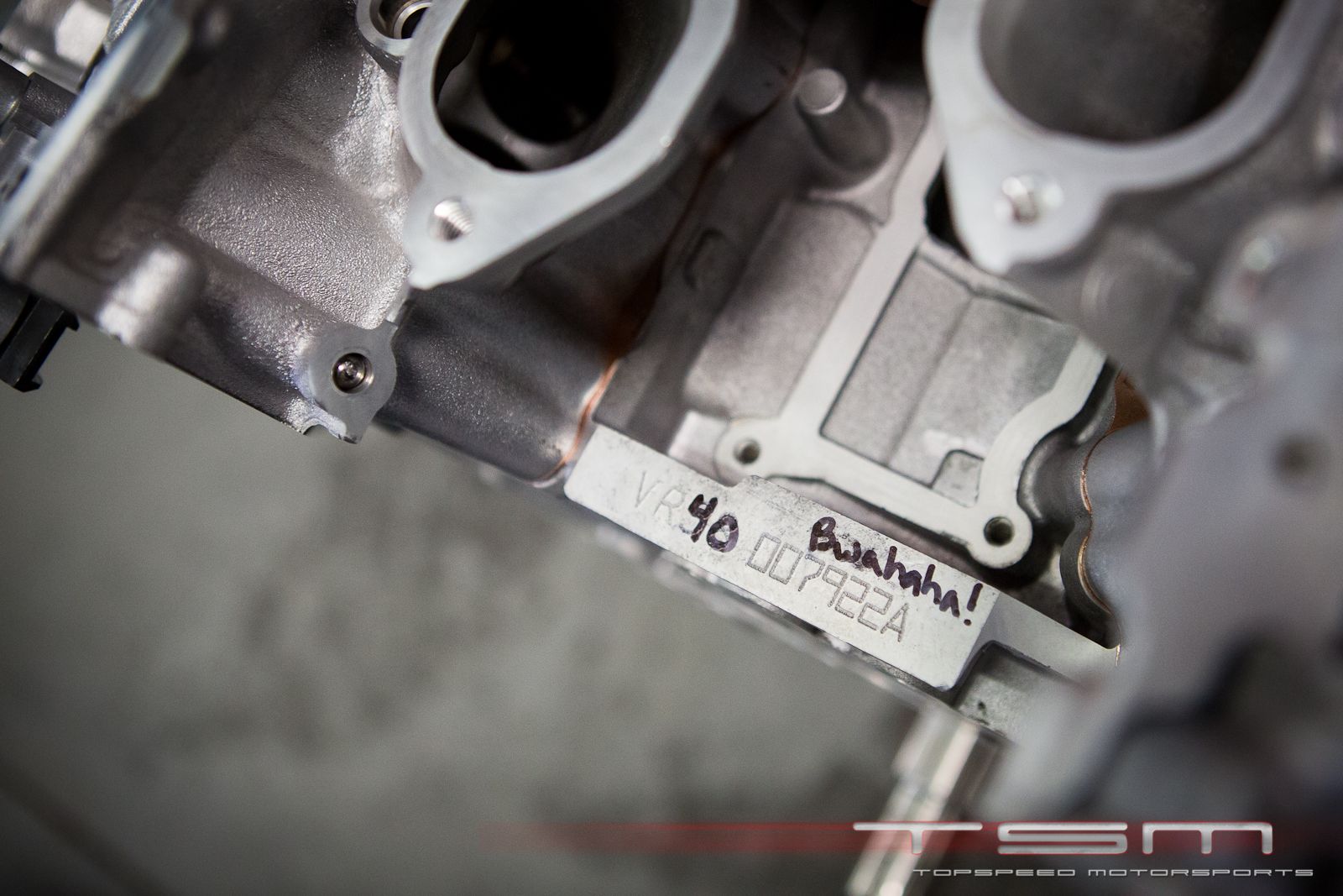

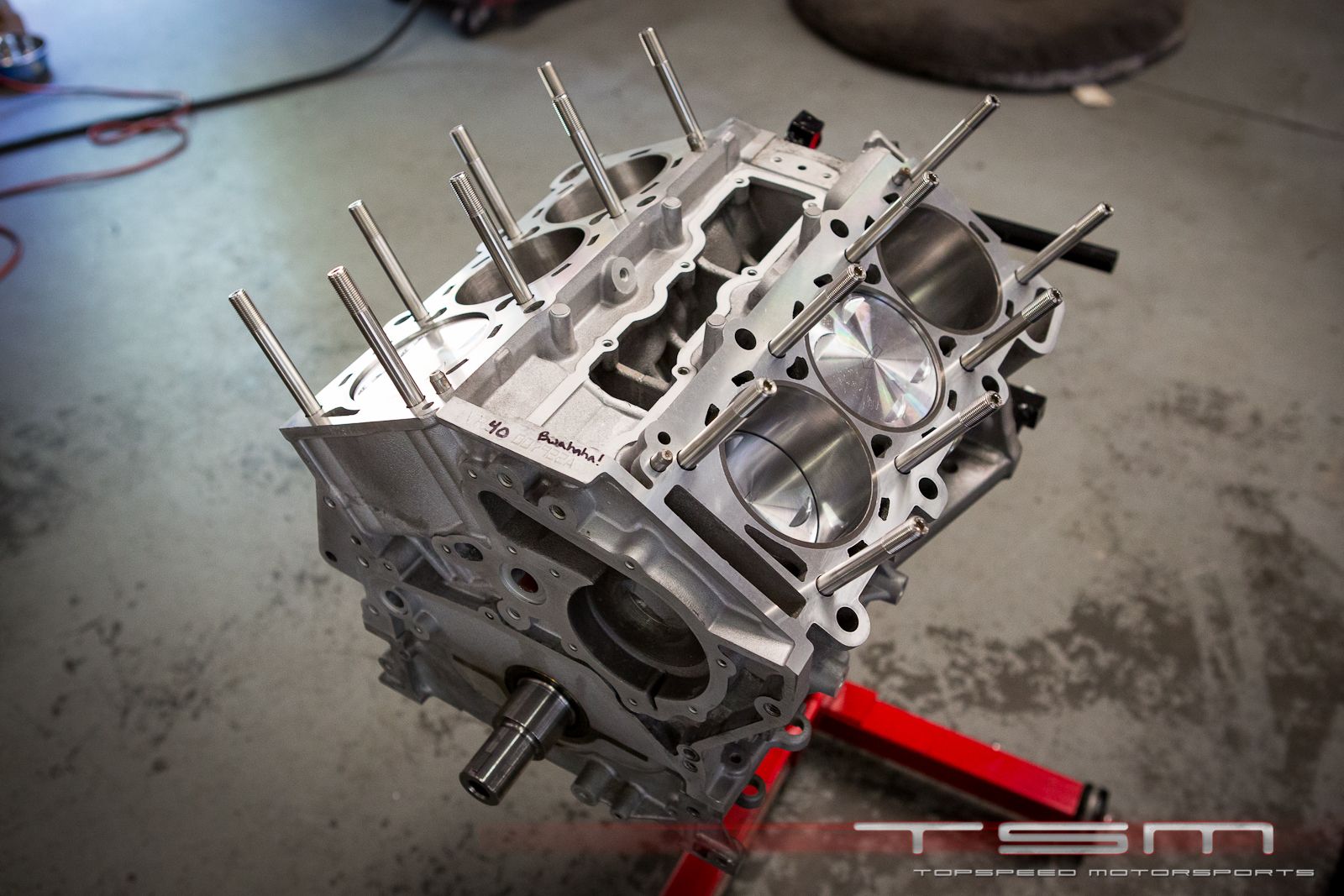

-TSM DE400 Drag Race Engine
*4.0ltr
*In House Designed Iron Sleeve
*Custom Manley Pistons w/ modified compression
*Manley Rods
-TSM Head Work
*Extensive Porting/Blending
*Oversized Valves
*Supertech Springs/Retainers
*Kelford Stage2 R35 Cams
*Chamber Coatings
-Shepard built Dodson Quiet ProMax

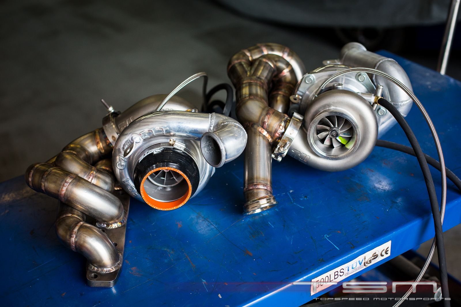

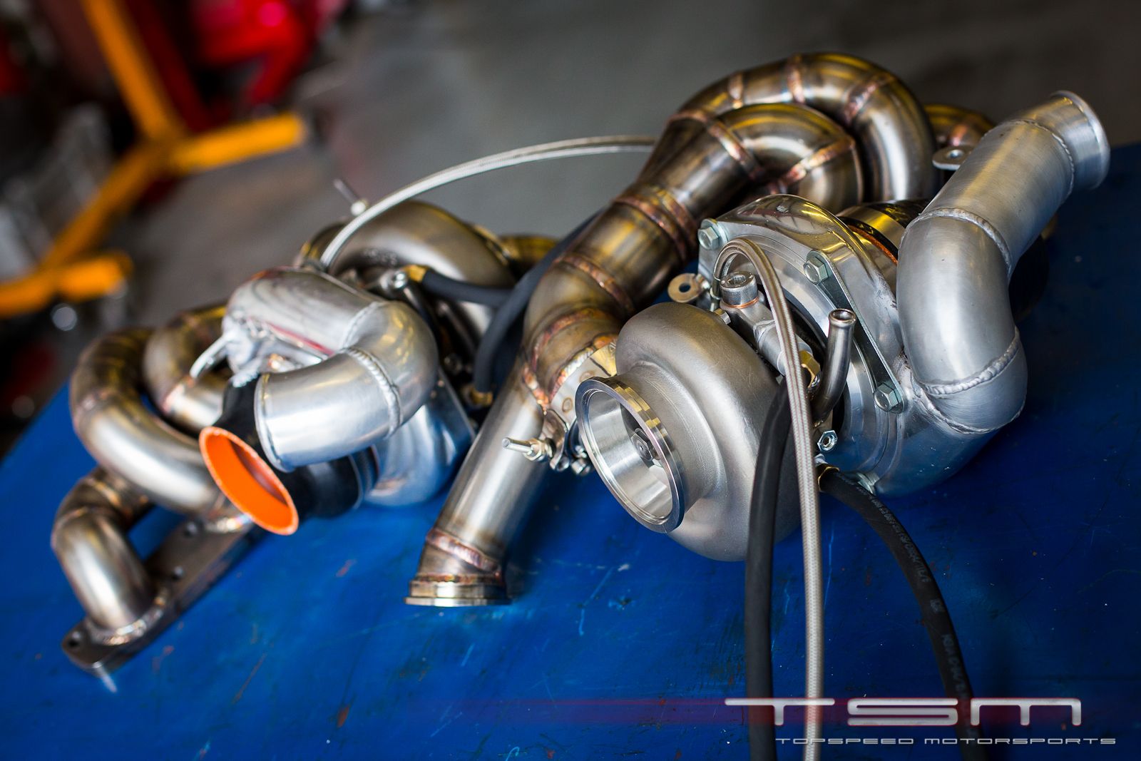

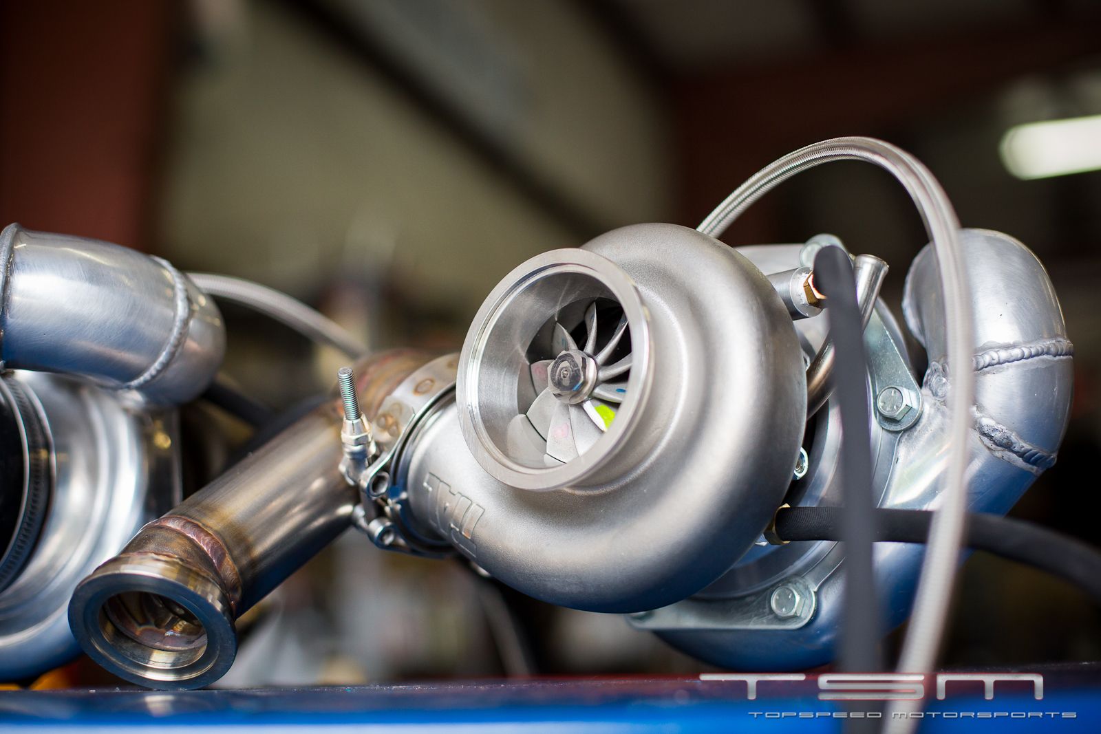

-ETS Turbo Kit
*ETS Manifolds
*ETS Downpipes
*ETS Logic Intakes
*GTX35R Turbos
* Tial WGs
-ETS Intercooler Piping
-ETS “Big” Intercooler

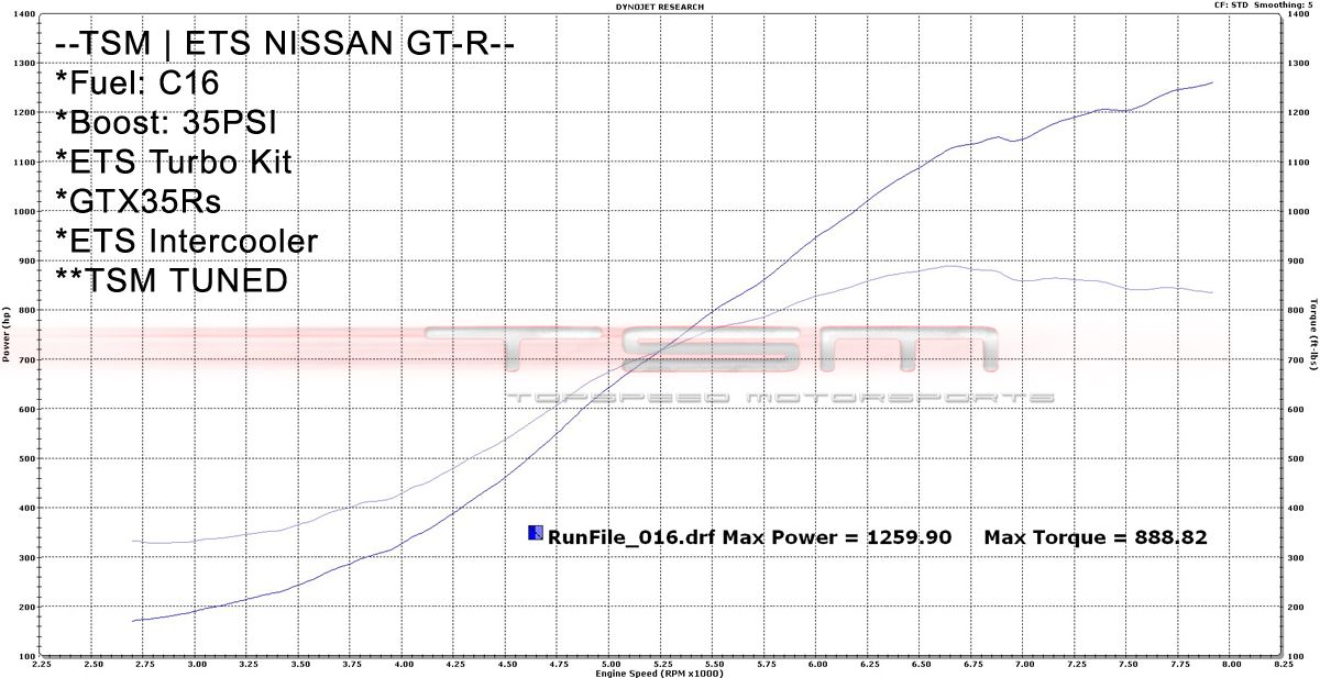

Final numbers guys!!!!
We stopped the tuning at 35.5 PSI of boost....she is getting loaded in the trailer to head straight to the 1/2 mile event now!
Super excited to get some 60-`130 numbers up at this event from this car. It will be running PS2 street tires, so boost by gear tuning will be very needed
Final grap.....
