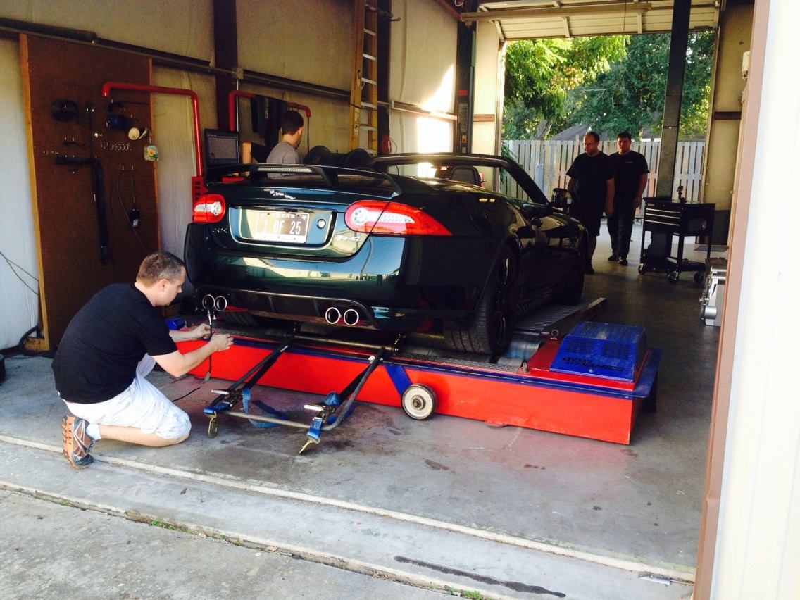

Here you can see Jerry strapping down the car.

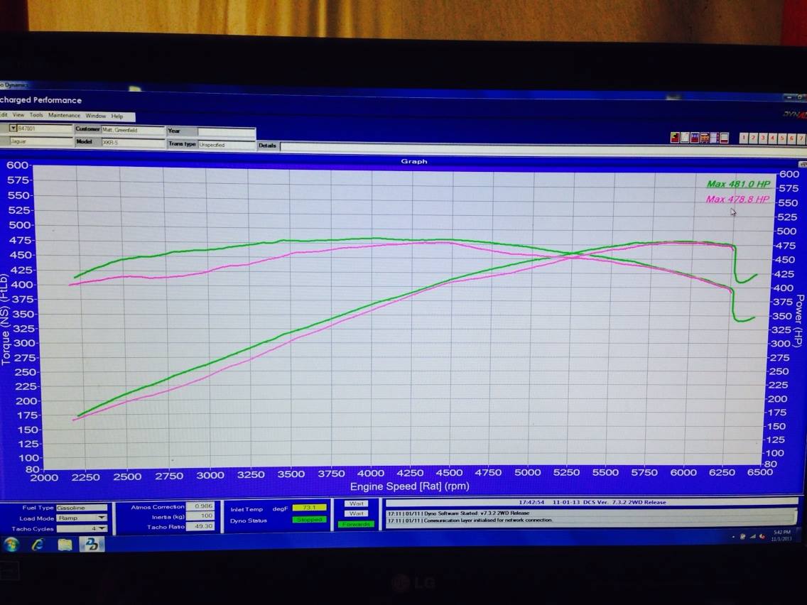

Here are two of my baseline dynos. Not bad! Best one was 481 rwhp. The runs were carefully done in 4th gear. If you floor it too soon, it will downshift to third. I think we actually did three pulls. One was discarded because of a downshift.

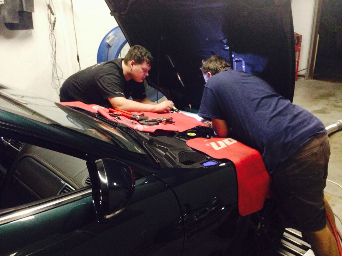

Removing and replacing the new pulley took the most time, by far. There isn't much room at all to access it. The old pulley was carefully cut off and the new pulley was heated up and put on. This took about 2 hours, plus the motor needed to be cooled down a bit before they could even start. The tune was installed while the pulley was being removed. I hung out in the office and chatted it up with Jerry and his staff. From what I gathered, they all love to fish and play with cars all day. Maybe one day I will take an offshore fishing trip with Jerry on his boat.

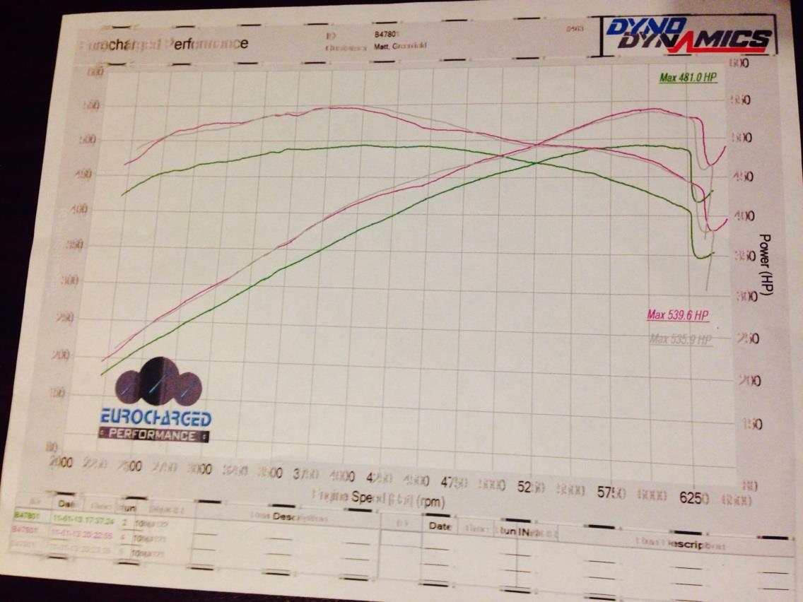

I was very happy to see the results, a gain of 58.6 rwhp! My initial prediction was 50-65 rwhp...So I pretty much hit that right in the middle. I went from a peak output of 481 rwhp to 539.6 rwhp, with nice gains all across the RPM band. The torque numbers between 2500-4000 look especially nice. That is usable real estate right there.

If my baseline was 481 rwhp and we account 15% for drivetrain losses:
Doing the math conservatively, 481 x 1.15 = 553.15 hp, and the XKR-S is rated at 550 hp, so this is very close. The only other mod I had on my baseline run is BMC air filters in the air boxes.
If that is true, and my final number was 539.6 rwhp, then lets add in drivetrain losses (539.6 x 1.15) = an estimated 620.54 HP, which is an estimated gain of 67.39 hp. I say these numbers are an estimation because I don't know for sure if 15% is the exact number for drivetrain loss on this car, but it should be close.
