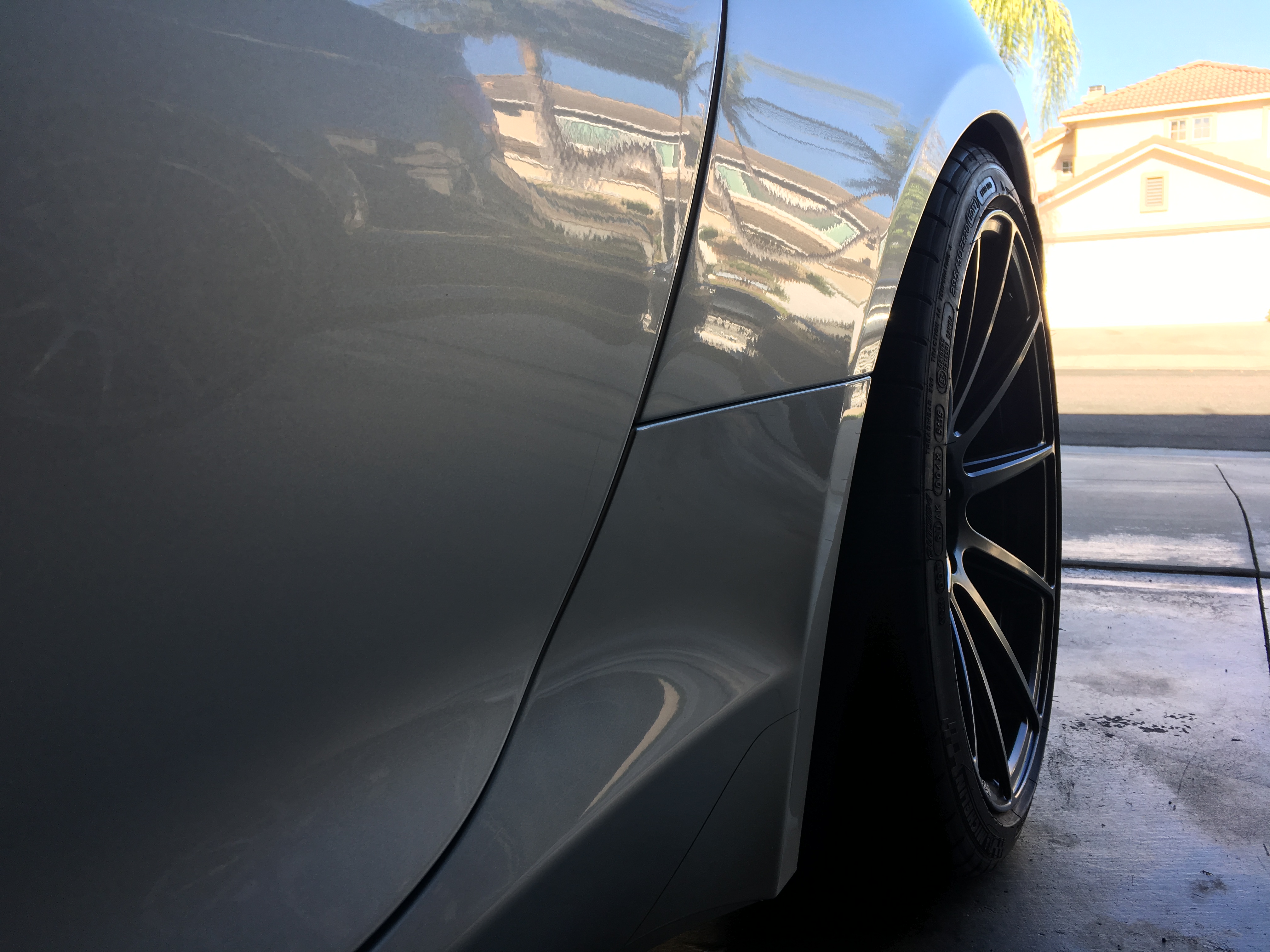

H&R springs installed
H&R 28822-1 springs installed and now sitting 1.2" lower. As far as the ride goes, it's slightly more firm than stock but has a lot less body roll and the car feels more planted. The car will go in for a good alignment in the next month or so once I get around to installing my new wheels and tires.

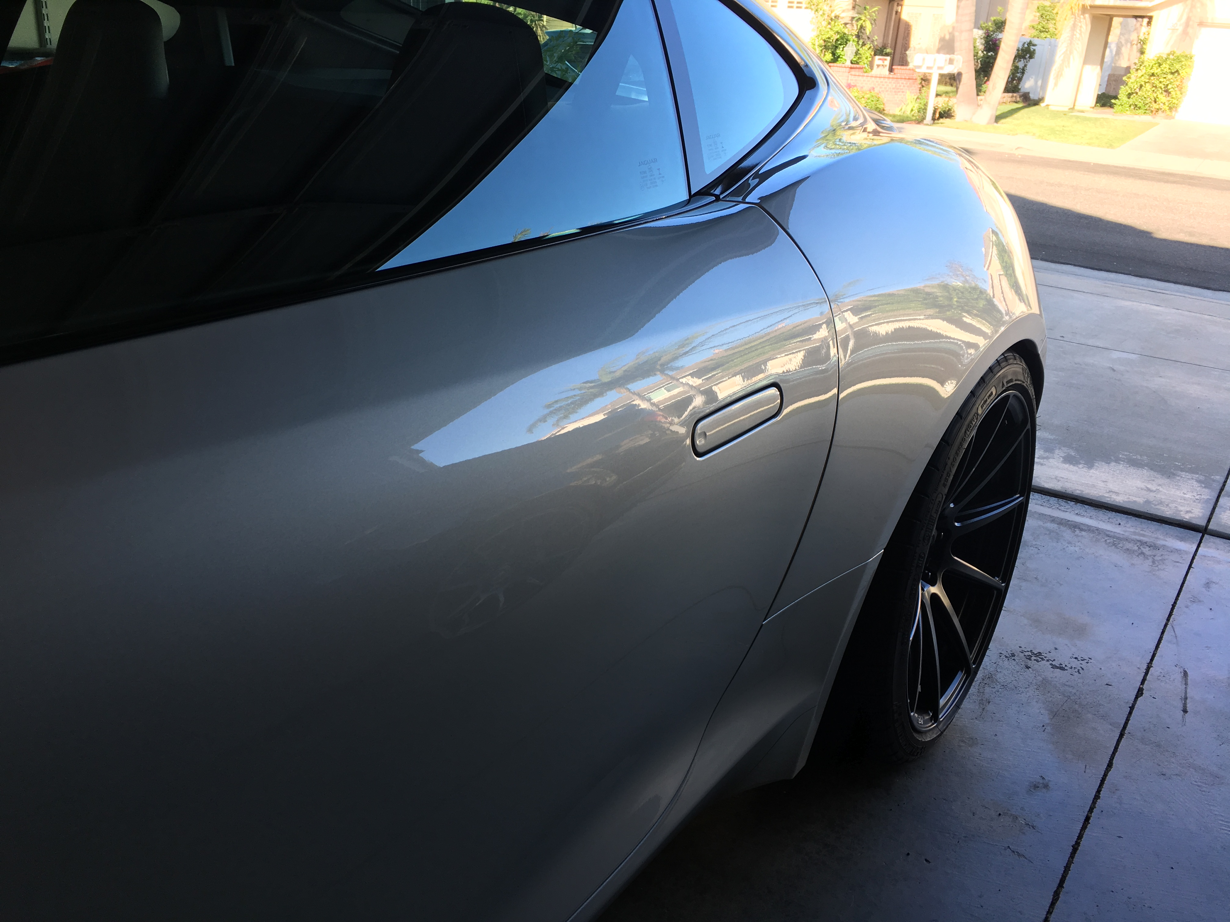

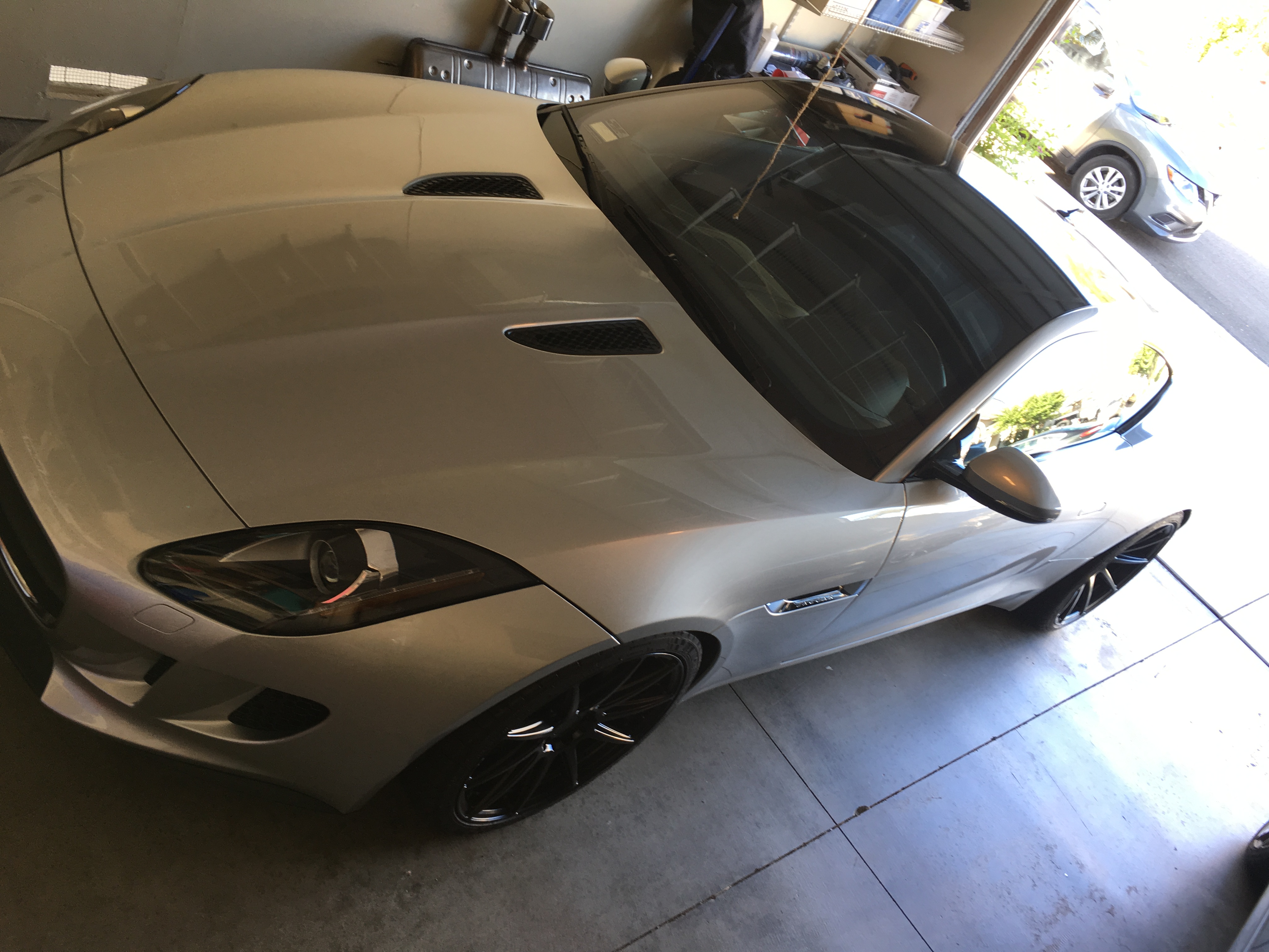

New wheels and tires installed
We ran into an issue with the other wheels due to stud clearance so I went a different direction. I've seen this Aston at a local car meet a few times now running this setup and it really sold me for a temporary solution:
Matte Black Niche Essen M147's 20x9 +38 front and 20x10.5 +35 (with a 17mm adapter in the rear making it +18) with Michelin Pilot Super Sports in 255/35R20 front and 295/30R20 rear. After seeing the Project 8 at Cars and Coffee Saturday, they seem to run a similar style wheel and tire combo. Wish I could be running 19's but it will work for now:
