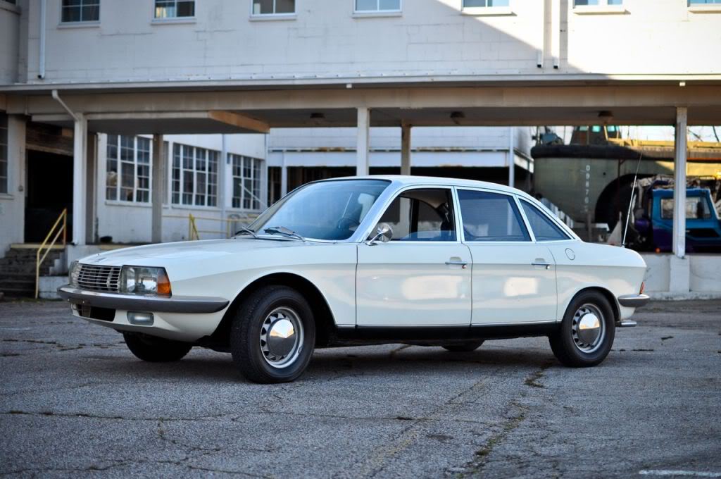

Another Rare NSU Ro-80 - A Birotor sedan

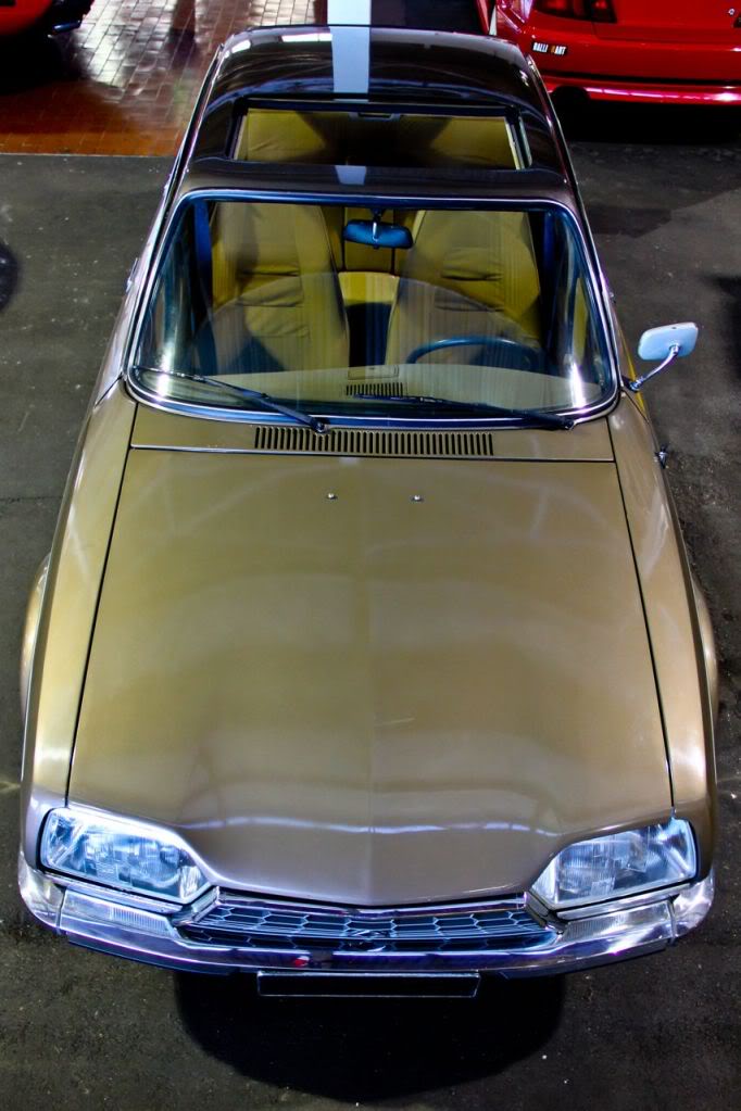

Citroen GS Birotor - I knew about the NSU, but did not know about this Citroen vehicle.

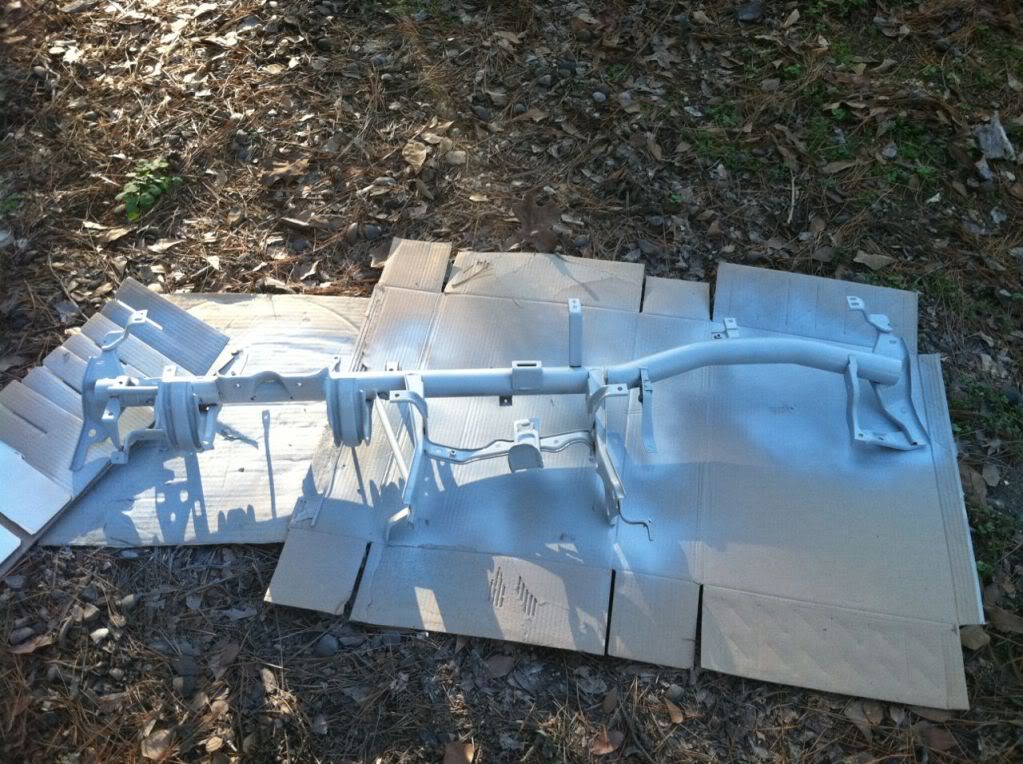

Anyhow, the little time I had, I stripped out the dash and refinished the rusty metal dash frame.
I sanded it down to bare metal, treated with rust inhibitor, and primed it.
I then sprayed with gloss black then quick shot of gunmetal and clear the whole thing.. Shouldn't rust again

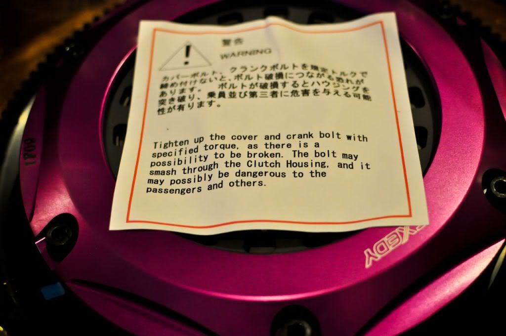

January 5th, 2012 - My clutch for the 20B came in today from my favorite clutch company, EXEDY CLUTCH!! Here are few pics
