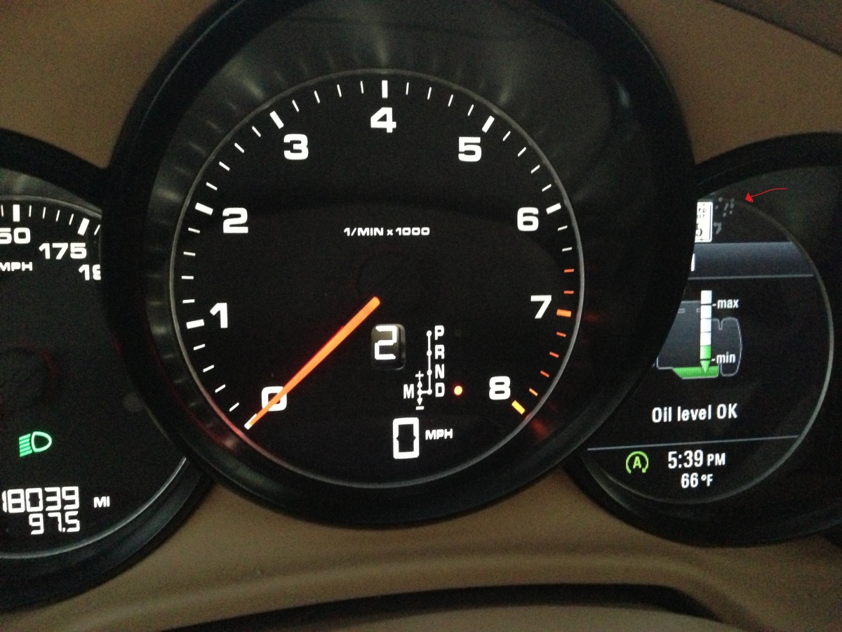

I drove the car 7k need oil change in 3k now the level on min

The oil level shown on the gauge between min and max represents approximately half a quart. Your car holds approximately eight quarts. I have had to put 1/4 to 1/2 quart in mine one time about two weeks before a regular service, and that is it ... in 33,000 miles.

i thought the 4 bars on the oil level gauge represent 1 quart total, approximately. whenever mine is at minimum with warning, i add a quart 0W-40, and it's full.

My experience was different. I don't know why. The "low oil light" came on and I called the dealer service manager (who is really great) and he said add oil in half quart increments until full. I added 1/2 quart and it all four bars were green so I stopped. That was about two weeks before my regular service, and the only time I have had to add oil.

You are correct. The difference between the MIN and MAX mark is 1 liter which is 1.05 quarts. Each of of those 4 segments represent 0.25 liters.
This is from the online Panamera manual:
http://www.porscheownersmanuals.com/...nction-display
