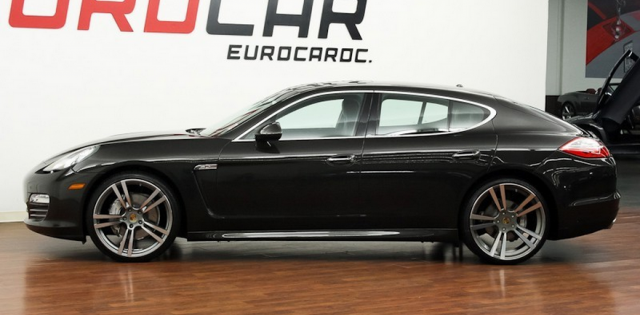

I'm still debating 22s on my P4... is there anyway you can take a straight on side view shot of the car? Thanks in advance.

Took this baby for a test drive and couldn't tell that it was riding on 22"s. Of course, you gotta watch out for potholes....
