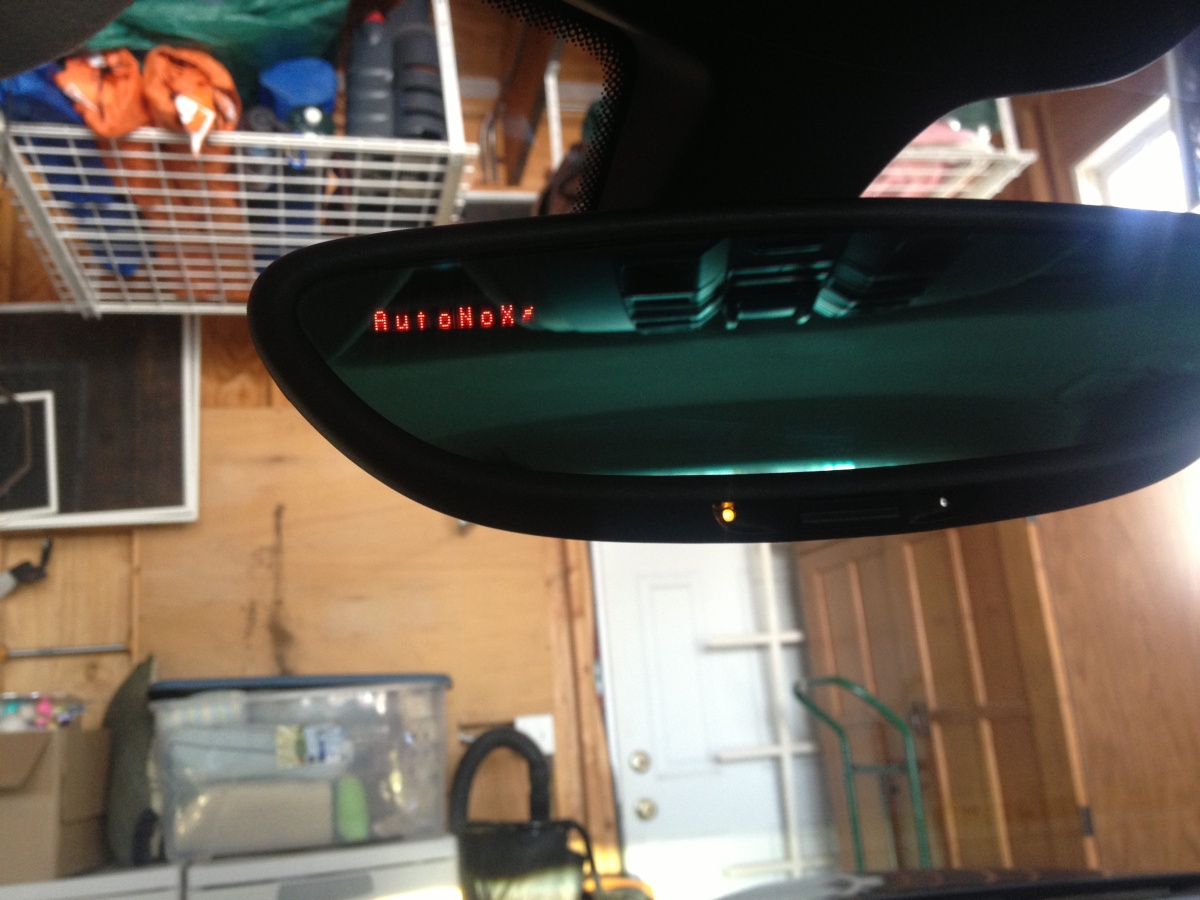

Sorry, I can't answer your question directly, but my dealer said popping the mirror on and off is pretty easy. I did not see how they did it, so cannot help there. I did see a plug in wiring that allows you to take of the mirror and install a replacement mirror, so if you can get the mirror off, (i think) you can test the voltage without cutting the wires.
I instead chose to have my display inside my mirror.
Good luck.

Just so you know, Radar-Mirror gave me a new OEM Panamera mirror. They only modified the glass coating to allow the display to be seen through the glass. I basically bought the display mirror, the dealer installed it and gave me the original mirror. I sent back the original mirror and got my deposit back. My dimming works perfectly and i am happy with my display.
I was a bit nervous about the whole thing because I never dealt with radar-mirror before, but my experience was a very good one.
My guess is that the cover does pop off like you describe. You might also swing by the dealer and have your sales rep confirm this with the service department for you.
