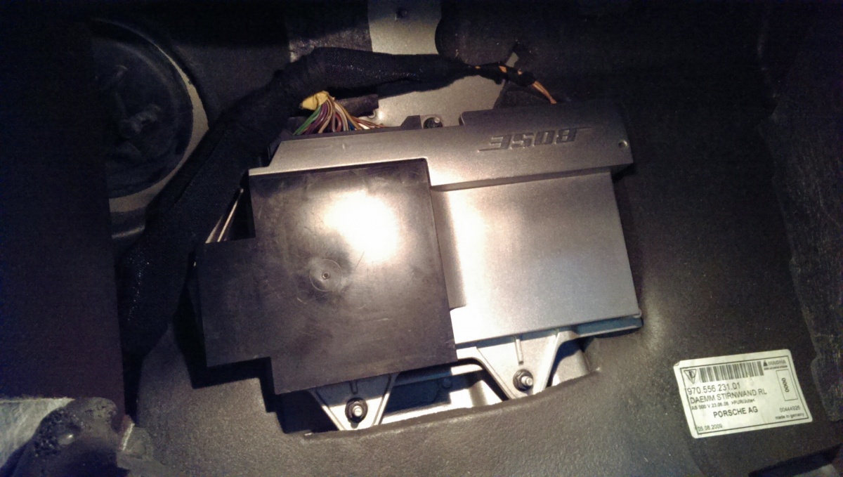

In case anyone else fancies doing this job it's super easy... I got a "nearly new" Panamera / Cayenne / 911 (they're all the same) Bose amplifier off ebay for $350, it came in a few days and I've just installed it... Works perfectly.
Remove the amplifier fuse (in the trunk), lift the passenger carpet (this is the trickiest part as it's stiff and backed with sound deadening material), remove the kick plate, remove the amplifier (carefully remove connectors), install replacement amplifier being careful with connectors (test at this point), place back onto mounts and tighten down, replace kick plate and push the carpet back carefully. Replace fuse if not already replaced.
Works fine. (photo below before I replaced the kick plate and carpet)
