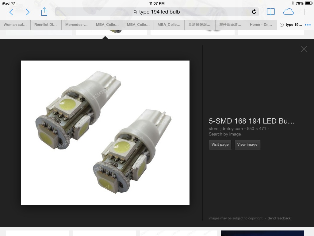

Tged, can you tell me what parts you used and where you bought them? Any noticeable difference? Happy?

The LED bulbs I used are very common that you can buy from many auto gadget stores. I will try to take a photo of the LED bulbs, I think I used only one kind.
