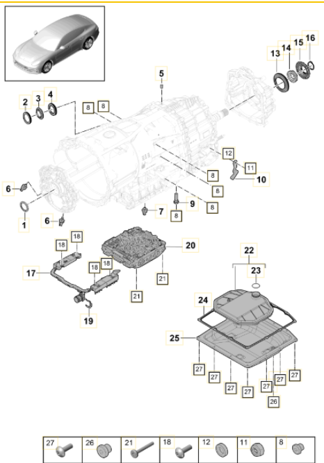

what is cpps sensor?
Do you see it on this picture?
