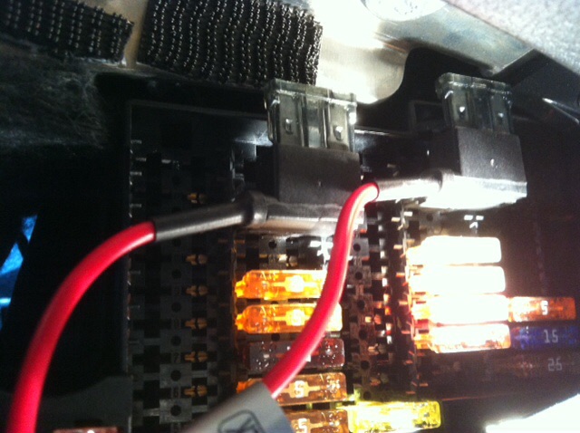

I used something called Add-A-Circuit to tap on the fuse, very simple, just 'plug-and-play'.

The fuses I tapped onto were empty slots. One is for vehicle tracking which is always hot and we do not have this option in Canada. The other, as I remember, is for seat ventilation which my car does not have. You can certainly use others. The owner's manual has a list of the fuse allocation. You need one fuse slot that is always hot to power the clock and one that is controlled by the ignition to power the LED backlighting.

1. I found the ADD A CIRCUIT. Amazon.com - PICO 0956PT 10 amp mini blade fuse Add-a-circuit. On the manual it says
Fuse 24 Seat ventilation, front seats 7.5 Amps
Fuse 44 Vehicle tracking System VTS 5 Amps
So can use the 10 Amp add a circuit above? Or do i need to match the fuse Amperage to the circuit?

1. Both fuses 24 & 44 should be empty unless you car has seat ventilation. The clock and the backlight draw very little current, and the clock instructions suggest using an 1 Amp fuse for each circuit, therefore you definitely will not overload either fuse slot. Make sure the add-a-circuit you order accepts ATO fuse, that is the same kind used in the car.
