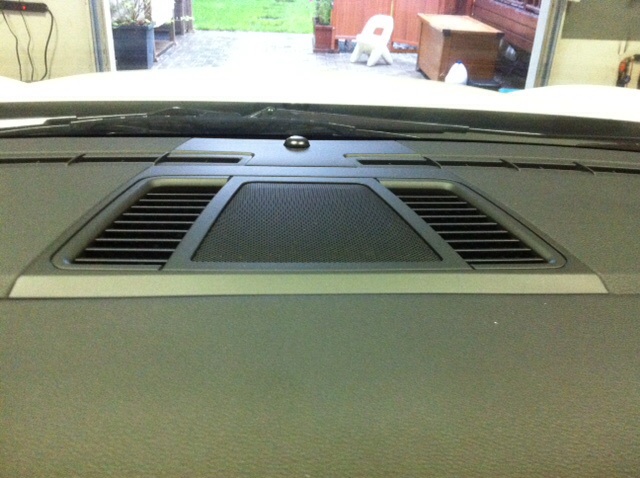

I cannot attach multiple photos from my iPad, so I will post one photo each time.
This is BEFORE.

Oops, this is BEFORE.
