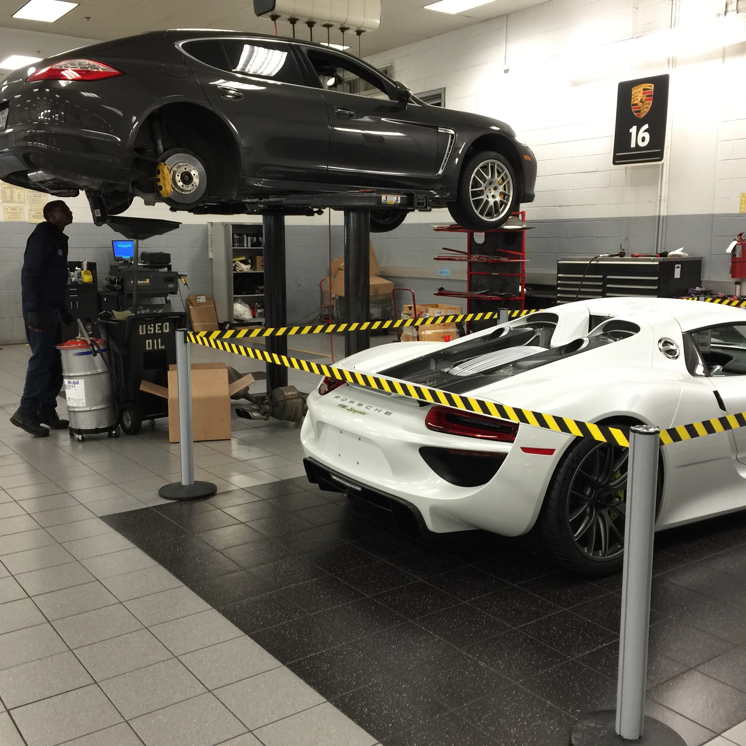

Dropped by the dealer to pick up a lender (didn't need it until now) and visited the PTT in the service bay. As you can see, it's in good company.
Chatted with the tech (in the pic) for a few minutes as he slowly pumped new oil into the replacement diff already in the car. He showed me the old one, in the shipping crate, which looked dusty but intact and dry. He said the sound I was hearing was the pinion and related bearings starting to wear to the point of audible noise and it was only going to get worse. I asked what leads to such a heavy-duty part getting to this stage and all he could offer was a bad unit initially or abuse, which hard starts (launch control) are an example of.
He then took me up front and said, power train abuse evidence starts here (points at crankshaft/tranny junction) and makes it's way down there (points at the rear diff). Uh, yeah, well we're here because the diff is trashed and you've spotted a main seal leak. So, I guess I have my answer.
Luckily CPO coverage should take care of all this. The SA told me, after I floated the theory that we're looking at a car that's been abused and showing the signs of it, that the PO, who he knows well, "doesn't seem like that kind of guy".
BTW- the underneath of a PTT with it's AWD systems and sport exhaust and other systems is a staggering maze of pipes, linkages and joints. It's an amazing piece of technology. To get to the diff they had to pull the exhaust & disassemble the entire rear wheel linkages including braking system.
Outlook is another 1-2 weeks on the rack as they pull (excavate? unearth?) the tranny to go looking for the oil leak that should only be a main seal, but could honestly be anything. Then, some time on the sunroof for why it goes 'crunch' when opened.
For those curious, that's a new 918 Spyder in the pic that was being prepped for delivery. The white color is a build-to-order white, adding just a little more to the $990,000 price tag.
Wonder if they can get into the engine ECU and tell you how many times the car has been launched, or otherwise redlined. Might give you a clue. They say that PDK itself is designed for 3000 launches. Not sure about PDCC or the rear diff though.
