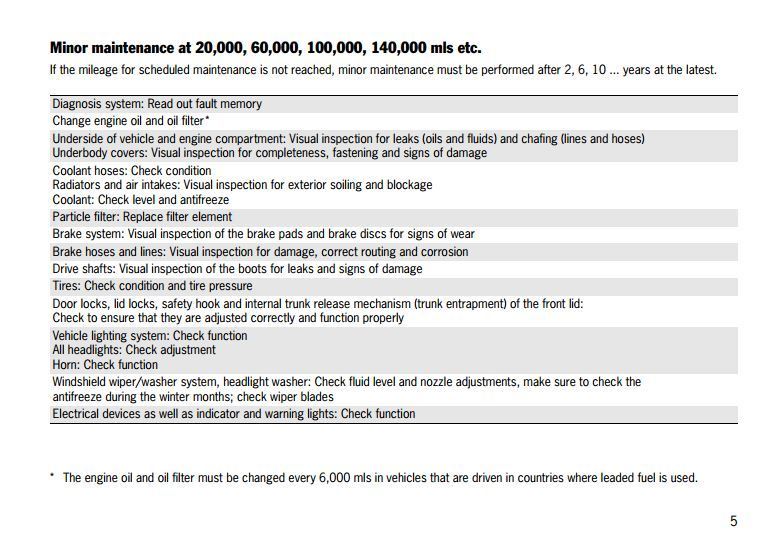

Per the Porsche Factory Maintenance Manual on the 20K (Minor) Service for your Panamera:
As far as the audio upgrade and the corresponding PCM update - that's something that Porsche has specific codes for programming, and unfortunately does not release them to the public. It would have to be something performed at the dealership!
