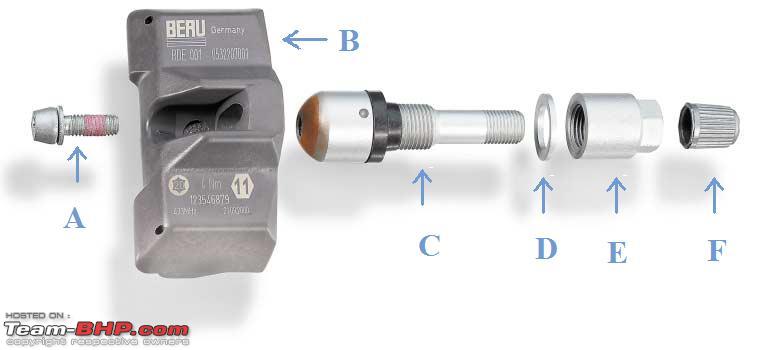

Yeah, that's way, way too high. The dealer is lying to you - switching TPMS from one wheel to another is in fact trivial. At the very most you might need new valve stems, and the official Porsche valve stems are $25 each from Suncoast.
Here's what the sensor looks like:
It's not complicated. The sensor electronics are in the wing-shaped bit (B), which sits inside the pressurized tire. The valve (C-F) protrudes through a hole in the wheel, and that's what you see from the outside.
Switching existing sensors is just a matter of unscrewing the nut (E) from the valve stem, popping the assembly out, putting the stem and sensor into the hole in the new wheel, and screwing it back on. Trivial. Tell the car you changed tires via PCM, and you're done.
Any tire shop, any tire shop at all can do this if they have the parts. When I bought my winter wheel set, I purchased TPMS sensors and valve stems from Suncoast and brought the sensors and the wheels to NTB. Since they're exactly like valve stems they deal with every day, they had no difficulty.
EDIT: It occurs to me that they may be quoting you the price to switch tires vs. switch wheels. Taking tires off rims is more work than switching wheels with existing mounted tires. However, $400 is far too much for switching tires, I paid $110 to do that at NTB, and $75 is also high just to switch wheels with mounted tires.
