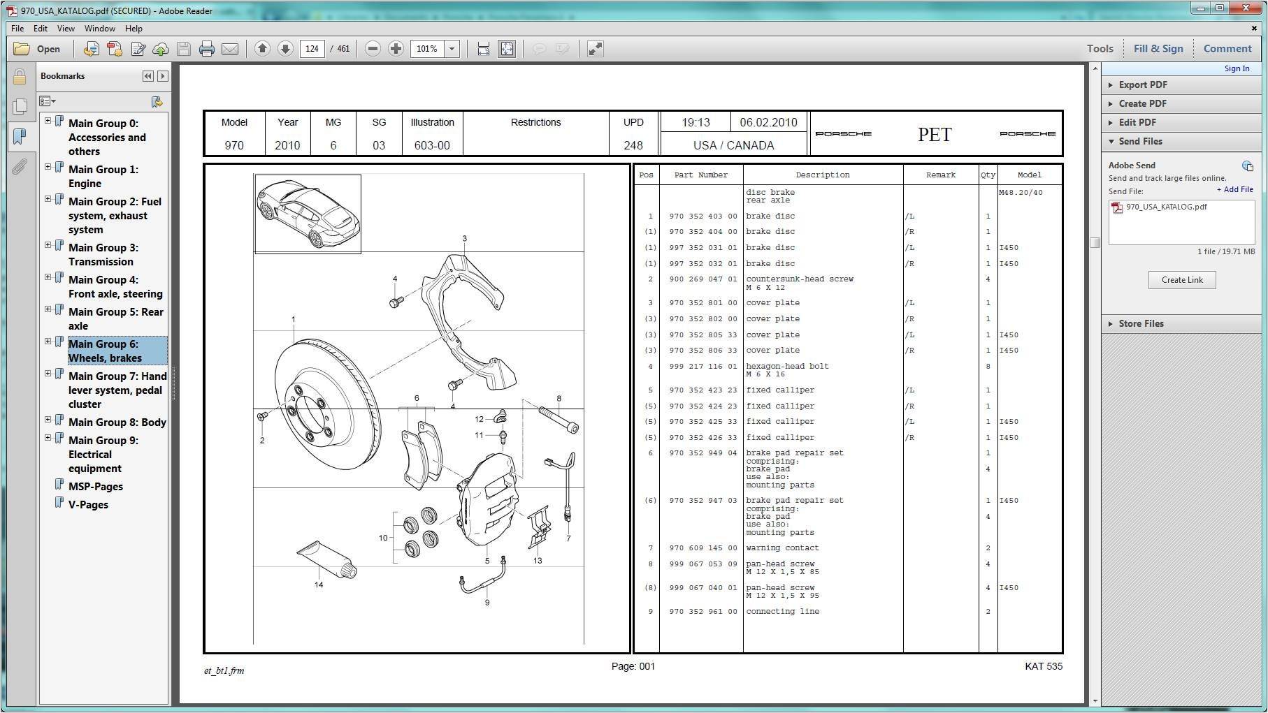

Old May 12, 2015 | 08:09 AM
Yankee's Avatar
Joined: Jan 2012
Posts: 63
From: Long Island, NY
Yankee is infamous around these parts
Originally Posted by sayadil
no I'm asking about the anti rattle springs. i got a written estimate from the dealer which mentioned these 2 sets of springs back and front costing approx 210$ in us and about 300 here. do i need to change them or is it safe to use existing Springs
No idea what anti rattle spring they are referring to. Nothing I see is part of the brake/rotor assembly. Maybe they are referring to #13. That doesn't need to be replaced every time pads change. Unless it is rusted badly.
Old May 12, 2015 | 08:50 AM
sayadil's Avatar
Joined: Feb 2015
Posts: 75
From: New Delhi
Rep Power: 15
sayadil is infamous around these parts
Yes its part 13... Porsche OEM Part Number 97035295900 and 970351295901. My dealer and pelican parts both feel it should change with every brake job. its around 200$ for both so i guess will change it as well.
