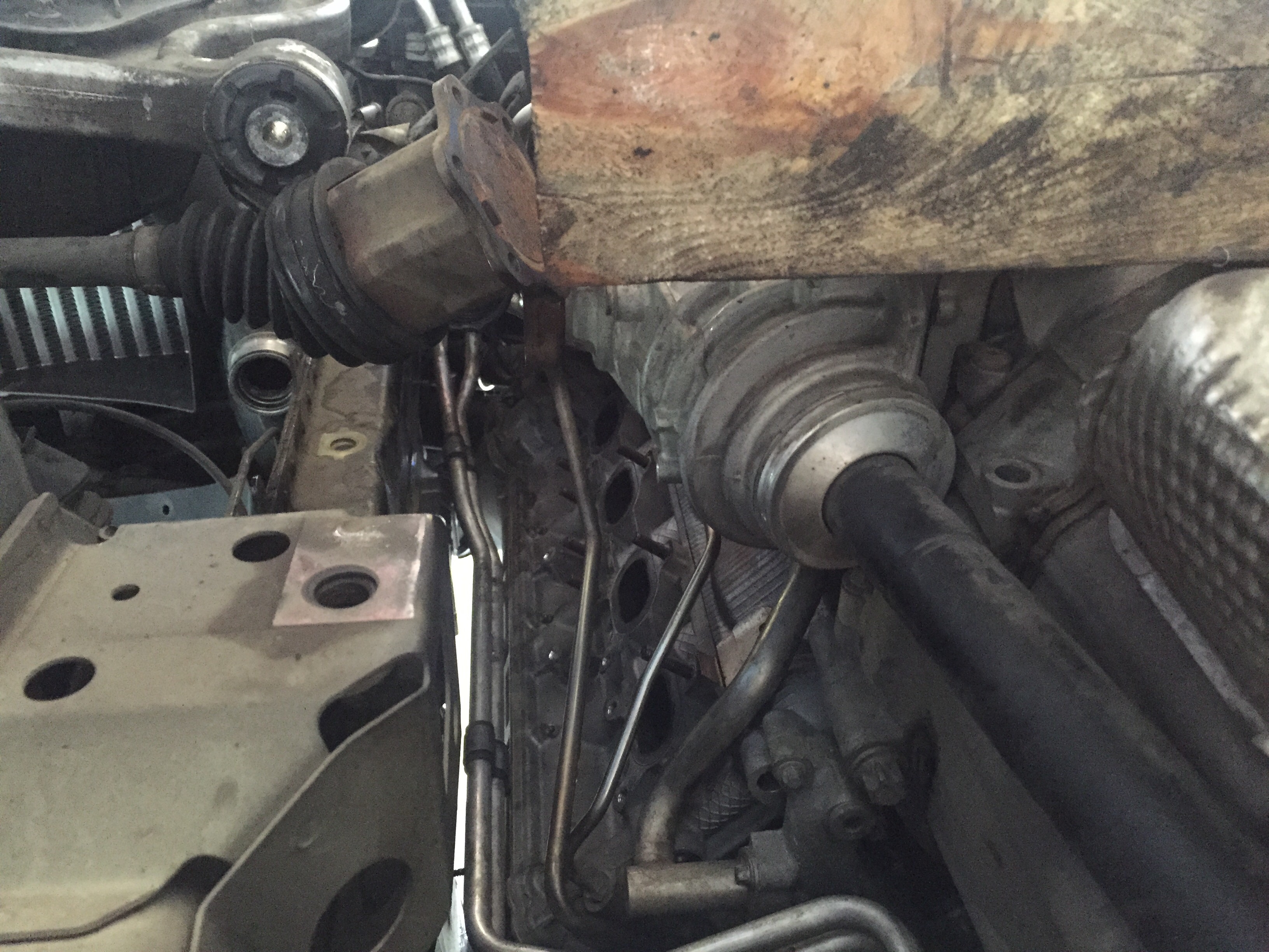

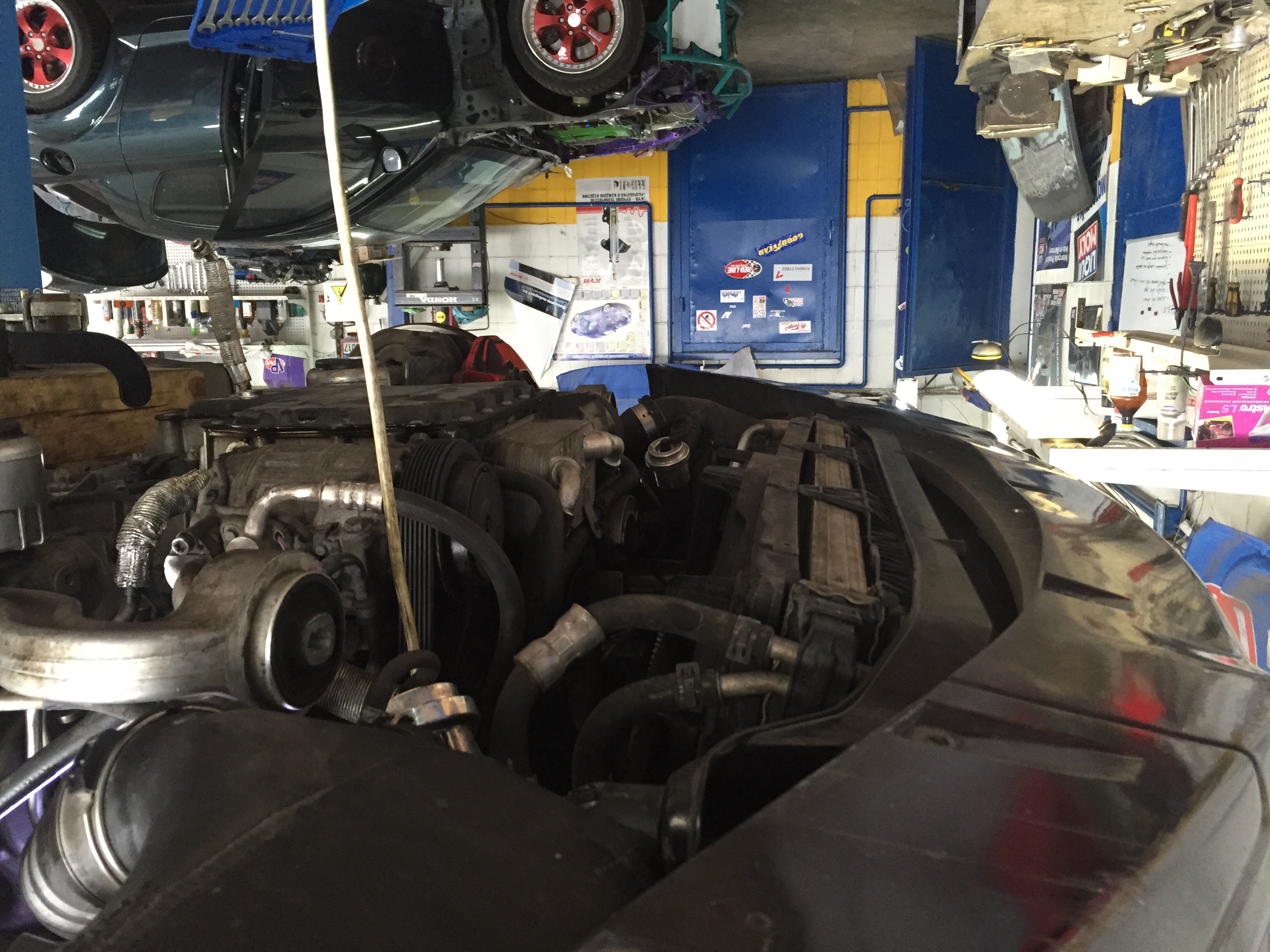

I do not understand from pictures , did you remove the engine ?

No, we did not remove the engine. We lowered it to 10-15 cm and thus, excellent access to the turbines

The same problem with upside down photo ;(((
But, if you see- that is no remove engine.

wow ! thanks , thats nice to know . Thanks for the cheat

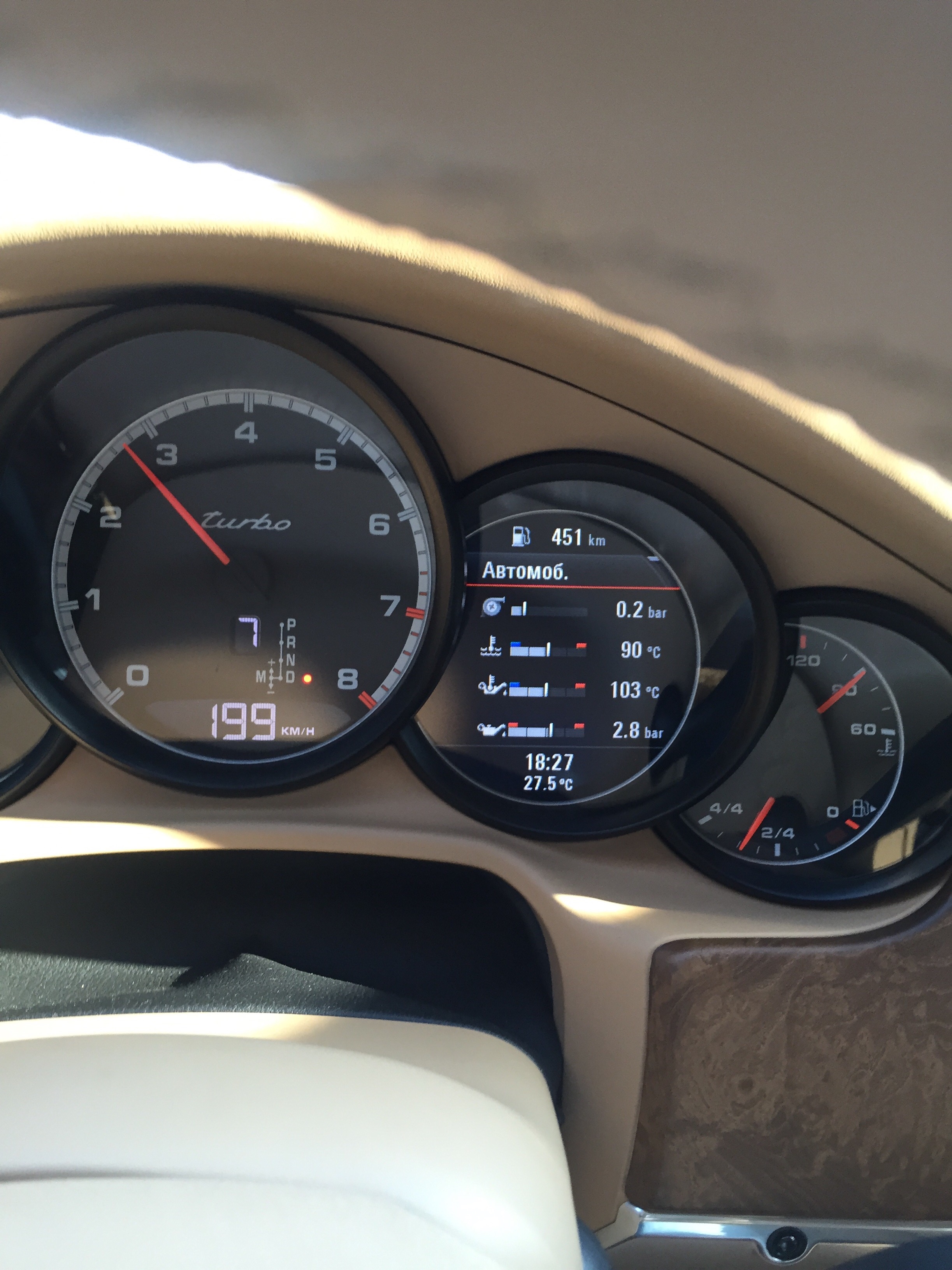

Hello everyone! Turbines installed , all fluids are replaced , the firmware is written in a test mode , the pressure is 1.0 bar , the power 725-730hp
Go from Kiev to Odessa, this is 470km- everything is fine , no problems noted , all works.
turbos swell(spull) earlier and stronger enjoy, thrust moment about 1000nm now...

I was wrong when said that it would be 730ph on the 1.2 bar pressure , the flow rate of air , we saw that this power is already on a lower pressure ; )
Right now 2050kg/h / 3,6 x 1,275= 727hp
