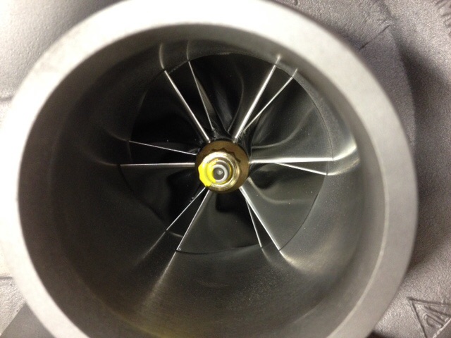

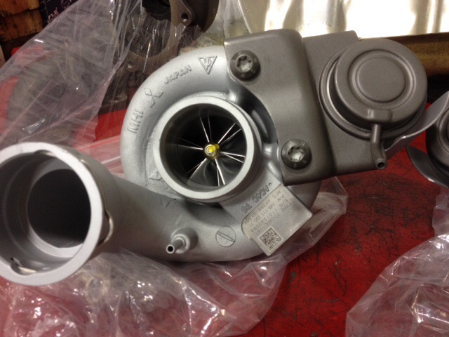

It's using 68HTA Billet compressor wheels.

Turbos are done and should be installed tomorrow! Hope to have it back in the next couple of days, I am getting very excited to hear it and see the power gains!
Old Aug 10, 2015 | 08:06 PM
Superaudiofreak's Avatar
Joined: Oct 2013
Posts: 63
From: Dallas, Texas
Rep Power: 15
Superaudiofreak is infamous around these parts
Close up
