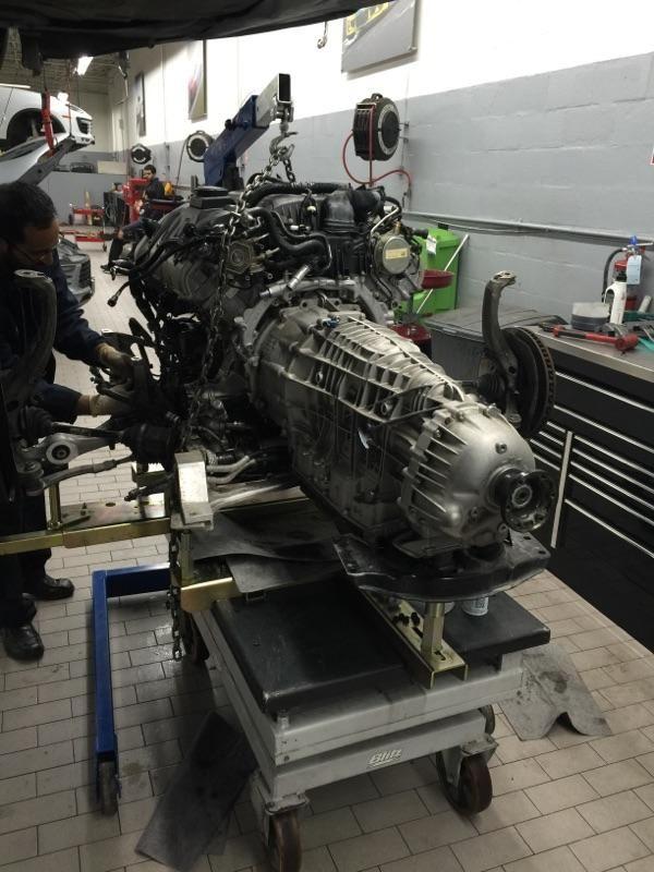

Had some squeaking coming from the front passenger side suspension. Thought maybe an issue with air suspension or bushing. Ended up being bad bushings. Dealer replaced upper and lower control arms and tie rods on both sides. Then noticed a wobble at normal driving speeds and serious wobble under heavy acceleration. They ended up tracing the source of the wobble to the front diff. They were actually able to unplug a wire from a harness, de-activating the front diff, temporarily making my car RWD. Wobble disappeared so they ended up replacing the front differential and some other items they discovered in the process. Thankfully it's CPO and all being covered under warranty!!!

Went to check on the car today and front differential has been replaced successfully.....however the wobble was still present during the road test. They are now thinking the transmission may be the problem. Porsche NA Rep being contacted and I'm wondering what next? Maybe a new transmission? Crazy. I miss the turbo power

Got my car back today, finally, and everything seems fine. Service tech notes below for details of the entire ordeal.

So shortly talking all problem was in part no.10 ?
http://www.oemautopartsandaccessorie...32faa5e9bd251/
because of loose part no.11 ?
Front differential and bearing assemblies were changed for nothing ?

Yeah. All that needed to be changed was the axle piece. Over a month of digging and no one bothered to look at the axle.
Can't see what fluid was filled into rear diff .... ?
